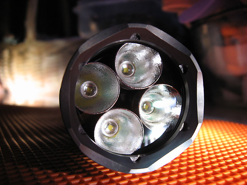

The quad-emitter build was for ExZeRoEx with 4x CreeXRE-R2WC emitters in McR16xr reflectors, running with multiple brightness capabilities by virtue of my Acorn 1.0 driver running 'Califon' firmware. The firmware supports miser capability as well as memory, tactical, and theater user interfaces... both 2x rechargeables and 3x primaries are acceptable power sources. The host head is an M3 with shallow scallops. Max output is deliberately held back somewhat, topping out around 660 lumens and running correspondingly more efficient, with good runtime and relatively low heat... for this reason it is fully Project-M "M" compliant: M660.4-M3.
http://milkyspit.com/i/img-m660.4-ex...reflectors.jpg
