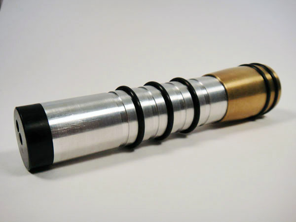

Well I wanted to try something basic so I went with a single 18650, MC-E, aspheric, and direct drive. I also wanted to charge without having to remove the batteries so I came up with (I think) a cool charging stand.

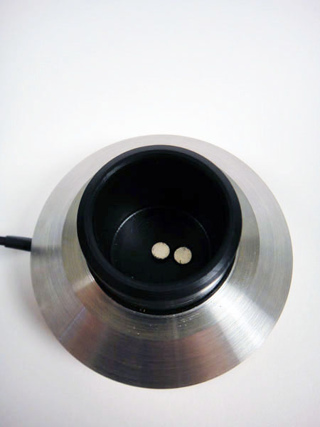

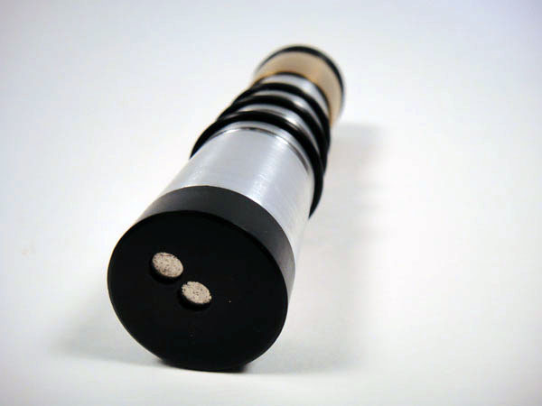

And the inside of the base. These are two neodymium magnets that float up and down. They, of course, mate with magnets on the tail of the light, which are fixed in place.
The center post is negative and the outside post is positive. I needed to put one (or the other) directly in the center so I didn't get the polarity crossed. I just stick it in the stand and rotate till the outside magnet clicks into place. It's audible and tactile.
And before anyone gets excited, a beam shot! Now this is a weird aspheric that has a curve on both sides. It actually produces a wide beam, so it's not a thrower...at least to the extent that I have it defocused. Not what I expected but I actually like the combination of wide beam and aspheric pattern. It's awesome for short distances.
The artifacts look a little worse in the photo than in person, but on a mixed background they are even harder to notice. I suppose an SST50 would solve this...and I could match that with my new 3 mode (.120/1.4/2.8 amp) driver from shining beam. Stay tuned and watch me burn my fingers on that build.
