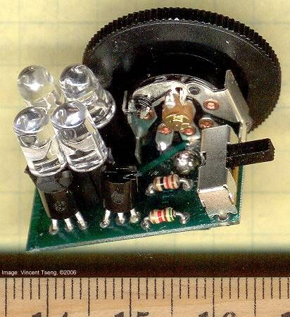

    Head and LEDs/board -
    The LEDs are well recessed in the body behind the square plastic window - this is good detailed design to avoid extraenous light - to least disturb others - remeber this was orignally designed for astronomers who need to preserve their Scotopic human Night Vision. However there is some light leakage through the gaps in the non-sealed parts of the flashlight (I would imagine the full sized waterproof version probably does not have this problem.)
    The light levels are controlled by a thumbwheel - which turns the light on and goes from dimmest to brightest. There is a selection switch next to the thumbwheel that changes between Red and White LEDs.

    These are interesting lights, and have been around longer than most of the other LED flashlights. That circuit with the two transistors and two resistors may be a constant current regulator that allows adjustment with the variable resistor. If that's the case, the battery life should be phenomenal given that you can maintain constant brightness all the way down to around 5 volts on the battery. What's interesting about this circuit vs. those used with some of the other 9V LED lights is that you truly only use the current you have dialed in. There is very little energy loss to heat through the resistor.
    Default Re: Rigel SkyLite Mini Red/White - continuously variable brightness
    Kram wrote: "That circuit with the two transistors and two resistors may be a constant current regulator that allows adjustment with the variable resistor. If that's the case, the battery life should be phenomenal given that you can maintain constant brightness all the way down to around 5 volts on the battery. What's interesting about this circuit vs. those used with some of the other 9V LED lights is that you truly only use the current you have dialed in. There is very little energy loss to heat through the resistor."
    Thank you so much for that very informative input.
    On Rigel System's Page on these lights they claim:
    "Energy Efficient -- Up to 320+ hours at the dimmest setting, 12+ hours at the brightest, from one 9V Alkaline."
    Jan 2003
    Texas
    86
    Craig's LED Museum review (http://ledmuseum.candlepower.us/fourth/skylite.htm) confirms my speculation almost word for word (I promise I didn't see his review before my posting). He says that the manufacturer provided the following input:
    "The transistors + resistors are a current regulation circuit, as battery ages & voltage drops, keeps current through LEDs the same (more or less). Will regulate whites from 9-7 volts, reds all the way down to 5 volts or so."
