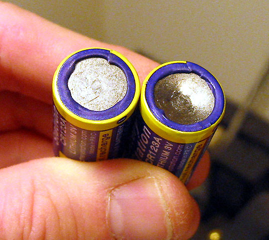

    Default Re: ROAR of the Pelican (CR123 Explosion during use, underwear change required)
    Quote Originally Posted by FlashlightOCD
    "Batteries may explode, pyrolize or vent if disassembled, crushed, recharged or exposed to high temperatures."
    Quoted from: http://www.duracell.com/oem/safety/pdf/2003_5C.pdf
    Just how powerfull is that spring on the PM6?
    Here's a quick photo I snapped of two BS 123 cells, one with normal bottom and the other with a crunched bottom. Note that the crunched cell did NOT come out of the PM6, but rather from a single cell twisty light that apparently was overtightened. The PM6 spring, if memory serves, would cause this much or more crushing.
    The specific model PM6 I'm talking about as "stiff-springed" is the hard anodized LED version of this light. I'm not sure if every PM6 has that same spring or not.
    --Scott
    David, I'm pretty sure no one is going to use the lights that have had this happen in them!
    But are you suggesting everyone stop using their Pelican M6's? If that's the case we better alert every PD and FD in the country, because they are HUGE consumers of Pelican M6's.
    I would think that anyone who owns an M6 should closely examine cells for any depression of the end caps and if there isn't any, be cautiously optimistic that yours is fine.
    But that still begs 2 questions:
    1) Can deformity cause this kind of reaction?
    2) Can damage to the safety mechanisms be caused by that deformity or other outside mechanical stresses under normal or abnormal stress?
    Bill
