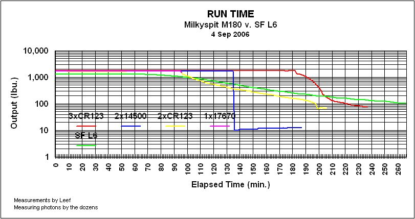

    Project-M Runtime Chart
    M180-KL2 Runtimes by Leef
    Fellow CPFer Leef took the time to chart runtime of his M180-KL2 head and the better of his two SureFire L6 flashlights. Both flashlights were running 3x123 fresh SureFire 123 cells. The charts show overall output of both lights and seem to approximate actual lumen output of the lights (divide his readings by ten). Note: according to Leef, the SureFire L6 in the test is an unusually good one.
    Overall Output vs. Runtime, M180-KL2 with Various Battery Options (Linear Scale)
    Overall Output vs. Runtime, M180-KL2 vs. SF-L6 (Linear Scale)
    Overall Output vs. Runtime, M180-KL2 vs. SF-L6 (Logarithmic Scale)
    The logarithmic scale approximates the brightness differences that the human eye actually sees.
    Leef states that at the 240 minute mark, both test subjects were still generating useful amounts of light.

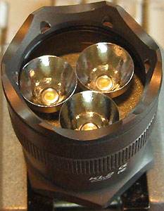

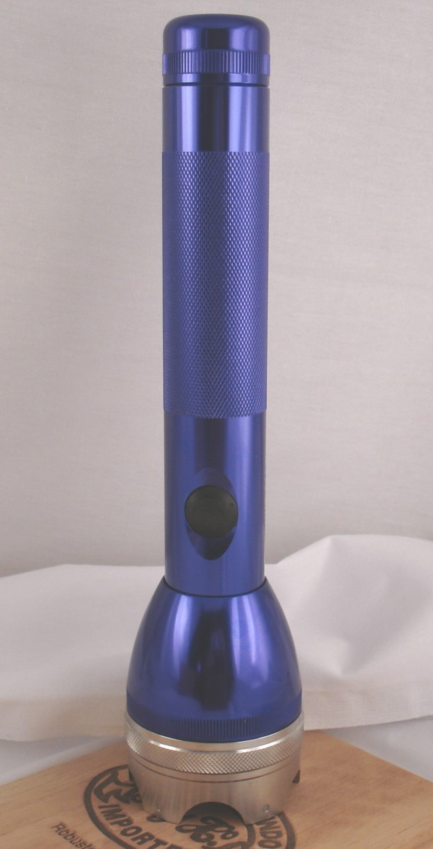

    Photos: M180 in Mag 2C Host
    Incorporates Kiu Stainless Steel Bezel (normally not included)
    Compliments of MSaxatilus

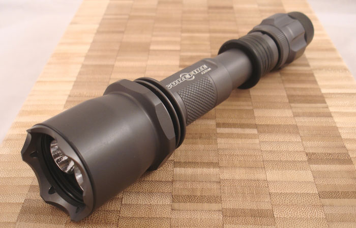

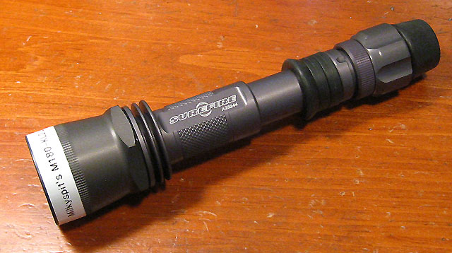

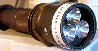

    Photos: M180 in SureFire KL2 Host
    Note: This is a very limited edition! The KL2 head has been long discontinued by SureFire, and as such is in short supply. However, if you've got one... this is what it could become!

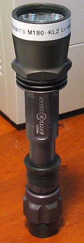

    On standard M3 body
    On M3 body with SW02 tailswitch
    SW02 tailswitch allows the light to stand upright

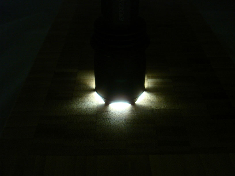

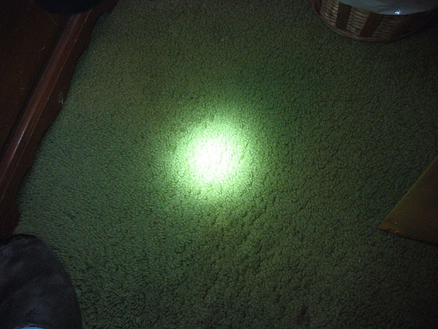

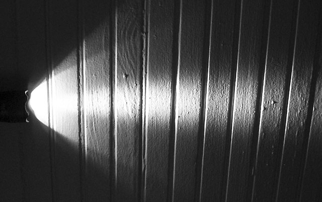

    Beam Profile
    Posterized... note that the oval shape is result of the light being held at an angle... the beam is perfectly round in reality!
    Carpet

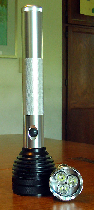

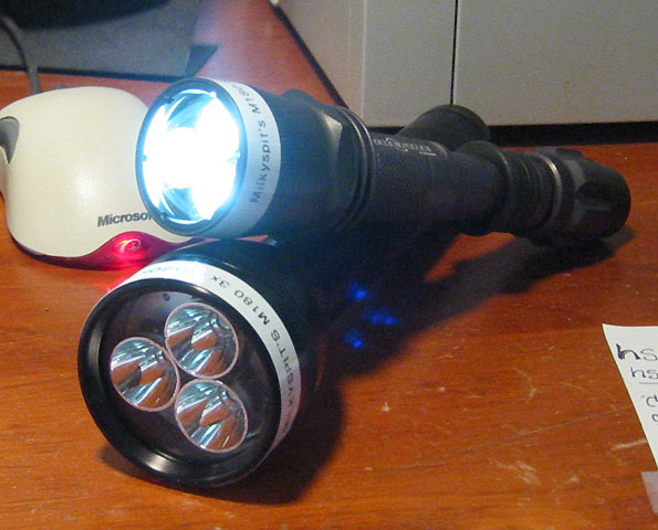

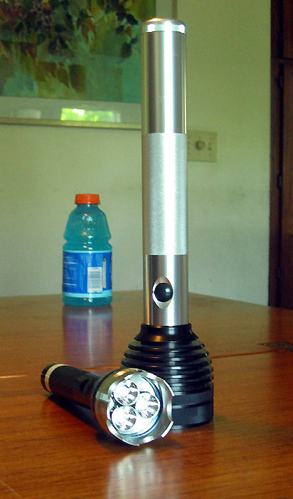

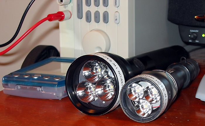

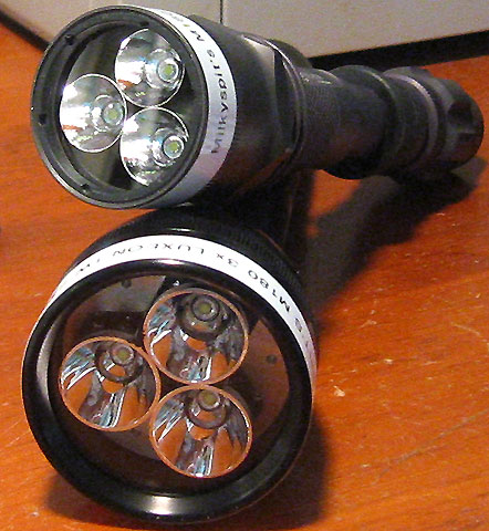

    M180-Mag2C vs. M180-KL2

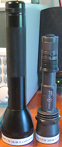

    Mag 2C vs. M3 body
    Mag 2C vs. M3 with SW02 tailswitch
    Bezel ends

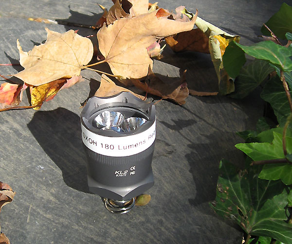

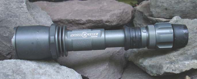

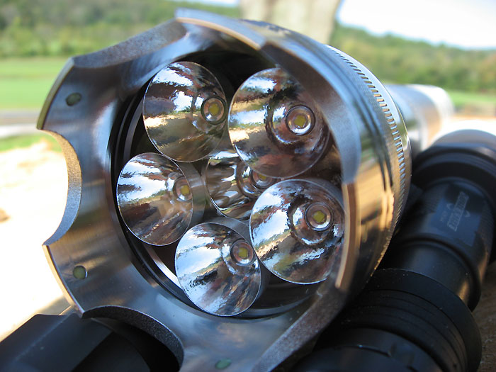

    Photos: M180 in SureFire KL2 Crenelated Host
    SureFire customer service has assured me there is no such animal as a KL2 head with an M3-style, hard anodized crenelated bezel... then milkyspit somehow managed to receive TWO still in their unopened SureFire factory boxes. I don't know what to make of this! But it is pretty!! This is the way all KL2 heads should be. Photos courtesy of milkyspit.

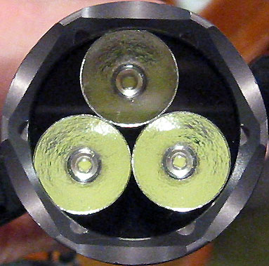

    The elusive crenelated KL2, sighted in the Milky Labs!
    M180-KL2 crenelated business end. Note the ultra clear stock glass, barely visible in the photo.
    KL2 crenelated head profile

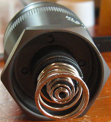

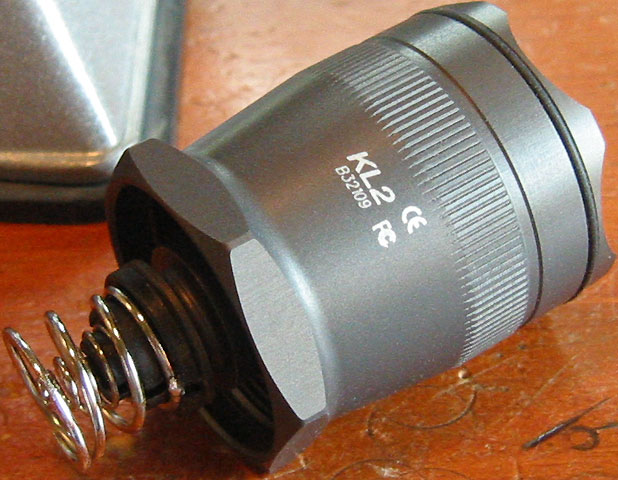

    Underside showing the typical M series contact springs

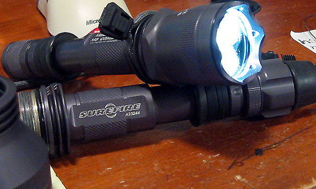

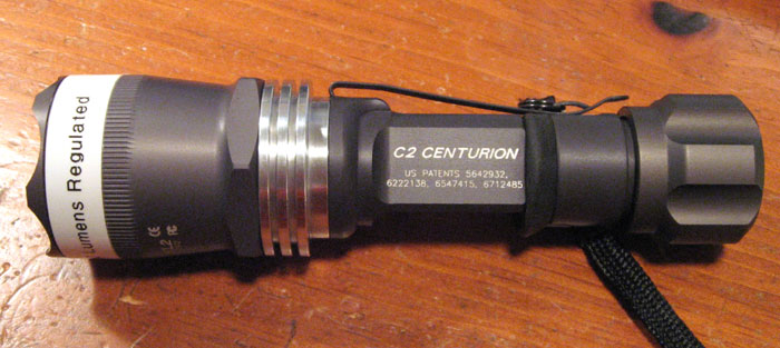

    M180-KL2 crenelated, mounted on a prototype C2M adapter and Surefire C2 body, with SW01 tailcap

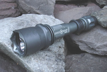

    Milky's personal M180-KL2 crenelated enjoying a fine autumn day

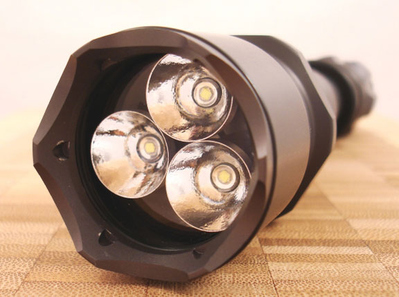

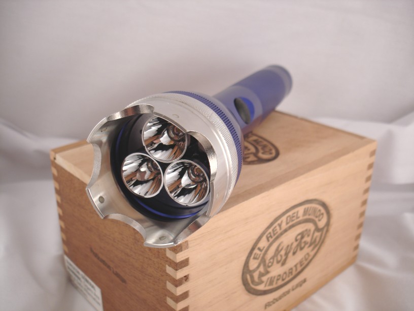

    Photos: Kiessling's M180-KL2 Crenelated Jewelbox!
    One-of-a-kind, built per specific request. The keys here are a black felt surface that sets off the reflectors like three jewels in a window, plus another of the ultra-rare crenelated bezel SureFire KL2 hosts. Photos courtesy of milkyspit.
    Scotch Tape Spool, Rocks, Leaves Not Included
    Yes, that's an M3-style crenelated hard anodized bezel on there...
    Mounted on an M3 body
    Beam profile
    Milky Labs before and after powering up the Kiessling M180-KL2-Jewelbox

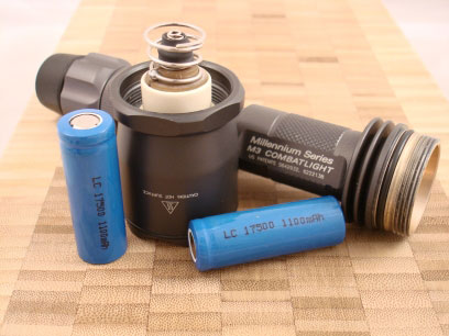

    Photos: MSaxatilus' M180-M3
    Turns out the M180 platform fits inside a SureFire M3 head as well. It's a fair amount more work to get everything just right since the head never was created to house LEDs and has no heatsinking bulkhead... plus a SureFire lamp assembly needs to be sacrificed to craft the dual-spring contact points underneath (burned-out LA works fine for this)... on the other hand, the heatsink is a solid aluminum slug a full half-inch thick!
    Photos courtesy of MSaxatilus.
    "What in the heck could it possibly be?"
    Profile
    Collage
    Outdoors

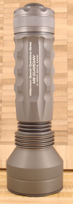

    Photos: MSaxatilus' M420-KT4 (M6 Host)

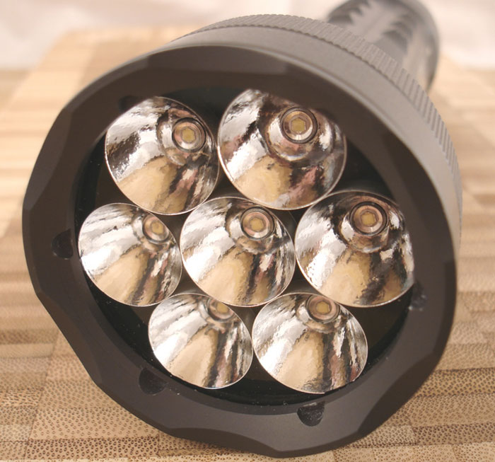

    MSaxatilus placed the first-ever order for an M6 mod! Milkyspit is turning the KT4 turbohead on that light into an M420 and building a 2x18650 cell caddy for the body. The KT4 also fits M3 and M4 bodies. On 2x18650 cells, this combination should deliver 420 lumens continuous for about 2 hours. The head even includes an inch thick block of solid aluminum! Though milkyspit tells me it's not needed.
    That's one beautiful bezel.
    Photos provided by Milkyspit.
    Profile
    Looking Into The Bezel
    Additional photos provided by MSaxatilus.

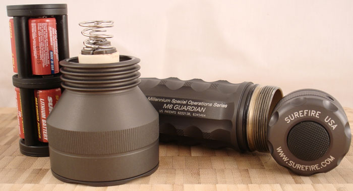

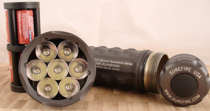

    Components with Bezel End of Head Visible
    Components with Back End of Head Visible
    Standing
    Head End Closeup

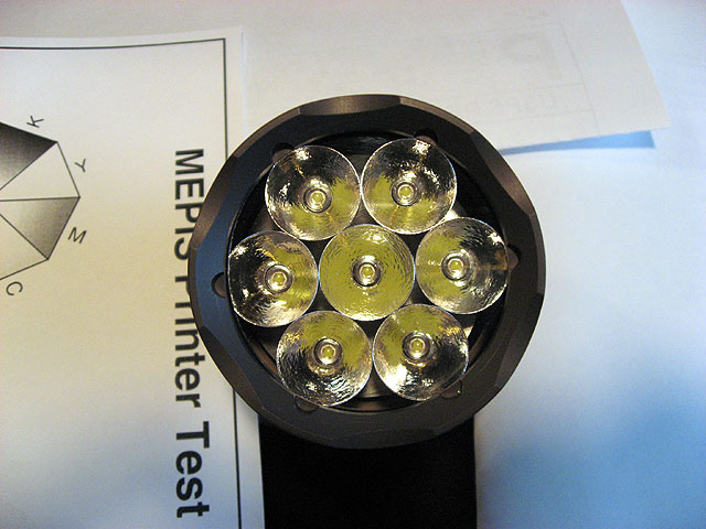

    Photos: M360 "Silver Guardian YS" Prototype
    The M360 "Silver Guardian YS" is a prototype M360 light Milkyspit has built into a Mag 3C silver host powered by 12AA NiMH rechargeables. The stainless steel Kiu crown pictured is not typically part of the build. The "YS" designation refers to the two tiered, dual heatsink design that allows for the sixth reflector to sit recessed in the center of the head, thereby allowing for more emitters sitting in a smaller diameter. (Milky says it reminds him of Yankee Stadium [=YS]... he's a Yankee fan.) The Silver Guardian YS supports five brightness levels, all digitally controlled, as well as electronic lockout, temporary burst from any brightness level, and many other features. On 12AA Sanyo 2700mAh NiMH cells, the M360 at highest output should deliver 360 lumens continuous for more than 5 hours.
    Looking Into The Head End
    Profile
    Closeup Showing the Two Tiers

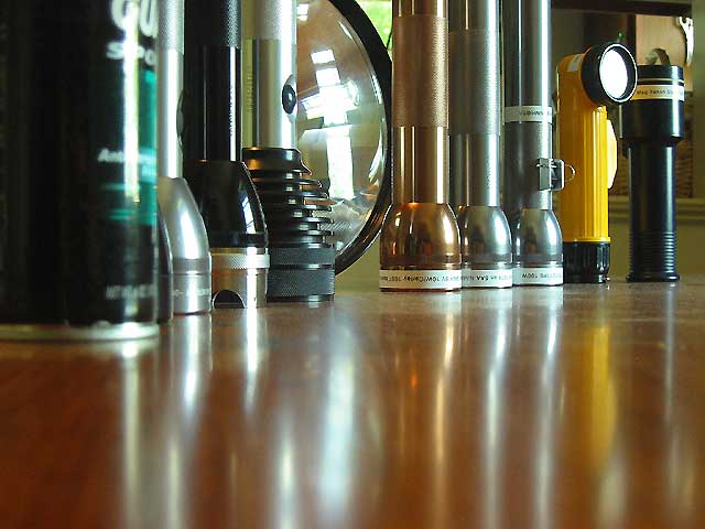

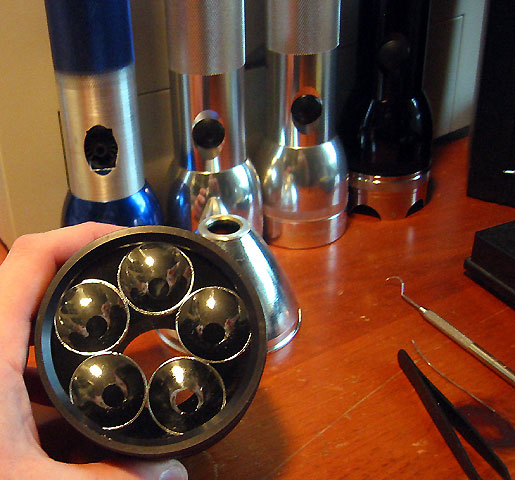

    Additional Photos
    Mag 2C with Kiu Stainless Steel Bezel vs. Mag 3D with FiveMega Head
    Bezel View vs. Mag 3D with FiveMega Head
    Same as above, different angle

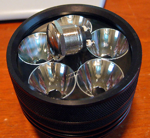

    FiveMega Head outfitted with 5x27mm smooth reflectors
    Closer look with a pushbutton switch sitting on the lens

    Added a few more battery configurations to the runtime chart... might need to refresh your browser page to see the new chart.
    --Scott

    I just finished a run-time of my M180 - which looks amazingly like milky's flat black one - running on 2x18650 LG 2400mAh. It was at full output at 5hours. I'm pretty sure i checked it at 5'15 and it was still at full output. (If i checked it, it was.) At 5'30 is was a lot dimmer than i was expecting considering it was at full output not that long before. I'll be conservative and call it a 5hour run-time, partly because that's a nice round number.
    As an aside, say i drain batteries, umm.. very low, but they recover above 3v (and climbing, albeit slowly), are they still good to go? I'll do a follow-up run-time test with them, but with the weekend starting tomorrow, it might not be any time soon. (EDIT: they charged up fine, so here's hoping...)
    The shadows are darkest during the day.
    Sep 2002
    New Jersey
    4,879
    Default Re: Project-M by Milkyspit: Long-Running High Output LED: Availability, Info, Photos
    Quote Originally Posted by Archangel
    Archie, Interesting... the runtime chart predicts 4h42m with those cells. It's good to see that the estimates in the chart do indeed seem to have some connection with reality... in fact, they may be slightly conservative!
    MANY THANKS for taking the time to do that runtime test, and to share the results with folks!
    As for your battery question... the sudden dimming is probably due to the fact that the Li-ion chemistry pretty much falls off a cliff after it drops to something like 3.2V per cell (going from memory)... that would explain the sudden dimming. With unprotected cells, you really don't want to run them AT ALL once they dim like that! Get them to a charger immediately! Otherwise you risk destroying the cells.
    Anyway, that's why I would typically suggest protected cells in these lights... they'll shut themselves down before overdischarge can occur... but as you've shown, unprotected has its merits, too... namely well over an hour of additional runtime!
    Thanks again!

    I managed another run-time sooner than i was expecting and noticed a flicker at 5'15. When i checked the output i could watch the numbers ticking down. Measuring the batteries, one was 2.8v and the other just under half that, so i may have damaged one of them the other day, though it could also be that whole "heat causes batteries to drain faster" thing. I'll see how it fares in my U-04. EDIT: I'm not sure how, but i got over 4.5hours; methinks some Barbolight graphing is in order.
    Someone'll need to test out a NiMH configuration. They don't make for a light torch, but you gotta like Ds. Is alkaline a viable option?

    Is the price quoted for the KL2 just for the head on its own?
    Is there any way of getting a 2 (or more) stage version of the KL2? (using a 2 stage switch perhaps?)
    What is the outside diameter of the KL2?
    How are the reflectors fixed in the head? (if that's not a trade secret)
    Would the Digilight RX-9V head/T9 (or even T6?) body be a suitable host for an M180? (possible lower cost option???)
    And
    Can you really get 7 emitters in a KL2??? (runtime chart)
    The M420 is in a Mag bezel. I'm pretty sure three is the limit for a KL2. I think that's the price for just the head. The rest someone else will have to answer.

    Thanks Archangel! Yes, the price mentioned for the M180-KL2 is for the head itself, though I can find you a matching body if needed. Yes, M420 (7 emitters) fits in a Maglite head... the KL2 head could fit 7 emitters but not with reflectors of any appreciable size... so it would end up as the world's brightest flood beam! Using 16mm reflectors, the KL2 head can house 3 emitters and pumps out a nice, muscular beam.
    Yes, the M180-KL2 head could support multiple brightness levels, though not with a dual stage tailswitch... the more sensible way would be to incorporate a microcontroller circuit that handles such things more efficiently and requires nothing special in terms of the tailswitch. There are a couple possibilities right now plus I'm working on an early version of a single board to handle this sort of thing. For now, I would suggest a single brightness M180-KL2... in real world use, 180 lumens as delivered via the KL2 head tends to be useful for a wide variety of applications. It's a real workhorse of a light, the kind you'll find yourself picking up often.
    Very roughly, outer diameter of the KL2 at the bezel is about 41mm.
    There's a lens in front of the reflectors so they're protected plus held in place much as they would be in any other light. The lens has antireflective coating, so some of the photos make it look as if there isn't any!
    Never played with a Digilight RX-9V head, but you're welcome to send me one with the body of your choice and I'll see what I can do. PM if interested!
    As a lower cost option that could still take a beating, might I suggest a Mag 2C body? An M180 in Mag 2C would give you 4-5 hours using rechargeable Li-ion cells... many other combinations are possible, too... and you could pickup a hard anodized Mag 2C here on CPF for extra durability. In fact, I've got one spare hard anodized black Mag 2C that's available to the first person who wants it built into an M180, M240, or something similar! First come, first served folks!

    Milky,
    Got a pick of that HA Mag 2C? That might wet peoples appetites.

    Last (and Best) of the KL2 Heads?
    Looks like I've tapped out my known sources of KL2 heads... snagged a final couple from an army-navy store in Seattle. If anyone wants an M180-KL2 from here on, they would need to supply it... and if you're fortunate enough to have more than one, I'll offer you a partial credit on your build in exchange for your extra(s)!
    Getting back to this last pair of KL2 heads, received last week... I opened the sealed SureFire boxes to be greeted by a little surprise... these KL2 heads did not have the usual black plastic bezel rings, but rather the same HARD ANODIZED ALUMINUM crenelated bezel rings as the M3! These heads aren't supposed to exist... it's like finding a unicorn munching on grass in your back yard!
    The first of these mysterious KL2 heads is destined for Leef... here's some quick eye candy...
    The mythical crenelated bezel KL2... this wasn't supposed to exist!
    Window shopping... yes, there really IS a window there even though it's not apparent in the photo.
    Profile of Leef's M180-KL2.
    Underside showing the typical pair of contact springs.
    Leef, hope ya like it!
    --Scott
