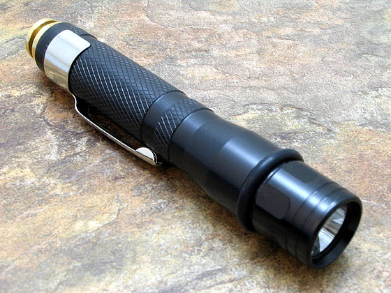

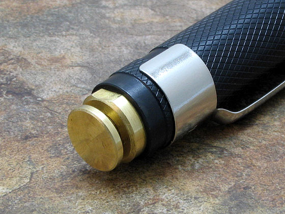

    I too was bothered by the big gap between head and body and solved mine by throwing a fat O-ring in there. It acts as a rubber bumper and gives you some forward tactile control, kinda like a SF G2z in miniature.
    Notice the narrow groove underneath the pocket clip:
    What I would dearly love to see in a future model besides the better fit between head and body:
    If the head were made of a little thicker stock, one or two O-ring grooves could be turned in there. An O-ring or two on the head would provide a sure grip for one hand twisty operation of the light. It would act as a bumper so that the head would be somewhat isolated from shock when dropped. It would quiet the light down and help keep the unit away from other objects when dangling from a keyring. It would help preserve the HA-III because of the bumper effect. It would also provide sure non slip grip for the colder months when skin is dry and hands are slippery. And did I mention that O-rings are available in Glow in the Dark...bonus!
    The other change I would like to see is the grooves in the body of the tool could be widened a bit. Doing so would allow the pocket slip to snap into place and not move up and down the body. A second wide groove could be turned on the other end so that the clip becomes reversible.
    There you go, two good ideas that will not cost hardly anything and that will make what is already a very nice light the very best of its class.
    --Peter

    Quote Originally Posted by Peter Atwood
    Nice idea!
    I reduced that gap in mine by immobilizing the spring-loaded battery contact at the tail end in its rearmost position, providing additional space in the battery tube. Now the head-to-body fit is as perfect as in my Pacific, and this apparently is more than a cosmetic improvement. The head now turns noticeably easier, probably because it uses at least 3 1/2 turns of the threads instead of only about two before, providing more even distribution of pressure.
    That may not be easily compatible with the tailswitch, though (it would be possible to shorten the switch itself a bit). I would rather have it fit right out of the package with a slightly longer body, but for now, I'm a happy camper.
