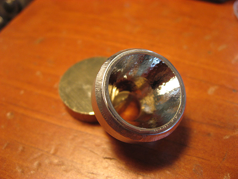

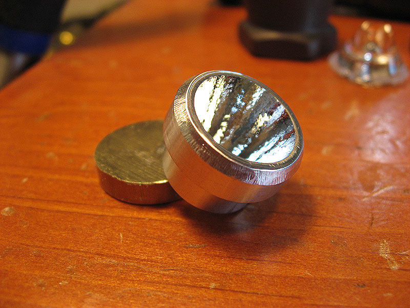

    Making a Handcut McR19 Reflector
    Here are a few photos of the handcut McR19 reflector I modified for use with the Cree emitter in Alin10123's build earlier today... thought they might be interesting...
    Next To The Old-Style L1 Head
    Closeup, Side View
    Closeup, Frontal View
    BTW, kudos in order for my east coast buddy Luxlover, who shared with me the secret of using a girly manicure accessory to polish bare aluminum to a glossy sheen! I'm not here to judge.

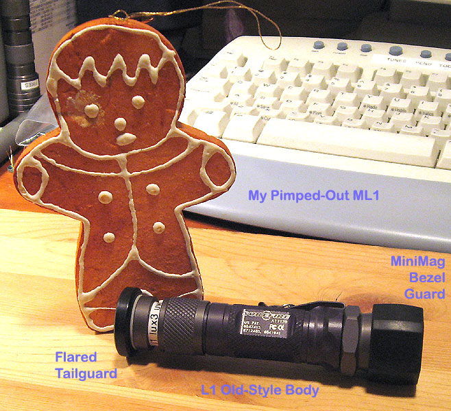

    My Pimped-Out ML1
    The real kudos goes to my deceased mother, who left behind all kinds of fingernail files and buffers, the use of which I came to realize is very handy when smoothing out any surface, especially electric contacts.
    This four surfaces in one emery board based file can be found at the cosmetic section of any chain store or department store. I highly recommend using it for light filing and buffing!

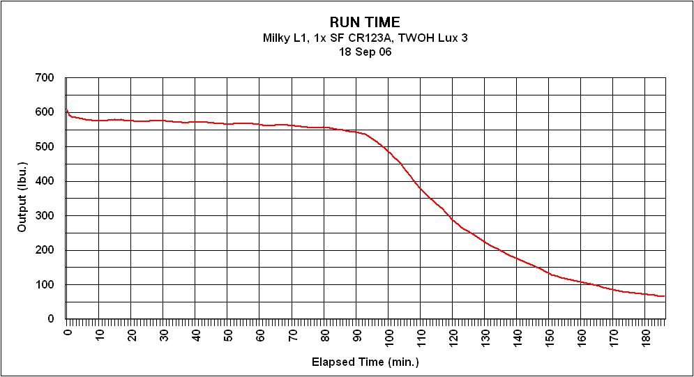

    so milky what is the runtime of a ML-1 with P4 Cree in it?
  28. #88
    Sep 2002
    New Jersey
    4,879
    Default Re: Milky L1 Information Thread
    Quote Originally Posted by benchmade_boy
    Should be about the same as this, just brighter...
