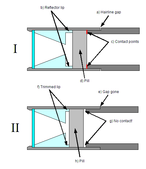

    EngrPaul, now that I have my LM301 in my hands, more questions come to my mind. I'm struggling a little with the modification of the reflector "lip" you talk about; I made a drawing to illustrate my point.
    The first drawing (I) shows how my unmodified light looks like. What I noticed is that the electrical contact c) is established by the battery tube treading against the pill d). If I untighten the head just a little the contact is lost, this is because my LM301 has anodized threads.
    Now, in drawing (II) is shown what I imagine will happen if I start to remove material from the reflector lip f) which in turn will cause the pill h) to srew deeper into the head. As you can see the contact between the pill and the battery tube is quickly lost g) because the battery tube now treads against the head e) instead. Notice that this problem will occur quite soon due to the very little gap a). In fact, I can't see how I can remove any significant material at all without loosing contact.
    My questions:
    1. How did you avoid this problem?
    2. By how much did you shorten the reflector?
    3. What beam artifacts (too wide hot-spot, dark ring etc.) did you fix by shortening the reflector lip?

    paxxus,
    nice drawings.
    1. I did have that problem! To solve it, I applied solder to the printed circuit board, and dragged some over the eged of the brass pill (which takes solder) over top of the aluminum (which doesn't take solder, but will support the solder when compressed.) The solder bridges the gap.
    2. I could only venture a guess as to how much I shortened it, .040"? Perhaps tomorrow I can bring home my calipers and compare a stock LM301 to the one I modified, and tell you the difference. Keep in mind, I used the Sandwich Shoppe Rev 2 board, which raises up the emitter higher than if you didn't.
    3. I modded a bunch around the same time. If I can remember correctly, there was a dark spot in the center, and I just kept going until it was gone. I might get a tighter beam by removing more, I don't know. The beam is perfect and floody, I like it that way.

    EngrPaul,
    Thanks
    I understand now how you managed to get it working.
    Yes, if you could manage it would be very helpful if you could measure the difference between an modified and un-modified reflector.
    I'm building this light for an older person, so it has to be absolutely robust, so the mods I do must be very reliable.

    paxxus,
    My picture account went bust! I created a new one.
    Here is some helpful shots:
    The hole needs opened so that it's slightly larger than the emitter:
    You can see how much of the reflector lip I took off here with this next picture, along with my emitter. The orange Kapton tape I added because I thought something was shorting, until I figured out the body wasn't making contact with the ground connection. I left it on anyway. That's a Sandwich Shoppe rev 2 board under there.
    Here you can see the solder I added to restore the connection that was lost because the pill goes in the head further:
    After all was finished, here is how much gap I have (after twisting onto the solder pretty hard):

    Thanks for all the pics and explanations! I've never done a mod before so I'm a little cautious. I'm still waiting to receive the Crees and I'll order the SS PCBs today. Any reason to use the more expensive CreePCB2, the original CreePCB is only $3. I can't really imagine the "Silver filled vias" in CreePCB2 to have any relevance at the low drive level of the LM301...?
    Instead of sanding the reflector, I'm wondering if I could mount the Cree on some thin copper plate/spacer instead. That should still have adequate heat transfer at this relatively low drive level. Assuming that I use the SS PCB, the height of this copper (if I can get it somewhere) should be the same as what you shaved off your reflector.
    Maybe you could measure the height of your modified reflector such that I can get an idea of the thickness of the needed copper spacer.
    I don't know anything about the old cree board. You are probably right about the relatively low drive of the LM301.
    Raising the emitter should be a valid way to avoid shortening the lip. The SS sells .030" copper discs for the SSC-P4, you may want to get some of these (see the Seoul LED page). It may be a challenge to accomplish.
    I'll get you those measurements tonight.

    Thanks! So you took off only 0.3mm, not much - I guess I'll have to sand down one of those copper discs in order to make it thinner like you did that coin in your other thread. Anyway, I'll decide which way to do this mod when I have all the parts in my hands.
