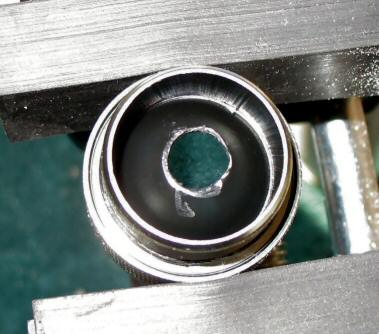

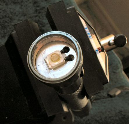

    There are some things that are very important for this mod to work. First you have to trim the star (if you use a star) because the inner part of the bezel pushes down the led pill for contact, and the star is to big to fit in this inner diameter of the bezel.
    Trimmed star:
    Then you need to enlarge the hole into the black reflector shaped piece of plastic just enough so the Cree's metal ring fits through the hole. This way you use this hole to center the star when the thermal epoxy hardens. It also pushes the star down when screwed down tight.
    Soldering is easy, just use the existing leads. The leads are even marked + & - where they are attached to the driver circuit board. Just for fun I tried the optic with another light that I have modded with an SSC P4, Liteflux LF1. The led in that light is driven harder than the Aurora but throw is visibly less with the SSC P4 in this unscientific experiment. I recommend to use an Cree X-RE with this optic, it seems to throw much better.

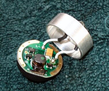

    Just to update this thread, I thought I'd post my experience and pics in turning this light into the a "space invader"
    Despite earlier difficulty in getting the head opened, I happened upon this method which worked best for me: secured the body in a Dremel-brand table-top vice (with nice soft plastic grip areas), and gave the head a good yank counter-clockwise with a fairly large rubber strap wrench. Surprisingly, it came off rather easy. I had no success using my old smaller strap wrenches and vice-grips (with heat) - but this worked like a charm
    Here's a few shots of disassembly, to compliment StefanFS pics:
    After removing the old LED (needed to cut, grind and polish it off the aluminum base), and enlarging the hole in the reflector, I attached a dealextreme.com Cree P4 WD star (trimmed the same as StefanFS). I put a dab of arctic silver under the centre of the emitter, and used arctic alumina epoxy around the edges of the star.

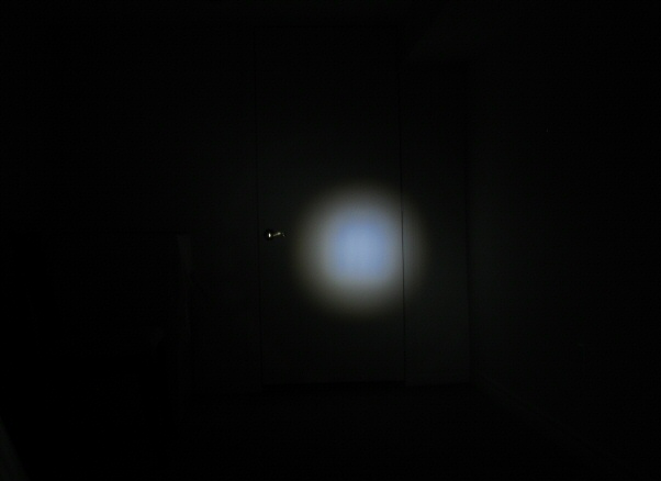

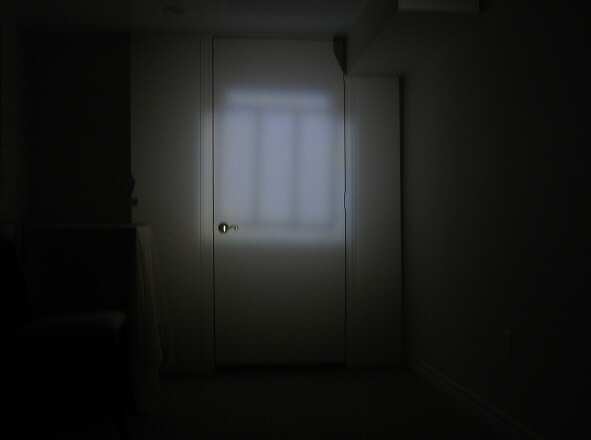

    And now the beamshots. I didn't realize just how sharply it would project the Cree die, even at great distances. It's an amazing effect!
    First shot is at 5 meters (~16.5 feet), at the middle of a door (you'll see the shiny doornob as a reference):
    Shutter speed: 1sec, F:8.0
    The next shot is at 15 meters (~50 feet), same target
    Shutter speed: 4sec, F:8.0
    In real life, the "space invader" is even more distinct than the picture shows! And that's at 50 feet away ...

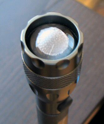

    Of course, if you want to smooth that die image out without losing too much output, I've found a small bit of Glad press-n-seal works well on centre of the lens:
    This last image is directly comparable to the first beam shot. Gives you a fairly even square spotlight effect.
