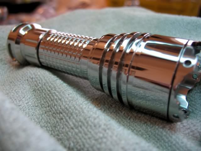

    Well Ken, I think I'm getting a little better, with some help and tips from you! I can see dust on my camera lens in this first shot.
    You can just see the batt tube there, thats next to finish off this sweet little A19!
    I will post another shot when completed, had to give my fingers a rest.

    SWEEEEET!!!!!! It`s time consuming and sure dose a number on the fingers! When your done it is hard to do this...... I haven`t been polishing today obviously! Just seems more rewarding in the end doing most of it by hand.
    Hey, that looks like my camerea???? A Canon PowerShot A620 by any chance?

    OK . this is how the Raw turned out, keep in mind that this is not Ti....
    I still have to find out a way to polish the back, and its not a "liquid metal" shine, if I shoot it with the flash, some polishing scratches show up, but im happy.. the machining marks are gone and now its smooth to the touch. Thanks for the tips guys... BTW I got this polishing cloth wheel at Sears for my drill $4.99 , came very handy and way faster then the Dremel.

    Default Re: Calling all Polishing Nutcases! Like Me!
    Way to go Cuso, good job! The aluminum will show scratches and wear a bit faster than Ti but with a little touch up here and there, it wont be too difficult to keep it looking like that.

    Quote Originally Posted by luxlunatic View Post
    Thanks!! Now I have to find a way to keep my brass lights from gettting that patina so fast , I like the shine better...
