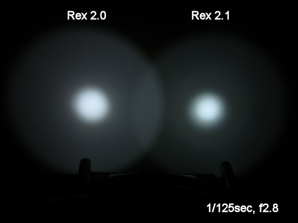

    Rex 2.0 on left (black finish), Rex 2.1 on right (natural finish)
    Taken on 2650 NiMH on Hi

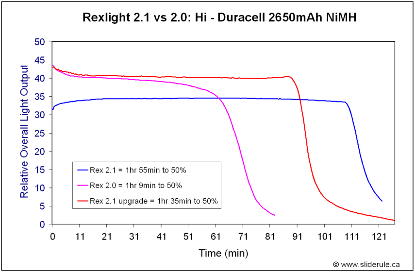

    Clearly, overall output is reduced on NiMH on the original Rex 2.1. Hard to see in the image, but the Rex 2.1 has much more "ringy" beam than the original 2.0 (as others have noted as well). Also, in real life my 2.1 has a very yellow-green tint to the beam - I'd estimate WG tint at best. Here's a lower exposure to show you the hotspots better:
    Haven't done beamshots of the new Rex 2.1 upgrade module for 2.0 yet, as there are some centering issues to be worked out (see discussion at end of post).

    • Beam profile of 2.1 is worse than 2.0 - more ringy and non-premium tint bin on mine. Note that throw has not decreased as much as overall output has on NiMH/alkaline, which may explain the rings - looks like they have adjusted the focus for better throw to help offset the lower output.

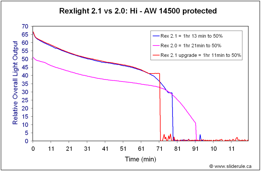

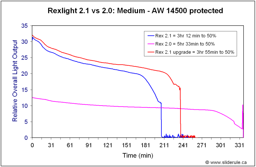

    • I'm very impressed with the runtime increases of the Rex 2.1. Although max overall output has decreased slightly on NiMH/Alkaline on Hi and Low, runtime has nearly doubled in all modes. Low runtime is an amazing 2+ days on alkaline!
    • Output and runtime have increased on alkaline on Medium, although my graph looks a little wonky. I'll re-test and post the results here.
    • Output on Hi on 14500 has increased considerably, now within the range of other lights in this category (e.g. Jetbeam MkIIX, DX X.1, etc), but with litte effect on runtime. The light is not regulated on 14500, but I'm amazed at how long it runs!
    • Rex 2.1 is also much brighter than before on Medium on 14500. On Low on 14500, it runs for an outstanding amount of time (i.e. about 3X as long as the DX X.1 for the same output).

    • As you'll see on the updated runtime gaphs, this new module pretty much exactly matches the output of the original Rex 2.1 on 14500, with slightly extended runtimes on low-medium modes.
    • On NiMH on Hi, output with this new module has increased to original Rex 2.0 levels, but with longer runtime. NiMH max output was reduced on the original Rex 2.1, so it's good to see max NiMH output of the Rex 2.0 has been retained in this upgrade module.

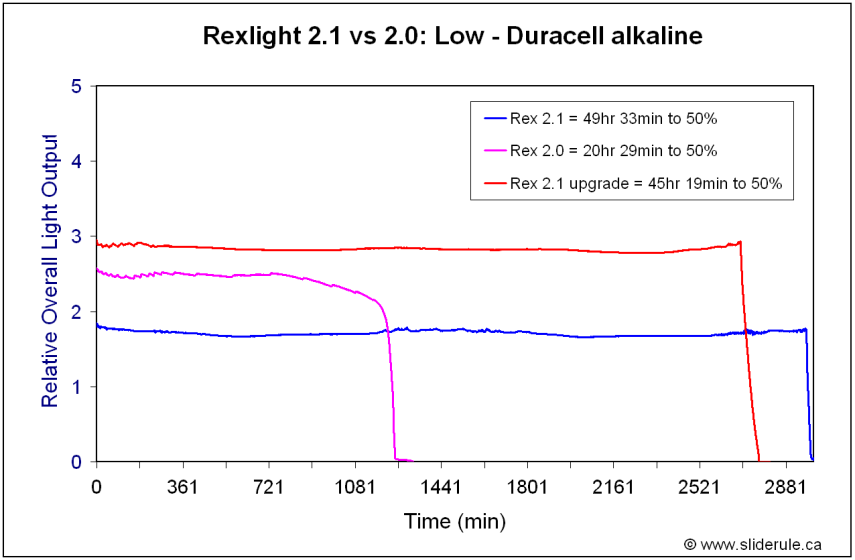

    • Output on lower alkaline modes has increased, which may not be an improvement for everyone. Output on medium is considerably brigther, resulting in lower runtime than the Rex 2.1 (runtime similar to Rex 2.0, but 2-3 times brighter!).
    • Output on low on alkaline is closer to Rex 2.0 levels, but runtime is similar to the dimmer Rex 2.1. Very impressive low runtime on alkaline at this level, supporting a considerable improvement in driver efficiency.

    Added low mode runtime on alkaline, very impressive result for the new driver.

    (Edit) The reflector is specific for the pill in the original Rex 2.1 - but you can mix and match the upgrade module with the old 2.0reflector. With the new reflector, the emitter is backed out a little further (probably in an attempt to minimize rings).
    Beam profile is indeed so-so with the new reflector - somewhat more like the Rex 2.1, which was ringier than the 2.0. But some of that may be due to centering issue - I need to play more with mine to see if I can improve it. At this point, I can't say for sure what gives the best profile.

    I'm afraid I received malfunctioned module. The 14500 low voltage protection starts blinking around 3.45-3.55V. That's way to high. I tested that both with protected (TrustFire) and unprotected (Ultra Fire) batteries.
    Any one has the same problem?

    Default Re: Rexlight REX 2.1 vs 2.0: RUNTIMES, THROW, OUTPUT, etc - Now with 14500 runtimes!
    Quote Originally Posted by tty5150 View Post
    Low voltage warning at 3,5v with no load is just right.
    At 3,5V a LiON cell is almost empty.
    Don't store it in this condition, recharge immediately.
