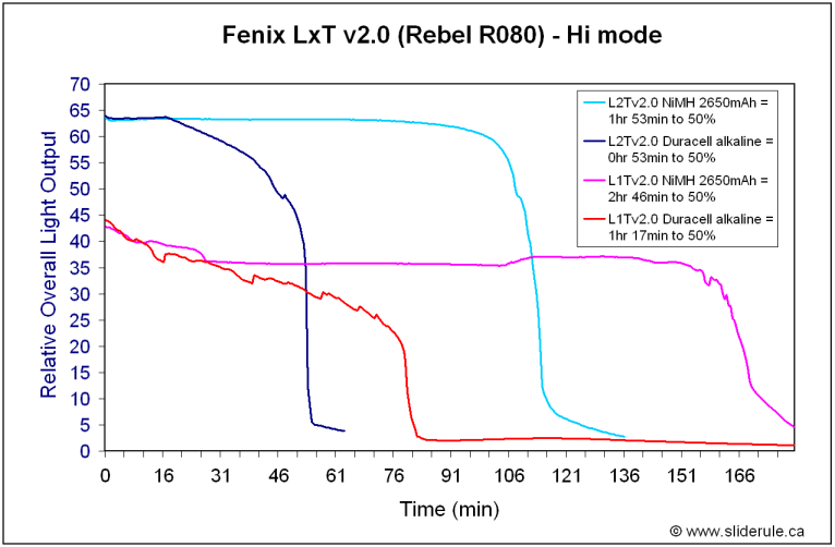

    Runtimes:
    All runtimes done in my lightbox under a cooling fan, with the identified batteries listed below.
    "Turbo" mode on NiMH (Duracell 2650mAh)
    Hi/Med/Lo modes on Alkaline Duracells
    Note that runtimes in 1AA mode seem be slightly reduced with the new Cree Q5 head. Interestingly, the low mode on alkaline is ~50% brighter on the new R100 and Q5 heads. Most people are not likely to consider this an improvement, however, as one of the main complaints with Fenix circuit-controlled low modes is that they don't go low enough. The R080 head is even brighter on Low mode, leading of course to lower runtime.
    Turbo mode on AW Protected 3.7V RCR

    As you can see, while you may get ~twice the output on 2AA, runtimes seem to be a bit shorter on both alkaline and NiMH.
