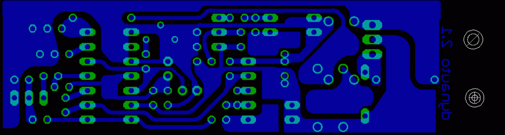

    The dynamo LED driver circuit that has been discussed in this thread has matured and a PCB is available to help those who'd like to build it.
    The following power curves have been achieved with a hub dynamo and this driver:
    This is the circuit:
    The hardware looks like this (ecaps C1..C5 are located off the board):
    and it fits into a 1 1/8" steerer tube (C1..C4 went into the tube first, C5 resides inside the headlamp assembly):
    The PCB is single-sided, FR4, intended to be hand-assembled, 100% thru-hole components (zero SMD).
    All parts are standard and the key components are LM2907 analog IC and IRFD024 / IRFD9024 HEXFETs.
    The source files of the design are here. Contains BOMs for both hub and bottle type dynamo application.
    I'm going to have some of these PCBs made and want to ask around who would like some.
    Please post in this thread how many you like, if you plan to use them for hub or bottle type dynamo, how many LEDs you plan to connect, what country you want them shipped to.
    I estimate one of the PCBs will cost no more than EUR 5 (w/o components and assembly) plus a bit for shipping, but not sure abt the exact cost right now.
    Update: Cost of my current stock is EUR 3.80 per PCB, plus shipping by letter. If you like one of these PCBs, please PM me.
    Last edited by Martin; 07-24-2008 at 12:13 AM. Reason: List of requestors removed to protect everyone's privacy

    If desired, the circuit can as well be run with 5, 7 or 8 LEDs, while I haven't calculated the component values and tested it for these configurations.
    The reason why I ask for your intended configuration while it's the same PCB for all:
    With 6 LEDs (and more), the limiting parameter is the MOSFETs Vgs limit (20V). If a lot of people run 6 LEDs, I consider adding two resistors to gain some safety margin with this parameter.

    Meanwhile I have done a small redesign of the PCB. The changes to v2.1 are:
    • Two additional resistors have been added to the gates of Q1/Q2 to form a voltage divider
    In v2.0, Vsg of Q1/Q2 was close to the max rating when using 6 LEDs. The additional resistors allow the use of up to 8 LEDs. In the course of adding these parts, all resistors have been renamed / renumbered.
    • The width of the track at the anode of T1 has been increased
      In v2.0 it burned when T1 fired repeatedly
    • Capacitor C12 (gate of T1) has been removed
      The part was not necessary and has been removed
    • Adjustable resistor R15 has been moved
      R15 (previously R13) has been moved slightly so it doesn't touch neighboring components
    • A couple of cosmetic changes
    In spite of the changes, the dimensions of the PCB remain the same. One part was removed and two parts were added to the BOM.
    The link to the design source files (first post) now links this new design. You will need this, it contains the BOM and the asy guide.
    Be aware of a slight change of plan:
    Initially I planned to have the plating-through process done though the boards are single-sided only. It was meant to better hold the components on the PCB and to avoid that traces get torn off. With my current supplier, this process would nearly double the cost of the boards, same cost as dual-layer. Since the boards I have so far populated show very good mechanical strength with kinked component legs, I decided I could get away without the plating through.
    The copper traces of the PCB are 100% HAL solder-coated and the kinked ends of the component legs solder to the traces along their full length, this is what makes it strong.
    This morning I have ordered 5 sqdm of the new boards. The resulting number of boards will probably cover the qty so far requested. It will take 1 to 2 weeks for them to arrive here. I'll build one to be sure that the redesigned PCB is OK, the rest will be sent out until my stock is depleted.
    Should until then more requests pile up, there'll be another round.
    Eventually I will need everyone's mailing address. You can send it by e-mail or PM (don't put it on the forum).

    Are you saying you want one of these PCBs and you will be using it with a 3-LED headlight ?
    Novice ? The circuit is not demanding in any way, no RF tricks, no fast controllers, no difficult soldering, no odd components. However, it's the nature of electronics that if a little detail is wrong, things no longer work as intended. The light could be dim, flickering, dead, too hot, expensive LEDs could be shot.. You have approx 40 components where one or more could be wrong / faulty / reversed / short. You'd remove the circuit from the bike, fix one thing, put it back, ride, still see a problem, remove it, try something else, put it back on the bike.. It could become a frustrating experience.
    While the PCB is being made, why not try a few of the simpler circuits here.

    To force voltage doubling, connect pins 5 and 8 of IC1. I will add this to an FAQ-sheet in the project documentation.
    Approx cost of the components (without dynamo, headlight LEDs and mechanical parts) is below EUR 10, but depending a lot on where you shop. I order from Reichelt.de and while their resistors are rather expensive, they do sell single components.
    Group buy ? This is making it too easy, too many folks are going to build this. It's gonna be a support nightmare for me..
