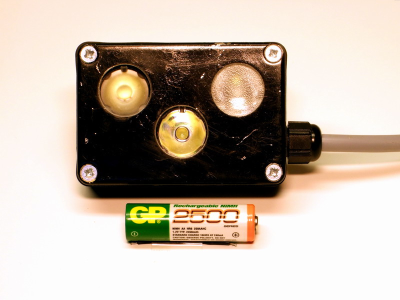

    I'm back again. Now I finished the 3-LED-testdevice.
    Pause-Light
    XR-E WD R2 and Carclo 10170 and internally etched glass lens @50mA
    Work-Light
    Diffus-part: Same XR-E WD R2 and Carclo 10170 and internally etched glass lens @150mA(low)/250mA(high)
    plus
    Light-up: One die of MC-E WD M and Carclo 10195 and clear glass lens @30mA(low)/125mA(high)
    Hall-Light
    All four dies of same MC-E WD M and Carclo 10195 and clear glass lens @4x750mA
    Shaft-Light
    XR-E WC R2 and aspherical glass lens 21,5mm dia x 20mm fl @1150mA
    In the lab it works similar to the former 4-LED-testdevice.

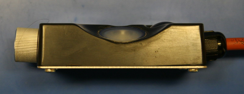

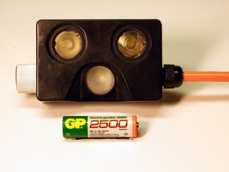

    last weekend we took some photos in Hirlatzhoehle to compare the new Testdevice_3 using a 3-LED aproach with the old Testdevice_2, which used 4-LED approach.
    You can see this at http://www.hirlatz.at under 'New comparison'.
    There is still the 'Old comparison' too, but we changed the layout a little bit: Now its on a dark background, because the photos are dark too.

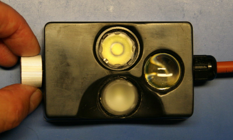

    As you all know now, I'm not expert in machine-made bombproof cases. But I'm glad I that got what I got - handmade without machines!
    My fingers are for demonstrating the size of the device
    The dimensions of the case (without knob and cable-feedthrough) are 86mm x 56mm x 24mm. The wight together with 1m cable and connector is 140g.
    The real-world-test in the cave resulted in some minor modifications to be done - thats the reason why it takes one week to come up with this posting.
    The changes at the cirquitry are done now, so I can post the circuit diagram and description for everyones free use:
    http://www.bossert-inet.de/tobias/Ci...estdevice3.pdf
    The layout of the small motherboard will be changed too, so I'm posting it later.
    The case is a Hammond 1591 XXM, which I deformed termally with a selfmade molding press. I will have to change this molding press too, because I got problems with sealing the lenses.
    It is prooven now, that we can combine the Hall-Light and the light-up part of the Work-Light. When you compare the beamshots of 'Old testdevice 2' with 'New testdevice 3' you will see, that the old Hall-Light was a little bit better. But any Hall-Light is luxury anyhow, so I optimized the compromise towards a good light-up of Work-Light.

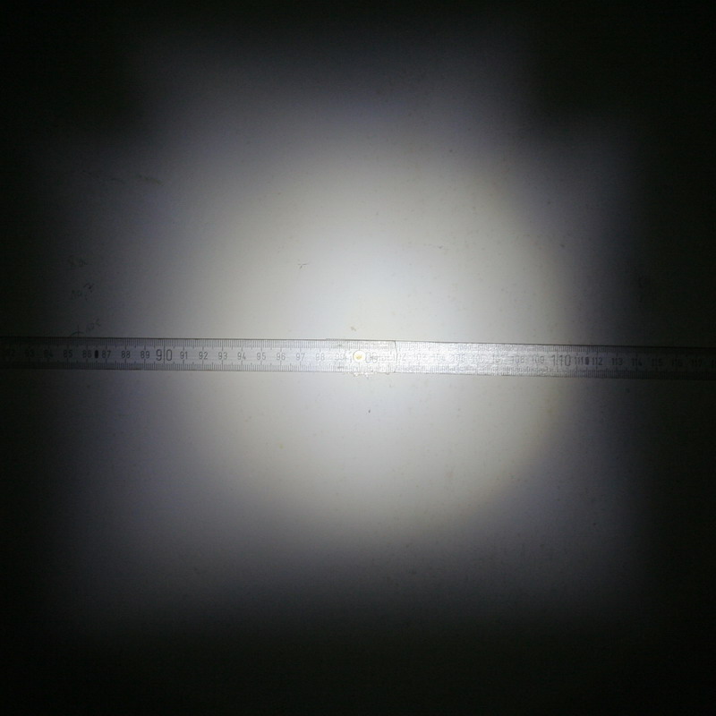

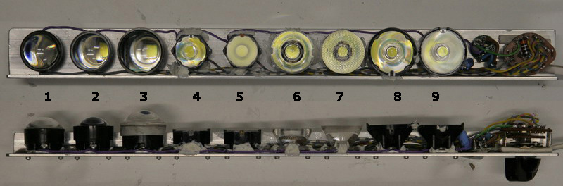

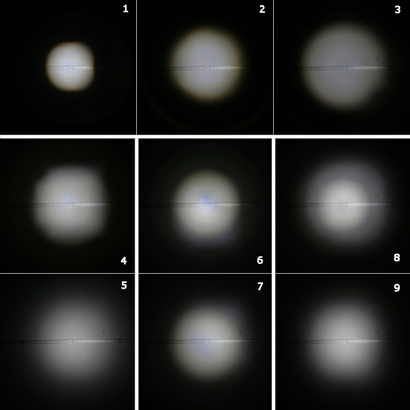

    I gathered some "narrow beam" optics and build a device to compare them under real world conditions. Here it is:
    That's no well designed model, it's simply a device to make some comparative tests.
    The optics are as follows:
    1. Spherical pcx glass lens 21mm (Anchor Optics AX77183), 20cm diam. at 1m (11°), scharp edge, rel. center brightness 100% (referenz, this is the lens of testdevice_3)
    2. Aspherical pcx acrylic lens 24mm (DX sku:4614), 30cm diam. at 1m (17°), scharp edge, rel. center brightness 52%
    3. Aspherical pcx glass lens 28mm (DX sku:5297), 49cm diam. at 1m (27°), scharp edge, rel. center brightness 29%
    4. TIR 20mm plain thight (Carclo 10199), subjective ~35cm diam. at 1m Entfernung (18° subj.; 8° spec.), rel. center brightness 82%
    5. TIR 20mm frosted narrow (Carclo 10200), subjektiv ~26cm diam. at 1m (15° subj.; 10° spec.), rel. center brightness 59%
    6. TIR 26mm clear (L2 OPTX1006), subjective ~20cm and ~40cm diam. at 1m (11° / 22° subj.; 20° spec.), rel. peak brightness 103%
    7. TIR 26mm diffused (L2? Ledtech LT-1452), subjective ~30cm diam. at 1m (17° subj.; 16° spec.), rel. peak brightness 82%
    8. TIR 26mm plain thight (Carclo 10048), subjective ~28cm diam. at 1m (16° subj.; 6° spec.), rel. peak brightness 117% (points) and 71% (middled)
    9. TIR 26mm frosted narrow (Carclo 10124), subjective ~28cm diam. at 1m (16° subj.; 11° spec.), rel. center brightness 81%
    Here you can see comparative beam shots from these 9 optics.
    The device doesn't look so nice, because all those optics were fixed with silicone. There is a severe reason for this:
    I first tried to use the original holders as intended. But it worked very bad.
    This was a new finding for me, since in past I always used the original holders to center the optics. But in past I always used frosted or rippled wide or at least medium - and whith those broad angled beams adjustment doesn't count so mutch.
    So I had to adjust every optic manually. I modified all holders to allow adjustment of at least 0.5mm in every direction. This helped dramatically.

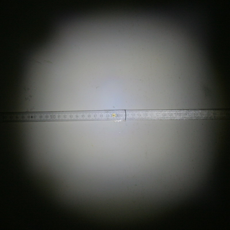

    As an example I show you Carclo 10199/10425 without modification (above) and with manual adjustment (below):
    In this case the x/y-centering of LED and optic was already o.k. but the size of die images from TIR and from center lens was different. Therefore an adjustment in z-direction was necessary by about 0.6mm, that means I had to get the LED out of the optic by about 0.6mm, to acieve maching sizes of both images. This smothed the beam pattern but increased the spot fom about 10° to about 18°.
    Result: Carclo 10199 may be optimized for lambartian sources but gets problems with the primary lens of Cree XR-E.
    In principle, such corrections were necessary with all six TIR I used. Sometimes also adjustment in x/y-directions were neccessary too.
    I realized adjustment by putting the holders into a bed of silicone on the starboard. As you can see, with some optics I didn't found an optimum adjustment. Additionally the adjustment somewhat disappeared during drying.

    Now this device with 9 optics is on the way to be tested in Hirlatzhoehle, I'm interested which one will be testers first choise...
    And now it's back again.
    The testers say that with a strong and not too wide Hall-Light indeed a Shaft-Thrower is unnecessary. But Hall-Light of 'testdevice_3' is additionally used as light-up for Work-Light and therefore needs to be wide enough (I took a frosted medium with more than 25° FWHM). This is optimum for combination with the diffuse part of Work-Light and good as Hall-Light too but too wide and too much spill for looking into deep pits.
    The testers disliked the Shaft-Thrower of my original 'testdevice_3' because it is too narrow (10° FW). That was the reason I gave them the device with 9 different throwers to test.
    Result:
    • All lense optics and 'plain tight' TIR are better than the 'frosted' ones, because frosted optics produce to much spill far apart from the center of the spot
    • Other than I predicted, the beam should not be narrow but more like medium (15 to 20° FW instead of 5 to 10° as I thought)
    • The thrower should provide a reasonably flat pattern inside the beam and than fall down at the edge rapidly but not with too strong edge on the other side
    They say, the beam shots I posted have no direct correlation to the subjective sensation when used in real cave. The sensation much more depends upon the spill and the pattern outside the 'half maximum angle', which you can't see on those beam shots.
    The first choice was #4, Carclo 10199 20mm optic plain tight for XR-E, displaced mechanically to align both images (from internal lens and from internal reflector).
    Estonishing... not the same as I thougt looking to the white wall in my cellar!
    I will follow this finding and replace the lens by that TIR for the 10 samples I'm producing now.

    Default Re: Replacement of carbide lamps by LED lamps
    There was a longer pause now ...
    but not for doing nothing!
    I added temerature control and overdischarge protection to 'testdevice 3' in the mean time. To get this all into the very smal casing I modified the circuitry: The rather big rotary switch able to carry the supply current must go and I replaced it by a tiny one for low level signals only. Also the mechanical arrangment had to be modified.
    The result is below.
    The AA cell is for size reference only.
    The light distribution of this 'device_3a' is exactly the same as with 'testdevice_3' discussed at last in this thread - the optics are just indentical.
    I handcrafted 10 samples of this headlamp for the cavers in our Austrian and German caving clubs.
    Here you can see, which versions were produced: http://www.bossert-inet.de/tobias/three_variants.pdf
    and here you find the very detailed manual for it:http://www.bossert-inet.de/tobias/usermanual.pdf
    The samples were delivered in spring of this year - and must be recalled immediately after that, because of thermal problems. That's all corrected now and these devices are used now continuously under real caving conditions.
    From this experience I learned, that a good headlamp needs an aluminium casing for cooling - not ABS as mine with an aluminium lid on the back side only.
    I had contact to some European manufacturers of headlamps. Most of them told me, that the market for cave specific headlamps is too small to start such a rather complex development. For very low numbers of pieces it is not economical to use a proprietory casing developed for this device only.
    One manufacturer asked me, whether I could modify the optical arrangement of the light sources to allow a standard rectangular aluminium casing. If so, he will develop the electronics and all other things needed and will offer such cave-proof headlamps commercially at a much lower price than common. Naturally with modern programmable digital switching, because rotary switches are too expensive and tend to be not really watertight.
    That's it, what I'm developing at the moment ...
    ... and it seems to be feasible!
    The fist prototypes achieve nearely the same light distribution as 'testdevice_3' - but all front windows lie in one plane, allowing a standard rectangular casing:
    This demontration sample has no electronics inside, it has a six-pole cable so each led can be driven externally. As you can imagin by those scratches, it even was tested inside a cave. For this purpose I developed a (not so compact) box with electronic inside: No problem for demonstrating feasibility only.
    Now I hope that this progression satisfies the needs of the manufacturers and one of them starts to develop an inexpensive headlamp optimized for huge caves on this basis.
    Last edited by Tobias Bossert; 10-13-2010 at 08:45 AM. Reason: mistyping in a link, the red color one

    We made new comparisons in Hirlatz Cave (Austria)
    3rd Comparison
    4thd Comparison
    This time we compared the light output of 10 different headlamps:
    LedLampe IV
    Scurion P7 (discontinued)
    Scurion 1300
    Petzl DUO LED 14
    Petzl ULTRA
    Petzl ULTRA WIDE (comming soon)
    Device 3a (shown two posts above)
    Prototypes 1 to 3 (model 2 shown above)
    If maximum achievable output counts, there are three favorites delivering roughly about the same light output (1300 lumens): LedLampe IV, Scurion 1300, Prototype 3.
    The first one is quite cheap, the second one is quite expensive and the third one is just a laboratory model only.
    If optimum light pattern counts, Device 3a and Prototypes 2 & 3 outperform all others - but they are not achievable on the market.
    LedLampe IV has the best flexible superposition of narrow and wide beam parts of all headlamps on the market and additionally uses diffusers to avoid glaring. But it has no real thrower (narrow spot).
    Scurion 1300 is improved with respect to older Scurions, but still both patterns do not supplemet each other reasonably. In our opinion it makes no sense to superpose both, because the FWHM of both parts are too different.
    Petzl ULTRA WIDE is much better than Petzl ULTRA for walking in caves, but provides one pattern only - neither narrow thrower nor really wide diffuse light. This headlamp has six LEDs but uses them allways in parallel, just as one common light source.
    Here is a short description of those Prototypes:
    This device has only two independent light sources like LedLampe IV and all Scurion models. On the right is a XP-G with wide angle reflector, optical deviation and diffuser giving FWHM >90° (from 75° downwards to 15° upwards). On the left is a XP-G with a ripple medium TIR with deviation giving FWHM 28° (from 4° downwards to 24° upwards). Hall light is about 350 lumens. There is no shaft thrower.
    This device has three independent light sources like Device 3a. The wide diffuse beam on the right is identical to that of Prototyp 1. Also the medium beam on the left is similar to Prototype 1 but with FWHM 32° (from 6° downwards to 26° upwards). Hall light is about 450 lumens. The thrower for shaft light uses XP-E and 20mm TIR with FWHM 8° at 250 lumens.
    This device has three independent light sources like Device 3a. The wide diffuse beam on the right is identical to that of Prototyps 1 and 2. The medium beam on the left uses three XP-G, deviation and diffuser giving FWHM 28° (from 4° downwards to 24° upwards). Hall light is about 1300 lumens. The thrower for shaft light uses XP-G and 26mm TIR with FWHM 8° at 450 lumens.
