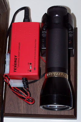

    My pack was recently toasted also. After searching around I picked up this Charger and Battery. It took a few minutes to solder a 9V connector on the battery and to gut the stock Tiger cradle and wire the charger up to it. This battery is a little longer but narrower than the stock battery, the 9V connectors can sit alongside the pack instead of under it, leaving enough room for the rubber shock tube and reflector.
    Now my tiger runs for longer than it ever did new, and charges in ~2.5-3hours on the slow setting of the charger (900ma) and a little over an hour on fast (1.8A). The battery and charger cost me $58 delivered + ~30 minutes of my time to wire it all up. The charger has a red/green light which is nice, Red light = bulk charge, Green light = peak detect/in trickle. I generally leave it in slow mode as I don't like to rush the cells too much and the fast mode gets the light a bit warm.
    Here's a pic of the cradle and charger attached to an old plaque board, mounted on the wall:
    I don't know how this battery will hold under load of the 375Lu LA compared to the super premium pack, but it definately holds voltage on the stock lamp better than my stock pack did. Someone around here was selling custom welded packs of eneloops, those would be an excellent choice, and I would have picked up one instead of the pack above if I had found it before I ordered that one, for the LSD and known high discharge capability.
