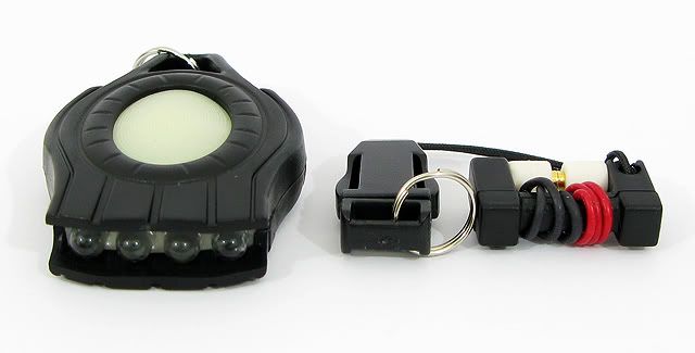

    The Glow in the dark button is really useful.
    And Here are the beam shots ..... Will do comparative beam shots with other Photon lights a little later....

    Quote Originally Posted by ViReN View Post
    In all fairness ViReN, it should be noted the button does not charge that brightly with normal usage, only if your consciously holding it up to another light source to charge it. If you're using your ReX for this and that in normal lighting and place it in a totally dark room, it is nowhere near that bright.

    Quote Originally Posted by this_is_nascar View Post
    You are prefectly right TIN. The picture is over exposed and is charged with UV LED Array I will mention this fact in review
    Will add picture of Glow Button being charged solely by LED's.

    Default Re: CPFReviews.com: LRI Photon Rex Micro Light - Preview
    Here are the new Glow Pictures
    5 Seconds after switching off the Rex Light Micro. (not in total darkness)
    After 5 minutes (in total darkness) same shutter speed as above.
