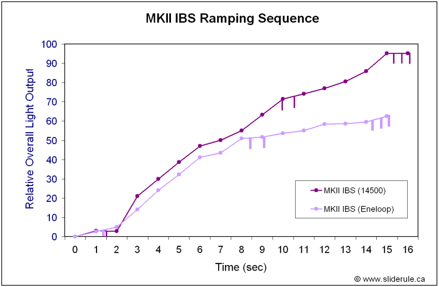

    Variable Output Ramping
    Below is a graph comparing ramping outputs on both 14500 and Sanyo Eneloop. I’ve marked the graphs with the approximate time points when the light flashes to indicate 5%, 50%, and 100%.
    First off, I should explain that the “50%” flash setting is based on ~50% max output on 14500, regardless of what battery type is in there. Since the max output on standard alkaline/NiMH is only slightly brighter than the 50% level on 14500, this gives you the strange looking Eneloop curve shown above where “50% flash” is actually pretty close to the output of max “100% flash” on this battery type, but takes an extra ~7 secs or so to reach it.
    Now with the corrected lightbox results, you’ll see the ramping results make a little more sense, although they are still not perfectly visually linear. You’ll also note that the ramping time is about twice as long as the 8 secs reported in the manual. For a comparison to other lights with a variable output interface, please see Part II of this review.

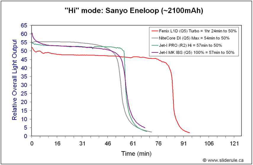

    Runtimes:
    Note: all the runtimes below have been updated with the full shipping sample (including the default Hi and defaul Lo settings, that weren't available on my engineering sample). If you don't see the new graphs, just hit your browser's refresh button.
    Note: “50% flash” on the graphs above refer to the point when the IBS circuit flashes to denote 50% on 14500 (which is actually near maximal on NiMH/Alkaline). “~50% (std batt)” refers to an arbitrary point I picked that gives you roughly 50% initial output on standard batteries.
    Preliminary Output/runtime observations:
    • The maximum output on 14500 is an outstanding ~95 relative units on my scale.
    • Output/efficiency on 14500 seems good, with no signs of the problem that plagued the initial release of the Jet-I PRO.
    • As JetBeam has pointed out, the circuit has some efficiency problems at the med/high output range on NiMH. For ex, the Default Hi and “50%” flash level (which are both just slightly lower output than max) have equivalent runtime to max.
    • Low output is nice and low – as low as I’ve seen on a multi-stage 1AA light. Runtimes are still progressing, but output levels are marked on the graphs above for your reference.
    • Higher output alkaline runtimes are disappointing, but that’s not entirely surprising given that this light is optimized for maximum brightness on 14500.

    Runtimes:
    • No doubt about it, the Jet-I MK IBS is the brightest light on 14500 that I have tested.
    • Given the incredibly high output, heat is a concern: JetBeam recommends against running the light this way unsupervised, as it could get hot enough to burn something! I concur, and advise caution in using 100% on 14500.
    • Maximum output on standard batteries is similar or greater than the other lights test here, with typically equivalent output/runtime efficiency.
    • There is some loss of efficiency on standard batteries at near maximal output, which according to Jetbeam is a trade-off in order to have maximal output on Li-ion (which so many of you seem to want ).
    • Low output is as low as I’ve seen for any of these newer multi-stage 1AA lights – certainly as low as my excellent NDI (and with equivalent runtime to boot). Very impressive that such a wide range of output is possible on the IBS circuit.
    • Regulation is excellent on all rechargeable battery types. Like the NDI, it’s clear that this light was designed to excel on rechargeables (NiMH and Li-ion).
    • High output performance on alkaline is certainly less impressive, but that’s not surprising on such a high-end light.
    Below is a graph comparing ramping outputs on 14500 for all my lights that have this feature. The graph has been adjusted to percent maximal output for each individual light, to allow you to better compare the differences. I’ve marked the graphs with the approximate time points where the MKII IBS and DBS DI circuits flash to indicate 5%, 50%, and 100%.
    As you can see, ramping time is fairly long on the IBS, and slightly more visually curvilinear than most.

    That's right ... because 240 lumens for the JET-I PRO would be using "bulb lumens" counting (i.e. theoretical max of the emitter). "Torch" lumens, taking into account how driven the emitter is, would be lower on the JET-I PRO.
    JETBeam took the same approach on the JET-I PRO as they did on their JET-II and MKII R lights - namely, not driving them at max possible output. This is mainly for thermal management and efficiency reasons. With the MKII IBS, they evidentally decided to give what so many asked for here - damn the efficiency and heat, and full steam ahead!
    The consequence in terms of runtime is pretty clear - on max on 14500, you get 22mins for the MKII IBS vs 75mins for the JET-I PRO.

    can someone tell me why the runtime on Default High is longer than 50% ?
    Default Re: JetBeam MKII IBS Review: Runtimes, Beamshots, Pics, Ramps & more
    Quote Originally Posted by dhouseng View Post
    It shouldn't be. My engineering sample doesn't have the default high mode, but I can roughly estimate it (looks like ~80% output, according light-reviews and JETbeam's own published specs). Unfortunately, my light is tied up in a low mode alkaline runtime test right now, but I'll try a ~80% 14500 test next and let you know if I can reproduce the same effect.
    But if you look at my NiMH 2650mAh run, you'll see something similar (i.e. higher output and longer runtime on max). In could be a general efficiency problem at just below maximal output. Further testing should help clarify ...
    As for the P3DQ5, it is a bit of an apples-and-oranges comparison (different size light, 2 cells, etc.). Overall output of my P3D is higher than my MKII IBS according to my lighbox (but lower according to a ceiling bounce). Haven't tested throw at 5m, but I suspect there's not likely a huge difference.

    Default Re: JetBeam MKII IBS Review: Runtimes, Beamshots, Pics, & Ramps - UPDATED!
    Ok everyone - my revised runtimes are now up in the first post!
    Sorry for the original erroneous report (I need to clean out the inside of my lightbox more often! ). The output and runtime numbers posted in the first thread now are all correct and consistent. I've reconfirmed the output levels of all the other lights in my review, and everything checks out. The lightbox is back to as good as new!
    The main differences now is the MKII IBS ramping data is a lot more linear, the output is lot more consistent with runtime (and as good or superior to the other lights), and the efficiency in most modes is pretty close the the NDI.
    The real shocker is seeing ~95 on my relative output scale for a 1AA light. But that is consistent with what my ceiling bounce test (with a different lightmeter) and my own eyes are telling me - the MKII IBS is noticeably brighter than the L1DQ5.
