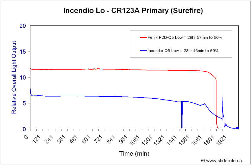

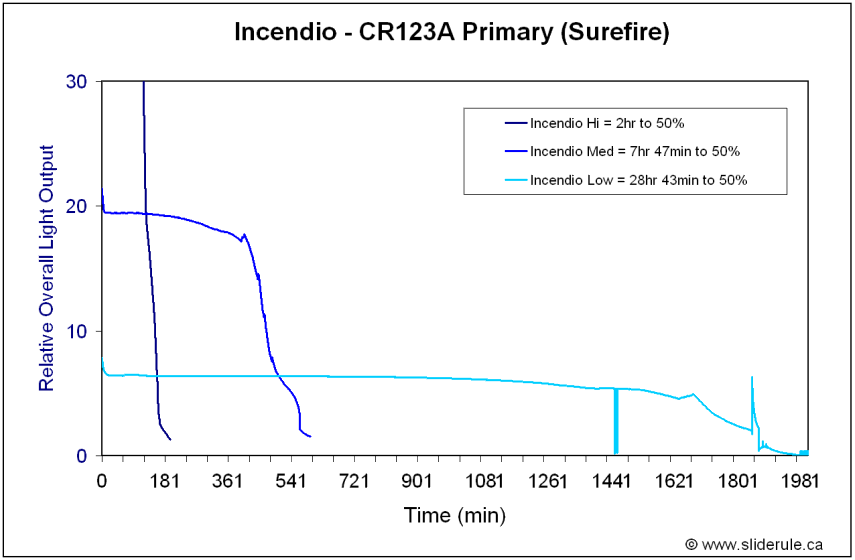

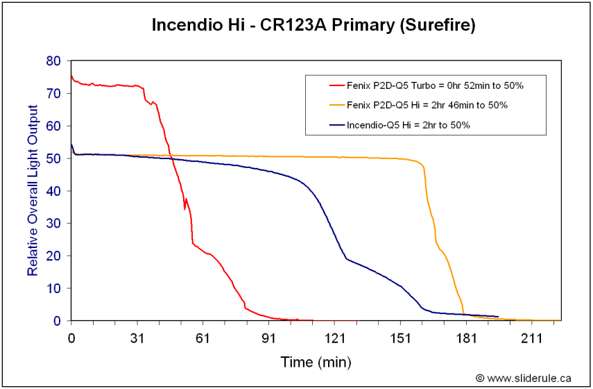

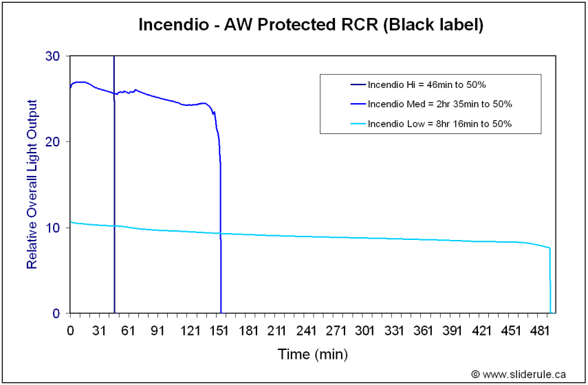

    Runtimes:
    Testing Method: All my output numbers are relative for my home-made light box setup, a la Quickbeam's FR.com method. My relative overall output numbers are typically similar to his, although generally a little lower. You can directly compare all my review graphs - i.e. an output value of "10" in one graph is the same as "10" in another.
    To start, I thought I’d compare primary CR123A and RCR runtimes invidiually. I’ve plotted Hi-Med-Lo on the same graph, but at two different output and time scale resolutions, to help you see the runtime patterns better.
    Primary CR123A – long output and short time scales
    Primary CR123A – short output and long time scales
    RCR (black label) – long output and short time scales
    RCR (black label) – short output and long time scales
    Preliminary Output/runtime observations:
    • The Incendio is fully regulated on both RCR and primary CR123A. Note that output is a bit higher on RCR, in all modes.
    • Runtimes on primary CR123A are quite good, and remarkably consistent with Lumapower’s published specs (i.e.: ~2 hours on Hi, ~35 hours on Lo). Regulation is also quite good.
    • Runtimes on RCR are not quite as long as on primaries, but still very respectable (Lumapower made no claims about RCR runtime). Importantly, output is fully regulated on RCR – which is very impressive (and quite uncommon) in such a small light.
    • Relative output levels of Lo, Med, and Hi are very sensible, IMO. Lo mode is fairly low for this type of light (see comparison runtimes below for a greater discussion on this).

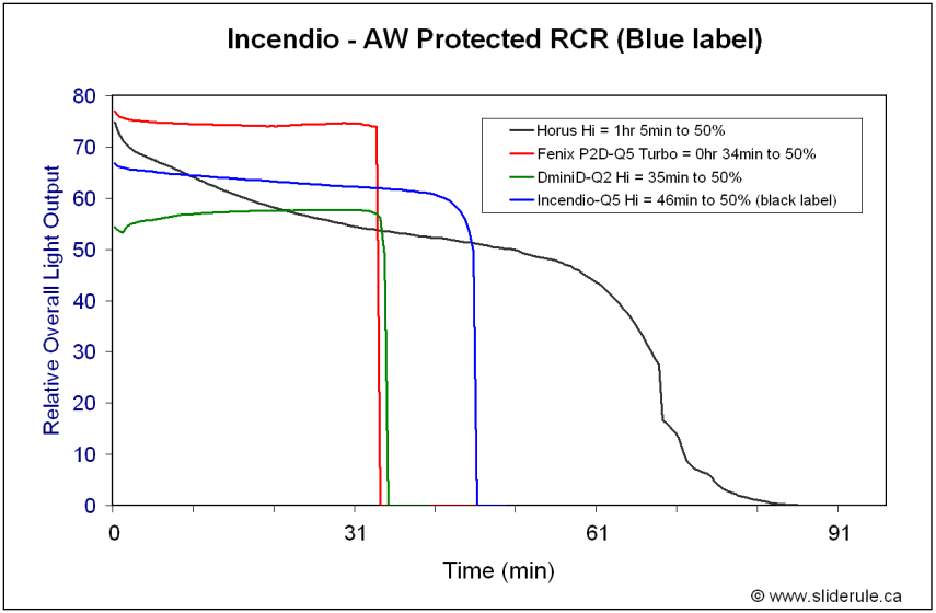

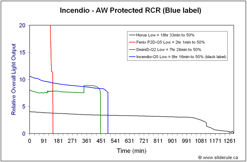

    Of course, as with any light, how does its performance stack up to the competition? Below are some comparison runtimes for the other multi-level CR123A lights used in my size comparison.
    Note that output measures for the DminiD-Q2 are likely being underestimated somewhat on the graphs – my lightbox doesn’t like really strong throwers!
    Hi mode:
    Med mode:
    Lo mode:
    Note: this graph has recently been updated with the P2D-Q5 runtime. If you don't see the trace above, please re-load/refresh this page in your browser window.
    Comparison Output/runtime observations:
    • Relative to its output, the Incendio has very good runtime efficiency in all modes on both primary CR123A and RCR.
    • IncenDio output/runtime efficiency on RCR seems to be as good or better than the DminiD (considering my DminiD is only a Q2, of course). Output levels are also roughly similar to the DminiD.
    • The only one of my single CR123A/RCR lights that can do lower output than the IncenDio is the Horus FD-1.3. But the Horus is a RCR-only light, so the comparison to a multi-power circuit is probably not fair. FYI, the Horus is also the only light with a low voltage cut-off circuit allowing use of unprotected RCRs.
    • Output/runtimes on primary CR123A show that the Incendio has lower output than the Fenix P2D-Q5 in all modes, but with typically similar runtime. This means that the Incendio is not quite as efficient as the Fenix, but is certainly not bad. The Incendio is also fully regulated on RCR, which the P2D is not.
    • Interesting output blip at the end of the Lo mode primary runtime on the Incendio. It surprisingly jumped up to initial brightness levels for the very last portion of its run. I've seen small blips before on some lights, but not usually this pronounced. Also, the light flashed (at a low intensity) for several minutes before finally going out.

    Going through my data, I just realized my DminiD runtimes are in fact also with black label AWs, like the Incendio. It is only the P2D and Horus that were done on blue-label. I'll fix the graph legends when I get the chance. I may also try to repeat at least the Fenix runs on black-label, to help with the comparisons
    Quote Originally Posted by AFAustin View Post
    I have lots of old style blue AW protected RCR123As lying around (and none of the newer black and silver), and I am so sorry to read that they're too chubby to fit in this slim little number! Oh well.....
    You might want to invest in a few of the black-label for some of the newer regulated lights.
    My previous comparison of the two types of AWs on the Horus (which is direct-drive on max) led me to think there wasn't that much of a difference between them. But on heavily-driven fully regulated lights like the Dmini digital and Jet-II IBS (which just arrived today), I'm seeing things like ~20mins for blue label vs ~30mins for black label, with only a minor output difference.
    Anyway, I don't have all the data yet - I'll do a detailed battery comparison in the Jet-II IBS review when it's ready. Probably will take me about a week or so.
