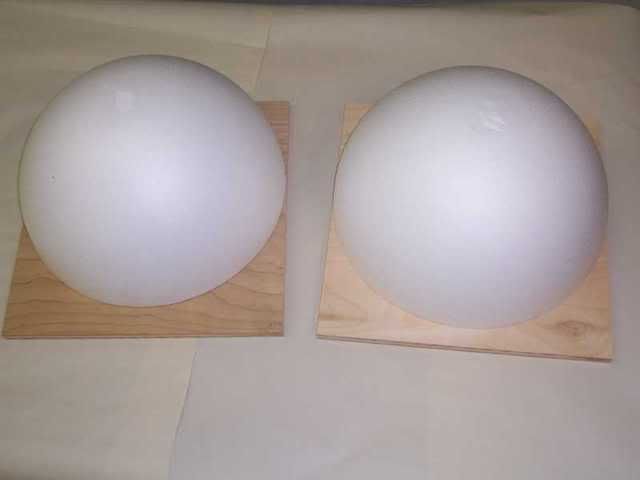

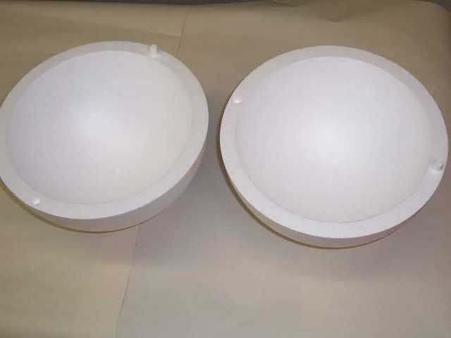

    There are already articles on CPF about different light measurement designs, but none that I found on Integrating Sphere construction. For me, finding a hollow, white sphere was the first challenge. After quite a few searches, a 12" hollow styrene sphere was found at Barnard (phone 888-584-3637). Price with shipping was about $38 - the shipping seemed high until the sphere arrived in a carton almost twice as big as the item.
    A top and bottom plate were cut from 1/2" plywood. The sphere measured exactly 12" diameter, and the plywood was cut to 11 7/8" (square) to give the sphere a small amount of compression when assembled.

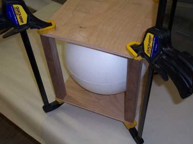

    Four posts (also 11 7/8") were cut to connect the upper & lower plates, and the posts and plates were assembled with yellow glue & brad nails.

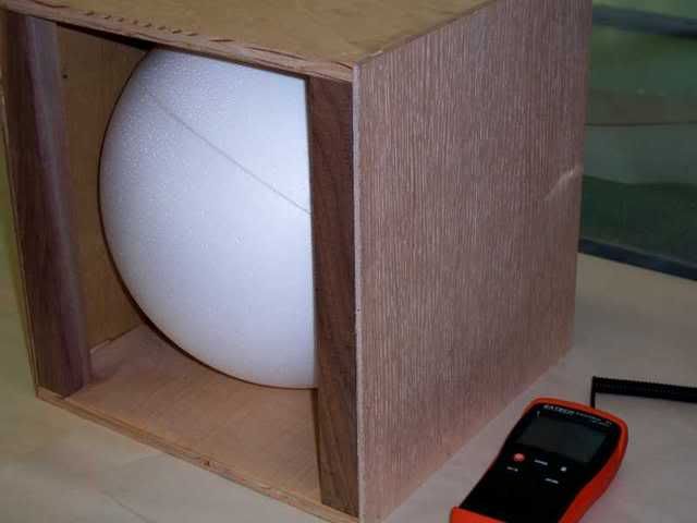

    The sphere was placed inside the assembly, and four side panels were cut from 1/8" plywood. These are attached with yellow glue & brad nails.

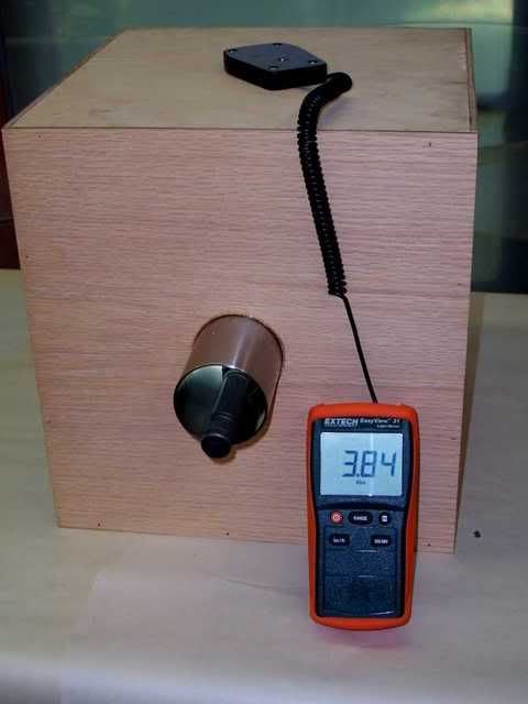

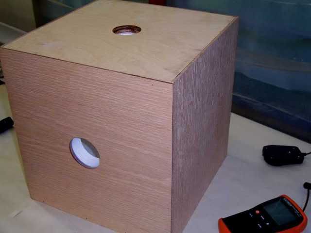

    The upper hole is cut with a holesaw to match the diameter of the light meter sensor. The light port is also cut with a holesaw to fit the light tube.
    A piece of 2 3/4" stainless tube is used here, but PVC pipe would work just as well. The light tube was coated with Satellite City Special T Super Glue, the inside of the hole was misted with accelerator, and the tube was inserted & twisted until the glue set (about 5 seconds)
    Except for applying a finish to the wood, the IS is complete. The light meter is an Extech EA31 (range to 20,000 Lux). It was found on Amazon for under $100 & gives repeatable readings. Since the IS is a comparative device, my concern is that the readings are the same every time a light is retested.
    Here are the first Lux readings obtained:
    Malkoff M60 in Surefire 6P host - 10,400
    Surefire E1B on high setting - 6,540
    Surefire U2 on high setting - 6,350
    Novatac 120P on high setting - 5,790
    Muyshondt Nautilus high setting - 4,900
    Surefire L4 - 3,840
    Malkoff M60LL in Surefire G2 - 3,330
    Surefire E2L (single stage Cree) - 2,970
    McGizmo Sundrop - 2,550
    Surefire E1L (single stage Cree) - 2,180
    Muyshondt CR2 Ion - 1,580
    Again, these are comparative readings ... they are not absolute.

    I was able to remove the straight cut tube that points down from the sensor port (painted flat black inside) & replace it with a 45° angle cut tube painted flat white inside. The long point of the 45° cut faces the light port so that any spill will hit the point & be reflected. The opposite side of the tube is in the shadow of the 45° point, so no direct light can strike the inside of the tube. The reason for the flat white is to try to match the reflectance of the Styrofoam interior.
    The output of the lights are still in the same order except that the U2 moves above the E1B. I played with the radius squared numbers and settled on 18 as being as close to published figures as possible. 18 = 4.24" radius, or about 8.5" internal sphere diameter. Best scientific guess is that the Styrofoam is not as bright as a commercial sphere, so my 10" is producing results like a commercial 8.5" sphere.
    Latest (hopefully last) revision. Here are the readings. First reading is my lumen calculation, followed by factory stated lumens:
    Mac's Custom P7 (AW C-cell LiIon) = 782 lumens (about 800 per Mac)
    Malkoff M60 with 60Ω Sandwiche Shoppe mod = 15/192 lumens (235 per Malkoff website)
    Surefire U2 = 7/114 lumens (2/100 per SF)
    Surefire E1B = 11/113 lumens (5/80 per SF)
    Novatac 120P = .23/11/99 lumens (.23/10/120 per NovaTac)
    Muyshondt Aeon = 10/92 lumens (?/114 per Muyshondt site)
    Muyshondt Nautilus = 6/91 lumens (?/107 per Brightguy site)
    McGizmo LunaSol 20 = 9/73 lumens (9/78 per Don)
    Surefire L4 = 66 lumens (100 per SF)
    M60LL in Surefire G2 = 61 lumens (80 per Malkoff site)
    Surefire E2L (single stage Cree) = 57 lumens (45 per SF)
    McGizmo SunDrop = 46 lumens (40-50 per Don)
    Surefire E1L (single stage Cree) = 40 lumens (30 per SF)
    Muyshondt CR2 Ion = 3/29 lumens
    Surefire KL1 (Luxeon) head = 29 lumens
    Gerber Trio (2 AA Lithium) = 22 lumens (24 per Gerber)

    Very interesting discussion, I've been wanting to do this for some time. I own a 6" Hoffman IS, but it has a reference light source installed and I am reluctant to remove it for fear of losing the calibration.
    This looks to be the same sphere as you used:
    http://www.plasteelcorp.com/mm5/merc...uct_Code=10072
    They also have 8" and other sizes.
    William
    *Flashaholic* precisionworks's Avatar
    Apr 2007
    Benton Illinois
    6,604
    Default Re: Building an Integrating Sphere ...
    Good call on the link to plasteelcorp, that is exactly the one. Probably made by one foam molder & distributed by a dozen retailers. The 12" size works well, I'd try a larger one except that the larger sizes quickly increase in price.
    That sounds like the wise approach. I really would like to figure out a light source of known luminous flux, then build a regulated DC power supply to drive that bulb - probably what you have in your Hoffman. But the numbers generated in my IS do track closely (in most cases) with those from the manufacturers. IMO, this is a much better approach than a one meter reading of the hotspot, which tells only a small part of the total story.
