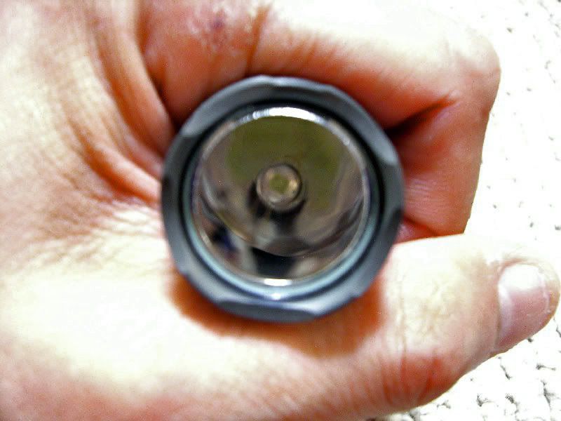

    A Look at the Head - Bad photo, but I'm trying to show the reflector and SSC P4. You get the point

    Hi guys... many thanks for so many kind sentiments! It means a lot.
    Just wanted to note briefly that Xcel730's upgrade was a little different from most in that he sent me an L1 Cree but wanted a Seoul SSCP4 emitter with IMS20 reflector in the head... this resulted in me swapping-out his L1 head in favor of the Luxeon version of that head... the latter is a more secure fit for the parts he wanted, with better heatsinking and actually a slightly shorter length. The side effect was that his pricing was somewhat different from the norm... without getting into all the numbers, the conceptual differences were as follows: (1) heads were swapped; (2) the L1 Cree often does not need a new emitter as it's not uncommon for SureFire to mount what by all indications is at least a Q5-binned emitter in the stock light... that's not always the case, but it happens often enough that I can amortize-in the savings of not needing a new emitter, nor the labor to change it... the Luxeon head DOES need an emitter swap added to the mix in every case, so pricing is a little higher, all other things being equal.
    Admittedly, it gets a little confusing to price the upgrade when mixed-generation components are involved, and I will readily admit I don't have every possible combination perfectly accounted for costwise, but I do my best.
    Quote Originally Posted by jzmtl View Post
    When you say 165 lumens is it emitter or out front?
    I'm still debating if I want to send my L1 in, maybe I'll wait till cree come out with a higher bin so I can have emitter swapped at the same time.
    Jzmtl, that's an estimate of emitter lumens based on a fairly conservative estimate of the luminous flux of an average emitter in the given bin. I've calculated outputs on my lights in this way for quite some time... and more often than not, I'll compare the finished piece in an A-B ceiling bounce test with some known controls here in the Milky Labs as a general sanity check that the numbers make sense. A couple months back I also derived a mathematical model (actually, two... one a third-order polynomial function, the other a second-order polynomial function) that allows me to come up with a reasonable expected output in lumens for any given output current.
    Also, in the past some of my lights have been output tested in detail, most notably by fellow CPFer Leef, who put together arguably the nicest lightbox test rig I've ever seen... my lights tend to perform very close to the rated lumens I've specified for them... this is noteworthy because my rating is essentially EMITTER lumens, while Leef has been testing TORCH lumens... it seems the slightly conservative skew I apply to my output ratings more-or-less compensates for the loss occurring in reflector and lens, which is encouraging!
    Hope this helped. Sorry if I went off the deep end in terms of the geekspeak.
