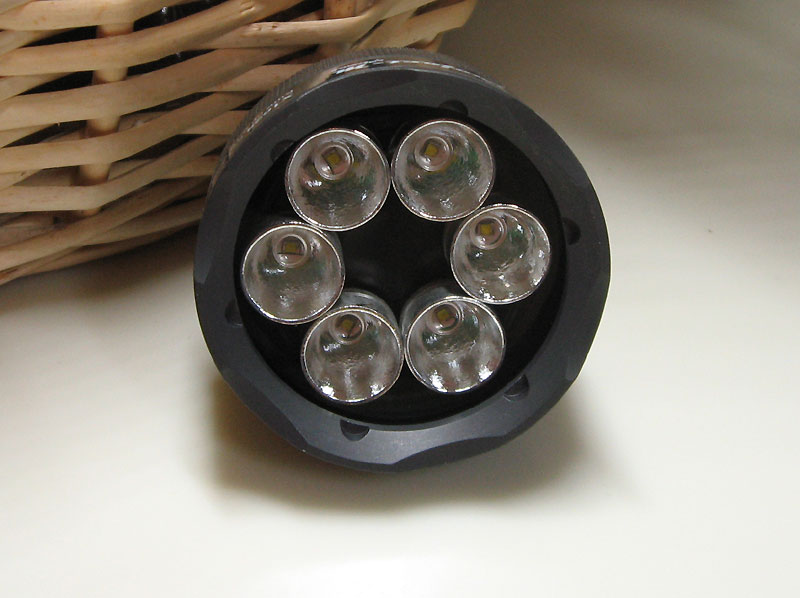

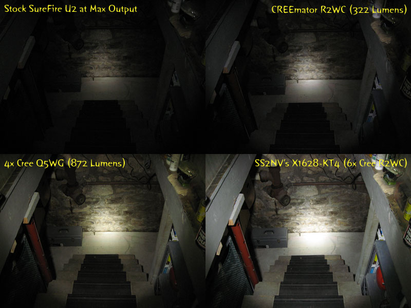

    Here are a couple preview photos of the light I recently completed for SS2NV... it's a 6x Cree R2WC build in a SureFire KT4 turbohead, with estimated output of 1628 lumens...

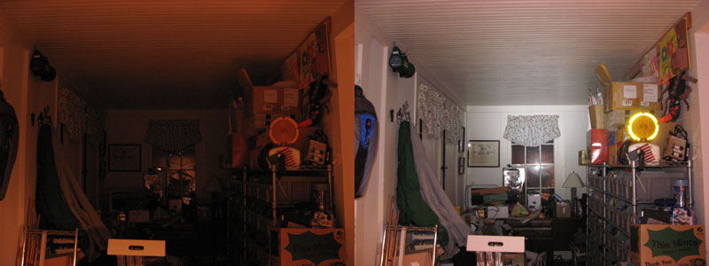

    Received the x1628 head in the mail today. Very impressed with the build quality. Here's a few shots of it on my BigLeef system:
    In a mostly dark room. It lit it up pretty well, I'd say.

    you have a mouse on your couch!
    that hotspot is enormous

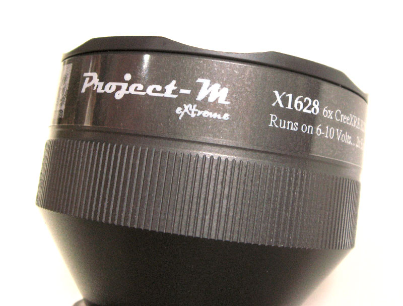

    Beautiful light... What are its stats?

    Here are some of the stats as listed on the label...
    6x Cree RCWC with McR17xr reflectors... 1628 lumens on 6-10 volts input (optimized for a pair of Emoli or A123Systems 26650 cells)... suggested runs of 5 minutes at a time, with some cooldown time between runs (can run for longer than that, but the light was designed for maximum-output in lieu of continuous runs, and heat does eventually build up, hence the suggestion)... overall runtime on 2x26650 Emoli is likely to be 45 minutes or so.

    Gotta love it. This thing wowed the hell out of me last night!
    Ti PD-S on left, U2by2 on right, both on high.

    WOW! That is really sweet! Does the selector ring still work to adjust the output on the U2by2?

    Yep, the driver and ring stay stock, so the runtimes are the same.
    Everyone needs one of these.
