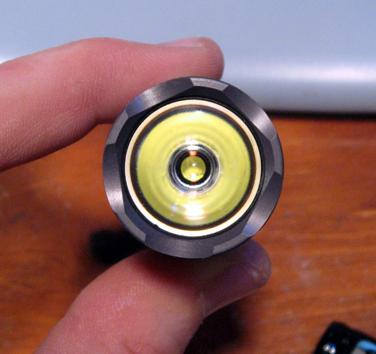

    Thanks guys, it means a lot.
    Don't want to change gears on you as Dirk's build is worth some attention, it turned out very well if I may say as much... that said, also want to mention the recent 'Legolas' build for Crenshaw...
    ML1cx2 'Legolas'
    A while back Crenshaw got in touch about turning an L1 Cree into a true pocket rocket suitable for EDC use. He already had a Milky L1 with higher-output drive circuitry so this needed to take things to the next level. The result was the ML1cx2, dubbed 'Legolas,' which brought Creemator-level performance to the L1 platform. Crenshaw posted a great review thread over here to which I added several build photos and a brief writeup... thought folks might want to know about it.
    Here are some teaser photos...
    Full thread is over here...
    Introducing the Milkyspit L1cx2 "Legolas"
    --Scott

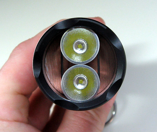

    A Project M X542. New generation KL3-BK with 2x Cree XR-E R2 WC emitters in cut-down McR16XR reflectors, mounted on a Tellurium Copper heat sink. Each emitter is seeing an amp. ~542 Lumens.
    For the photos, it's riding on a 6Z-BK, with a Z49 tail, but It'll probably live on a 2x18650 tube of some sort.
    Another great job, Milky!

    One comment on Snake Eyes (which I'm glad you like, Donn) ...the thermal epoxy is actually not so easy to see as Donn's photo makes it appear... one has to look into the head at a fairly extreme sideways angle to see it. Here's a more normal look into the head...
    And here's another...
    Sorry for the insecurity on my part! Just that I left the copper heatsink unmatted on purpose to achieve a 'skeletal' look... IMHO the copper color offset within the black head itself is nice to look at... and don't want to leave the impression that all one sees is a couple blobs of thermal epoxy, as in truth that's not really the case. I'm probably being oversensitive about the photography, sorry if so.

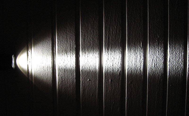

    Sheesh! I didn't even see the epoxy, until you brought it up.
    What I did see, however, as I mentioned on the phone, is the quality of the beam. It's absolutely perfect. Whatever it is you do to align the two reflectors/emitters, obviously works. You'd never guess it's more than a single light source.
    I've moved it to a Leef 2x18650 tube now, running on 2x A123 cells. Very nice! Any guesstimate on runtime?
