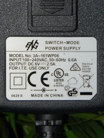

    AC/DC adaptor power in : 100 to 240 VAC (50/60 Hz)
    AC/DC adaptor power out : 6 VDC / 2.5 A
    DC/DC adaptor power in : 12 to 24VDC
    DC/DC adaptor power out : 6 VDC / 3 A
    IBC Charger DC in : 6 VDC / 2-3 A
