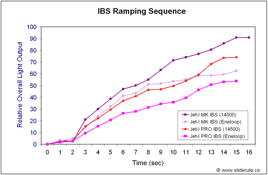

    Variable Output Ramping
    In addition to the slight reduction in max output on this new IBS circuit, the ramping sequence has been altered. In the original circuit, ramping was roughly visually linear for 3.7V Li-ions, but not at all linear for standard batteries (NiMH/alkaline). This meant relatively little output difference between the 50% flash, Default Hi, or Max on standard batteries.
    As you can see in the graph above, JetBeam has fixed this issue for the new IBS circuit on standard batteries. Given that the Jet-I PRO EX V2 body is designed to only use standard batteries, this is a welcomed improvement.

    • The new IBS circuit has a better ramp on standard batteries than the original IBS circuit, making it much easier to choose your desired output level.

    • The new IBS circuit has a revised ramping sequence that is now visually linear on standard batteries. This is very welcome, especially for the 1AA/2AA series lights.
