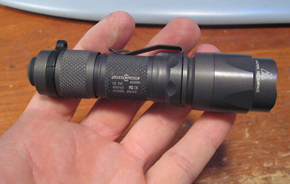

    Crenshaw approached me in hopes of building a turbocharged L1 suitable for a variety of purposes, but chief among those being an ability to generate output comparable to that of the Creemator builds. Didn't seem realistic at first, but as the idea had time to gestate it became clearer how one might do this while also keeping the great things about the L1 platform: AWESOME tailswitch; immediate dual stage capability; high beam and full lockouts; great ergonomics come to mind.
    The above photo certainly looks like a stock SureFire L1 Cree! And that's the intent... but under the hood this little monster is somewhat different, heh heh. The label gives a hint...

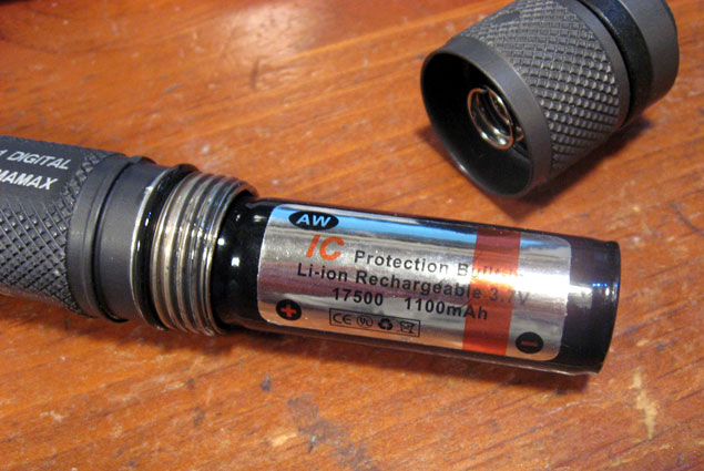

    One thing I did was move from the stock 123 cell to the larger, higher-capacity 17500 rechargeable... this allowed me to design the light to run higher output for longer, and since I stashed the circuitry itself in the head, there was really no penalty other than what admittedly turned out to be a LOT more labor and parts expense in getting the thing right.
    At the business end of the light, I substituted a KX1 head for the stock L1 Cree head... other than being a minuscule bit longer, which in most cases is near-unnoticeable, the KX1 has exactly the same dimensions and styling as the stock head. Inside I shockmounted an Acorn 1.3 driver running custom firmware programmed for the project (it's a variation of the 'Bailey' firmware tailored to use on the L1 platform) plus custom-fabricated the battery contact points (more on that later). The head retained the SureFire TIR optic, albeit in focusable form, as that particular optic already does a great job with throw... the new focusability helps it do the job a little better.
    The underside of the head needed new battery contact points to give the 17500 cell more depth in the body... for this I fabricated a flat contact board, with the negative outer ring in the usual place but the positive connection at the same depth in the head, no longer on a post as the stock positive contact had been... this in turn gave the battery upwards of 1/4 inch greater depth, enabling it to fit the body without need for any sort of extender.

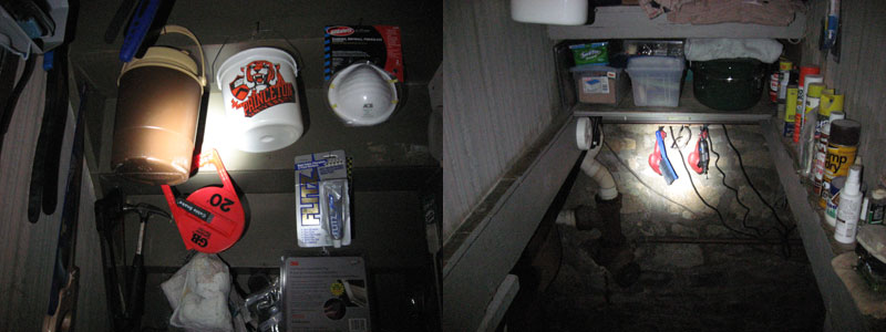

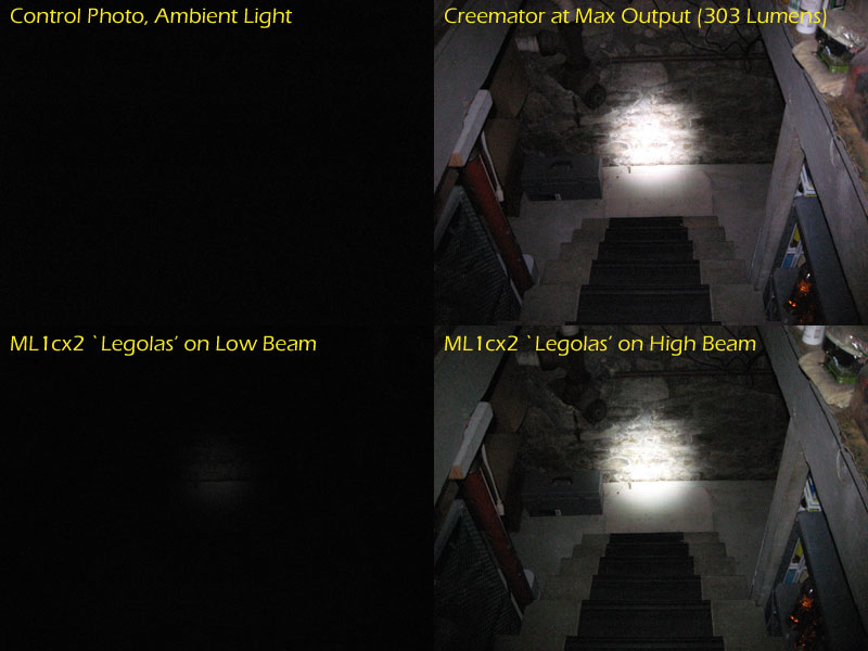

    Compared Legolas to a 303-lumen Creemator here in the Milky Labs. Distance to the far wall is perhaps 20 feet, and note there was already a decent amount of ambient light in the room. Still, the comparisons show Legolas' performance accurately... look in particular at how low beam is visible in the retroreflective roadside warning beacon toward the right of the visible area... also note how similar the beam is to the Creemator itself, both in pattern and output. In truth, Legolas on a fresh 17500 cell may be marginally brighter.
    Same comparison as above, but this time looking into the basement. There was little to no ambient light for these photos, so all the light you see comes from the test subjects themselves. Tint as shown in the photo is pretty realistic, at least as it appears on my computer monitor. YMMV.
