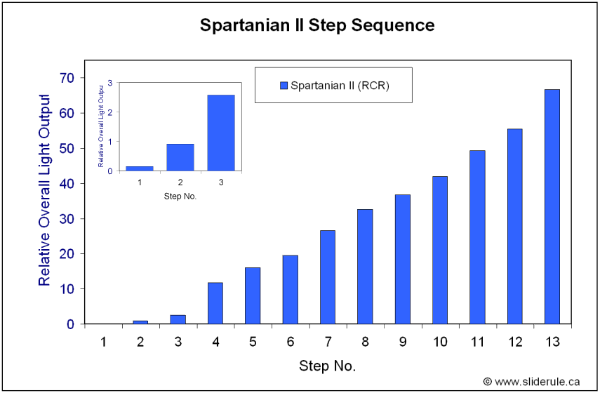

    This is where it gets interesting. The Spartanian has 13 discrete output levels - and uses both current-controlled and PWM to produce its low modes. See Part II for a list and graph of the relative output levels.
    From L4 through L13 (i.e. the 10 highest output levels), I can detect no sign of PWM flicker by eye or through my setup. Neoseikan confirms the light uses a standard current-controlled mechanism in this range.
    On the lowest three output levels (L1 to L3), PWM is detectable (although not overly obtrusive) at a measured freq of 127Hz in my sample. This is an interesting hybrid design - current-control is known to be more efficient than PWM, but typically can't go to as low output levels. By combining both into one circuit, the Spartanian II gets the best of both worlds. This is the first time I've come across with this interesting combination.

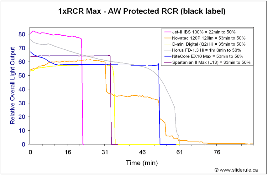

    Testing Method: All my output numbers are relative for my home-made light box setup, a la Quickbeam's flashlightreviews.com method. You can directly compare all my relative output values from different reviews - i.e. an output value of "10" in one graph is the same as "10" in another. All runtimes are done under a cooling fan, except for the extended run Lo/Min modes which are done without cooling.
    As you can see, the Spartanian II is indeed one of the best 1xRCR throwers in my collection. It exceeds my D-mini digital, and matches the Jet-II PRO IBS (which, to be fair, is driven at a higher output level than the other lights here).

    Output Levels:
    As you'll recall from my UI description, the Spartanian II has 13 discreet output levels, and uses PWM for the lowest 3 (current-controlled for L4 and up). As you can tell from the graph, there's a bit of a jump when you switch from PWM to current-controlled (i.e. from L3 to L4), but otherwise all levels are well-spaced and visually linear overall. For resolution purposes, I've blown up the lower PWM output levels in the insert graph on the top left. Note that this visually linear relationship is in contrast to the Novatac 120P, where output levels are directly based on lumens (and hence visually curvilinear to human eye).
    This hybrid of PWM and current-controlled is very interesting, and should net the best arrangement of output/runtime-efficiency and lower low modes.

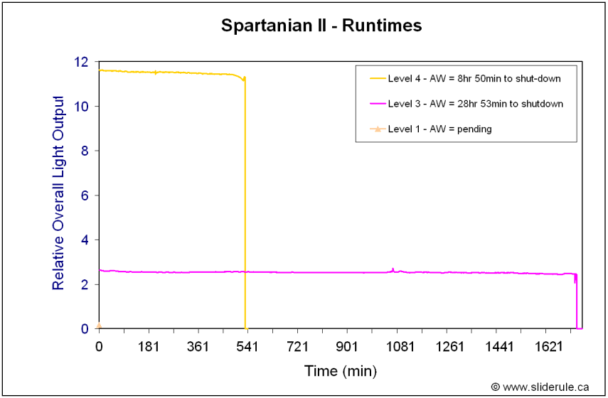

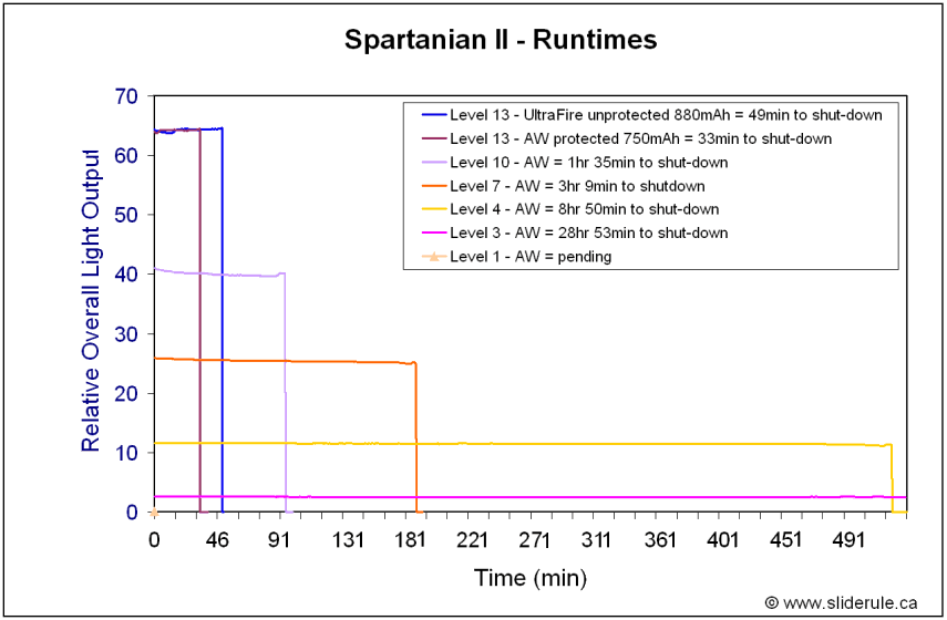

    Output/Runtime Comparison:
    To begin, below is a graphical comparison of five output level runtimes (L3, L4, L7, L10, L13 - counting from the dimmest output levels on up). All runtimes are on AW protected RCR (3.7V, 750mAh). I've also included one L13 run with an unprotected Ultrafire battery (3.7V, 880mAh) to test the built-in low voltage battery protection feature. Note that L3 and lower (still pending) are PWM-based, while L4 and higher is current-controlled.
    Below is how the Spartanian II stacks up to competition. Also included in these comparisons is the direct-drive Horus FD-1.3, since it was also RCR-only.
    Output/Runtime Comments:
    • The Spartanian II circuit produces one of the best regulated output patterns I've ever seen - at all the output levels tested so far.
    • There are no surprises in output/runtime efficiency at any level I've tested so far - performance is good to excellent across the board.
    • The hybrid PWM and current-controlled circuit is very innovative, and seems to deliver on the best of both worlds.
    • Performance is generally on par with the best regulated multi-power 1xCR123A lights. Perhaps a bit less on max, but the Spartanian II seems to match or pull ahead of the crowd on medium-low modes.
    • In comparison to the other RCR-only light in this review (Horus FD-1.3), the Spartanian II holds its own well. Although the direct-drive Horus runs longer on max (as you would expect), performance of the fully-regulated Spartanian II seems to match or even exceed it at the medium output levels.
    • The low-voltage protection feature for unprotected batteries works well in my tests - and nets you extra runtime, since unprotected batteries typically have higher storage capacity.

    4. About runtime
    We are happy to see you got a 49min runtime of lvl.13, which is equal to our record in the lab. It shows the other parts such as tail spring do not make a big power loss. We are making some improment on manufacture technics to assure every part works well. We suggest battery without protection for S2 cause we have a very reliabe low-voltage protection function.
    5. About low level
    The first version of S2 do not have the lowest 3 lvls and start from 50mA driving current. If you never use low level or ultra low level, just do not twist to left so much times

    Just updated the main post with L3 runtimes - almost 29hrs on an AW protected, not bad.
    Oh, and I see neoseikan has just started his pre-order thread CPFM, with tiered pricing depending on order number.
    I'm looking forward to hearing more about possible CR123A circuit development - I think that will be a real winner here. But I'd like hear what everyone else thinks - that's one of the main advantages having these discussion threads continue after an initiall review.
