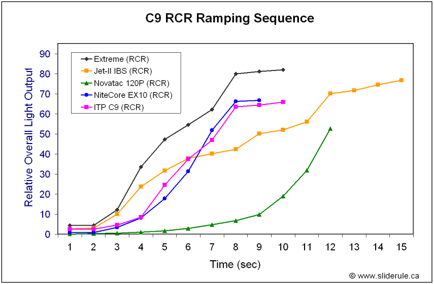

    Variable Output Ramping
    As you can see, the C9 ramp is relatively linear and faster than most of the competition. In fact, it is virtually identical to the NiteCore EX10 (with very similar min and max levels). The light flashes 3 times rapidly to let you know when it has reached the end of its ramp (either min or max).

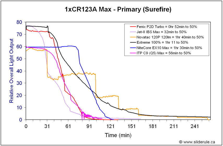

    Output/Runtime Comparison:
    Output/Runtime Pattern:
    • Overall, output/runtime performance of the C9 seems pretty consistent with its continuously-variable competitors on both CR123A and RCR.
    • At the higher output levels, output/runtime of the C9 is typically toward the lower end of the range of lights compared here (which are all excellent). However, the C9 pulls away from the pack at the lower levels on both battery types, with typically the best output/runtime efficiency of its class so far.
    • The C9 also has the most consistent linear regulation of all lights tested here. Most of the other lights are pretty "noisy" in their runs at lower output levels, but the C9 is remarkably consistent The only quirk is a single quick jump in output of ~10% at a variable point during many of the runs but otherwise the output is perfectly flat.
    • The C9 features a low voltage warning flash (i.e. all the spikes at the ends of the CR123A traces). This kicks in shortly after the light falls out of regulation, indicating the battery is nearly depleted and should be replaced.
