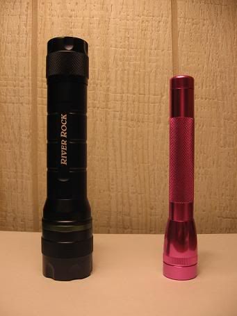

    SIZE/WEIGHT
    6.8" x 1.5"
    10.5 oz (with 2C batteries installed)
    River Rock Nightfire 2C vs. Maglite Minimag 2AA

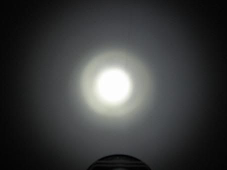

    What impressed me the most about this light is the incredably smooth beam! It has the smoothest beam I have EVER seen on a flashlight! If I saw a beamshot of this light and didn't know any better I would think it used a Seoul emitter and definetly not a Cree. I don't know how none of the high end LED flashlights can get a perfectly smooth beam with a cree and a cheap flashlight from Target can.
    BEAMSHOTS:
    River Rock Nightfire 2C Beamshot
    River Rock Nightfire 2C White Wall Beamshot
    Taskforce 3W 2C White Wall Beamshot
