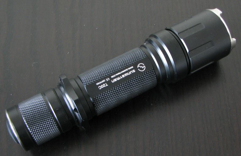

    What you are looking at is an engineering sample of a new Sunwayman light, the T20C. It has some distinctive features, which I will describe below.
    To give you a general idea up-front, the light uses a Cree XP-G R5 emitter and takes 2xCR123A, 2xRCR and 1x18650. It is a multi-mode light, with 3 constant output levels and one “hidden” strobe. But the switch is unique – it is silent (i.e. no click) and can do both momentary and constant on.
    Also, the final appearance of the light may change for the shipping version. Sunwayman informs me there may be modifications at the mass production stage.
    First off, I have no idea what packaging will be like, but I assume it will be fairly typical to other Sunwayman lights (i.e. you usually get at least a wrist strap, body clip, spare o-rings and boot cover, manual, and warranty card). Also no idea as to price yet.

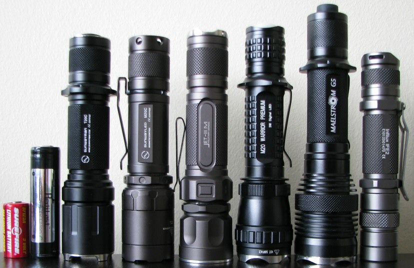

    From left to right: CR123A, Redilast protected 18650, Sunwayman T20C, M20C, JetBeam Jet-IIIM, Olight M20-R2, 4Sevens Maelstrom G5, Nitecore IFE2.
    From left to right: AW protected 18650, Fenix TK15, TK12, 4Sevens Maelstrom G5, Sunwayman T20C, Nitecore IFE2, Eagletac P20C2-II.
    T20C: Weight: 118.3g (no battery), Length 136.8mm x Width 32.0mm (bezel)
    TK12: Weight 123.3g (no battery), Length 138.0mm x Width 34.1mm (bezel max)
    Again, the final build of the light may change.

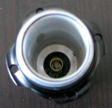

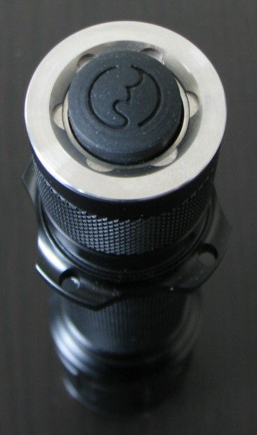

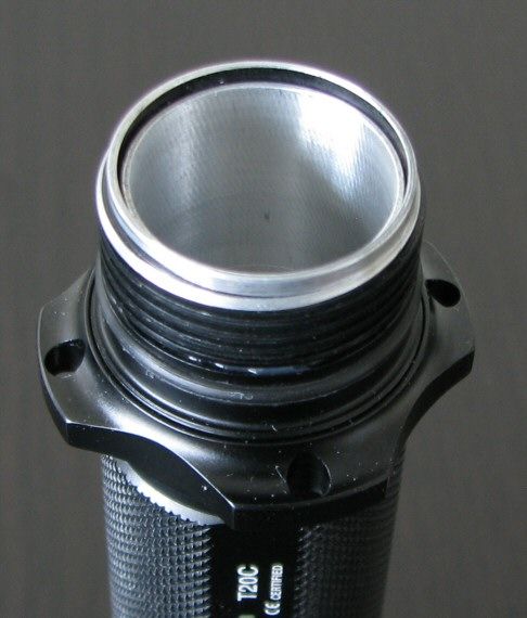

    What is most distinctive about the light is the switch. At first, I thought it was an electronic switch, since it was noiseless (i.e. no click). But it's not that simple, given given how it functions (i.e. half press for momentary, full press for lock-on).
    In reality, it is something of a combination of an electronic switch in the head, with a mini-piston and a mechanical tailcap switch. If you look at the interior tailcap picture above, you will see two semi-circular areas on the perimeter of the switch spring that have a "L-shaped" pattern to them. These two areas rise when you press on the switch button.
    So, when you first tighten the tailcap, the outside portion of the switch makes contact with the outer ring of of the body tube. As you press the button, eventually the raised switch areas make contact with the inner part of the body tube (which is actually a spring-mounted interior sleeve). Continue pressing, and sleeve makes additional contact with the head somehow. This is how the light apparently signals the difference between a momentary press, and locked-on. I'm not entirely clear on the circuit specifics, so please check with Sunwayman for more info.

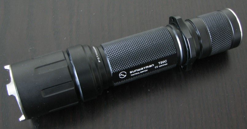

    For the current engineering sample, I would say it is a solidly made light. Annodizing is a shiny black instead of the classic Sunwayman natural (Sunwayman confirms the final version will be black). Knurling is reasonable, and the light comes with stainless steel bezel and tailcap rings. The light cannot tailstand. Tailcap threads are anodized for lock out.
    Thanks to the spring in the head, flat-top cells work fine.
    All in all, it is a fairly classic and classy looking build for a light this size.

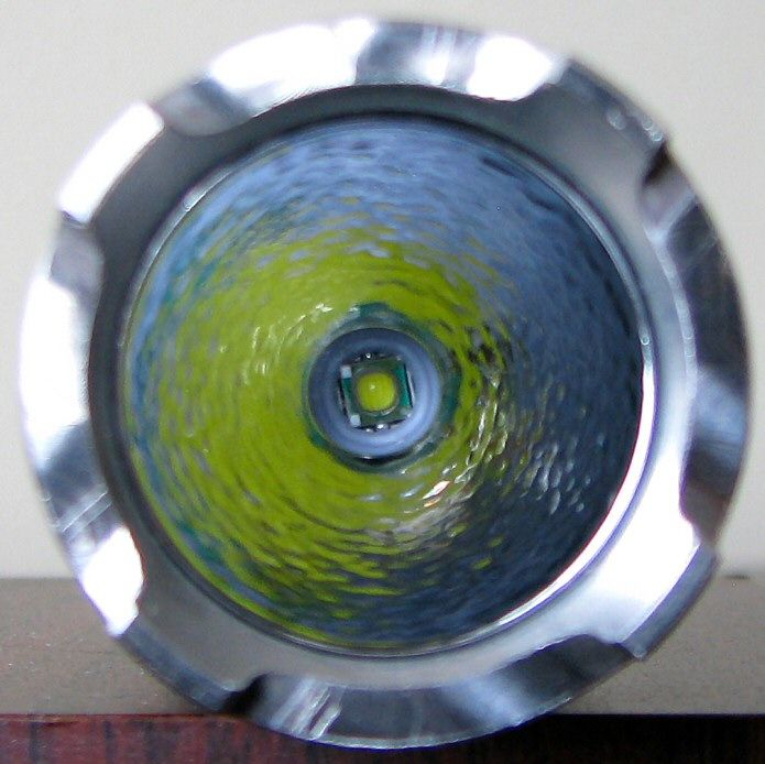

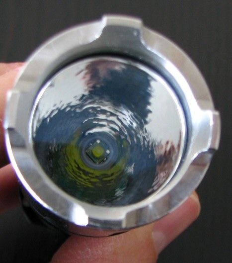

    The T20C apparently features the Cree XP-G R5 Cool White. The reflector is textured to what I would consider a medium orange peel (MOP). Given the overall size of the head, I would expect a fairly typical beam for this class of light.
    UPDATE: Again, this review is based on an early engineering sample of the T20C, which contained the Cree XP-G R5 emitter. Sunwayman has decided to go with a XM-L T6 emitter in the shipping T20C. You should therefore expect greater max output and less throw from the XM-L emitter version (given that the build seems otherwise the same).

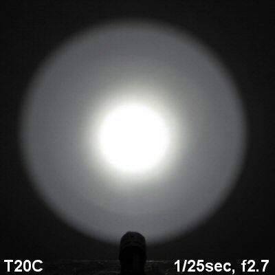

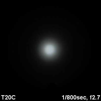

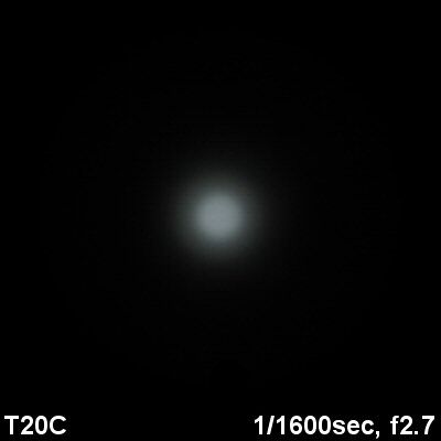

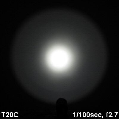

    Which brings us to the requisite white wall hunting . All lights are on Hi on 18650 (AW Protected where available), about ~0.75 meter from a white wall (with the camera ~1.25 meters back from the wall). Automatic white balance on the camera, to minimize tint differences.
    As you can see, a fairly typical beam for this size head. There are a few rings in the beam, but they are not distracting. Scroll down to my Summary Tables for more specifics on output and throw.
    To turn the light on in momentary-mode, depress the switch halfway. Fully depress the switch to lock-on in constant output. When the light is on, fully depress the switch to turn off the light
    To change modes (when the light is on), hold the switch fully pressed. Within a second or so, the light will begin to cycle through its output modes in the following repeating sequence: Lo > Med > Hi. Release the switch to select the desired mode.
    Light has memory, and retains the last mode selected next time you turn on the light.
    Strobe mode is “hidden” – do a quick double-full-press of the switch to enter strobe. Turn off the light to exist. There is no memory for strobe (i.e. always comes back on at your memorize constant output level).

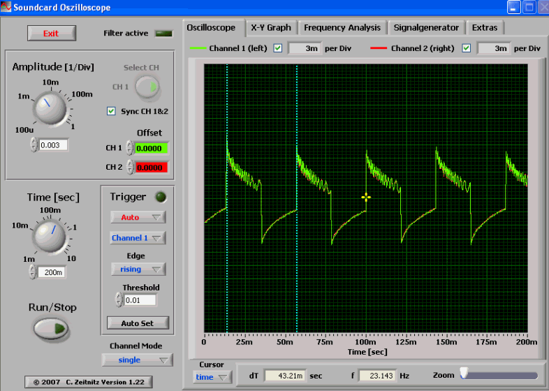

    No PWM
    I was unable to detect any signs of PWM with my setup. This suggests the light is current-controlled, or it uses a PWM freq beyond my ability to detect. Either way, nothing to worry about visually.
    Strobe
    Measured at a very high 23 Hz in my testing.

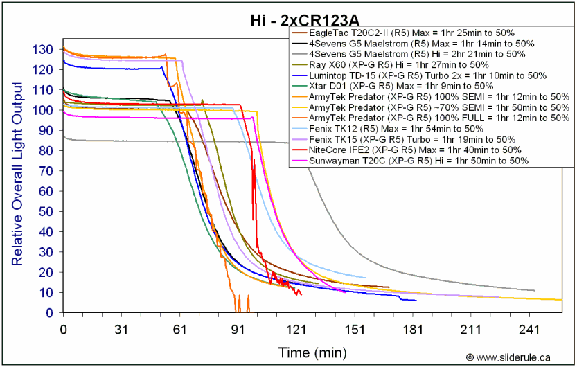

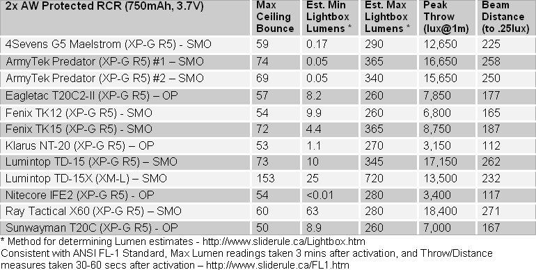

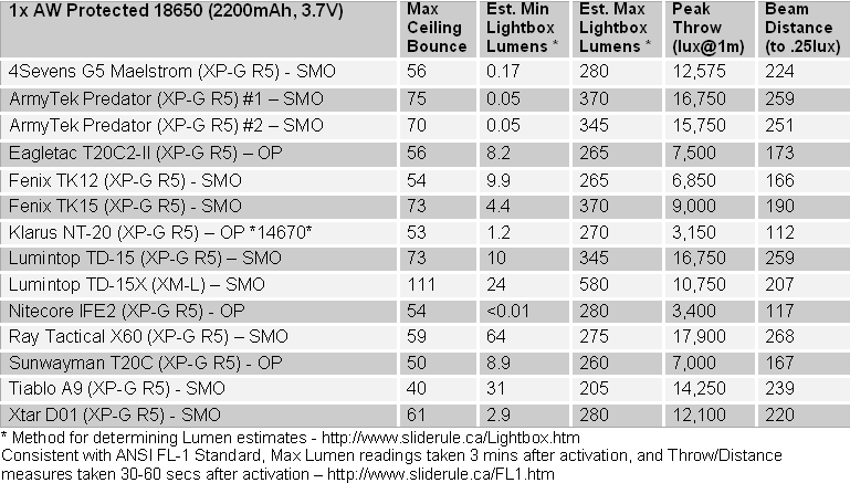

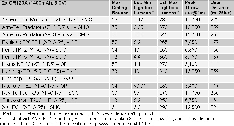

    The max output and throw of the T20C are quite reasonable and consistent with its emitter and reflector design.
    UPDATE: Again, this review is based on an early engineering sample of the T20C, which contained the Cree XP-G R5 emitter. Sunwayman has decided to go with a XM-L T6 emitter in the shipping T20C. You should therefore expect greater max output and less throw from the XM-L emitter version (given that the build seems otherwise the same). Runtime is hard to know, but I've noticed on other XM-L based lights that they don't typically seem to be any more efficient than XP-G lights, at lower drive currents.

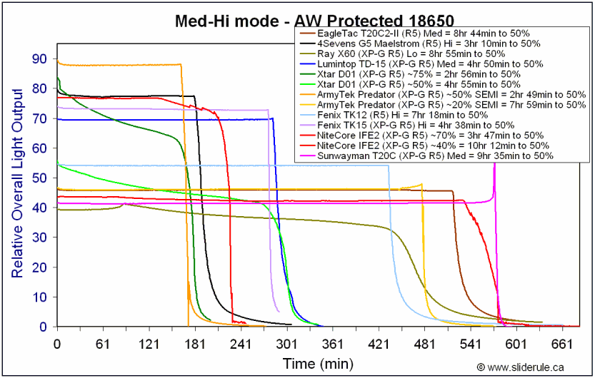

    Output/Runtime Comparison:
    No surprises here – the overall output and output/runtime efficiency for the T20C are quite in keeping with this class of light.

    After the tailcap has been removed, will the inner tube be moved toward the head when the inner tube is pressed with finger?
    In other word, is the inner tube movable or fixed?

    After the tailcap has been removed, will the inner tube be moved toward the head when the inner tube is pressed with finger? In other word, is the inner tube movable or fixed?
    A good question - the inner battery tube sleeve is movable, not fixed. There seems to be some sort of spring-mount in it, as you can move it with you finger. I hadn't thought to test that before, but it does help explain how the switching works in the tailcap.

    Default Re: Sunwayman T20C (1x18650, 2xR/CR123A, XP-G R5) Review: RUNTIMES, BEAMSHOTS +
    Thanks!
    Is it possible that the spring is connected between the frond end of the inner tube sleeve and the negative copper ring of the circuit board (to act as both the conductive path and the buffering mechanism for switching action)?
    Quote Originally Posted by juplin View Post
    Certainly possible - that in fact seems most likely to me. since the head doesn't open, you would have to check with Sunwayman for specifics.

    So Selfbuilt, it is very interesting to learn that we are getting more efficient with less energy loss, and therefore more powerful emitters, however because the LED die emitters are larger in size, it requires a much larger reflector to achieve the same throw distance.
    Well, that's not absolute - the issue of emission angle is also critical, not just die size. But XM-L emitters are quite a bit bigger than XR-E, XP-E or XP-G, so it is clearly going to be a major factor.
    (1) At the end of the day, this Sunwayman T20C with XM-L T6 is brighter @ 438 lumens, but it throws a shorter distance than Sunwayman's own M20C R5? Is that right?
    Likely yes. I would have to measure the XM-L version to be sure, but in my experience the increased output of moving to XM-L cannot overcome the drop in throw (when keeping the optics the same).
    (2) Do you prefer the T20C's all clicky switch only, or do you prefer the M20C's traditional combination of clicky switch combined with a magnetic ring?
    There are advantages and disadvantages to all methods. But I personally quite like Sunwayman's magnetic control rings.
    (3) I know from your reviews that the Jetbeam RRT-2 R2 out throws a Sunwayman M20C R2, but how does the newer RRT-2 R5 compare with the T20C T6 in brightness and in throw? The T20C with the XM-L T6 is brighter but shorter in throw?
    The degree of uncertainty increases as move across lights, models, reflectors, drive levels, etc. I can't really answer this without directly measuring everything. But my experience with lights of this size tell me that the T20C with an XM-L will likely not be a great thrower. Check out my Thrunite Scorpion review for an example of the XM-L in a traditional size reflector.
    Full list of all my reviews: flashlightreviews.ca. Latest hobby: whiskyanalysis.com. Latest flashlight review: Thrunite TN42.
    Well, we have a good "natural experiment" in the Lumintop TD15/TD15X. Lumintop kept the build the same as they went from the XP-G R5 TD15 to the XM-L TD15X (i.e. same reflector).
    The XP-G R5 TD15 has estimated ANSI lumens of 335 in my lightbox, and beam distance of 259m.
    The XM-L T6 TD15X has estimated ANSI lumens of 750 in my lightox, and bem distance of 243m.
    So, in that case, despite a huge increase in output, throw actually drops. FYI, my outdoor beamshots (linked in those reviews) shows the throw drop to be subjectively worse than the numbers indicate (which are based on lux at 5m).
    The Thrunite Scorpion is more in line with your interests, and it has a ANSI estimate lumen count of 460 in my lightbox, and only 167m beam distance.
    Those numbers should put it in perspective for you.

    Meanwhile, the Sunwayman T20C's "hold down" the tail end for low, medium and high, and "click twice" for strobe is the finest in tail end switch design!
    In my opinion, all flash lights should have both the RRT-0's magnetic ring and the T20C's tail end switch combined!
