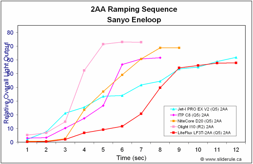

    Ramping Comparison:
    For the lights that have a continuously-variable interface, I have presented their ramping sequences above. The JetBeam Jet-I PRO EX V2 has a longer ramp than the Nitecore D20 (or D10, shown for reference) and ITP C8.

    NiteCore D20 (Q5):
    • Nitecore's continuously-variable lights use PWM, but at a high enough frequency that I cannot detect it with my setup or see it by eye (Nitecore claims >1 kHz).
    • Beam profile is revised from earlier D10/EX10 Cree lights, with a deeper reflector that produces a less defined hotspot with less Cree rings (i.e. more SSC-like in its pattern).
    • Like the popular NiteCore D10/EX10 series, the D20 uses a piston-drive ("Smart PD") coupled with a continuously variable brightness mechanism that is visually linear across its ramp.
    • The light can be used in both a tactical manner (i.e. momentary on) and forward-clicky-like manner (i.e. fully tightened, press-and-release to activate).
    • Piston drive design has been updated from the earlier 1AA/1xRCR versions, and now has a fully-functioning lock-out feature. Note that the pressure required to activate the light is stiffer than a typical clicky switch.
    • Overall build is sturdier than original D10/EX10 - the D20 is one of the heaviest 2AA lights in this round-up (consistent with Nitecore's attempt to make this more of a "duty light").
    • Comes with a removable bezel-pointing pocket clip, similar to the new D10 clip (secured with two torx screws, allen key included).
    • Lubrication of the piston o-rings causing "sticking" remains a known potential issue (i.e. too much applied, and too thick). Minor adjustment/lubing of the spring/contact ring in the head may also be required if intermittent contact issues arise.
    • For a lot more info, please see my Nitecore D20 review here.
    • Bottom line, an impressively-built light with a powerful yet elegant feature set (although there can be a few issues with lubing and piston resistance).
    • Sample was provided by Nitcore for review. Light retails for ~$70.

    Olight T25 (Q5) - 2008 Model
    • Like Fenix, Olight uses an efficient current-controlled circuit for its various output modes.
    • The regular version has 5 distinct output levels controlled by the head switch (i.e. loosen-tighten twist). Switching sequence is from Min to Max output, in a continuous loop. Light has a memory mode retaining the last level used. Light also has a high brightness rapid strobe, and a high and low brightness SOS (strobe/SOS modes accessed by rapidly clicking on the tailcap).
    • In contrast, the Tactical T25-T has only 3 output levels (basically levels 1, 3 and 5 of the regular version), also in a Min to Max sequence, with the tactical strobe and SOS mode following in the switching sequence. The reason for the interface change comes from the forward clicky, which allows for momentary-on and press to lock-on.
    • The only build difference between the regular and Tactical versions is the tailcap, which is a bit longer on the Tactical model, with a switch/cover that protrudes further due to the forward clicky.
    • Max output of the regular version T25 is not as high as some lights, but Tactical version is closer in output to the most heavily driven lights.
    • Output/runtimes were generally excellent across the range of outputs, with equivalent efficiency for the the two models (which are generally comparable to Fenix).
    • While the lowest setting is not as low as the PWM-based competition, it is one of the lower ones out there for current-controlled lights.
    • Max throw is among the highest of the 2AA lights.
    • Olight doesn't use their original two-stage reflector on these lights - the reflector is fully textured.
    • Build quality is very high. Lights have a very substantial feel, a bit bulkier than the Fenix models, but with very similar overall build quality (maybe even a touch higher).
    • Reverse clicky tailswitch on the regular version doesn't allow tailstanding, unfortunately. Of course, the forward clicky on the T25-T won't tailstand either.
    • Anodized tailcap threads allow for lock-out.
    • Olight is often regarded as a Fenix-clone with a revised interface and sturdier build. And what's wrong with that? The T25 and T25-T are strong contenders in this class. I would choose between the two of them based on your preferred interface.
    • Lights were provided by batteryjunction.com for review. Lights retail new for ~$70-80.
