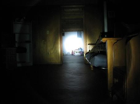

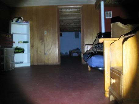

    The P7's beam is the most impressive I've ever seen from a flashlight! It can be focused down to a spot to give incredible throw, or defocused so that it is 100% flood. Here are some beamshots to illustrate this:
    Coast P7 Spot
    Coast P7 Flood

    Impressive beam adjustments. Nice pictures. Can you post some outdoor shots relative to one or more other lights?

    It seems that the intensity distribution in the beam pattern of Coast P7 Flood is not uniform, especially in the central region.
    Can you shot a beam pattern of Coast P7 Flood on a white wall?
    Thanks!
    Thanks!
    The beam is VERY smooth, but not 100% perfect. I'll take a white wall beamshot tonight so you can get a better look.

    Spot
    and flood
    compared to Romisen RC-N3. Not perfect indeed. P14 has nicer beam (especially 'flood').
