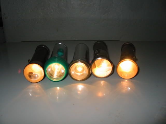

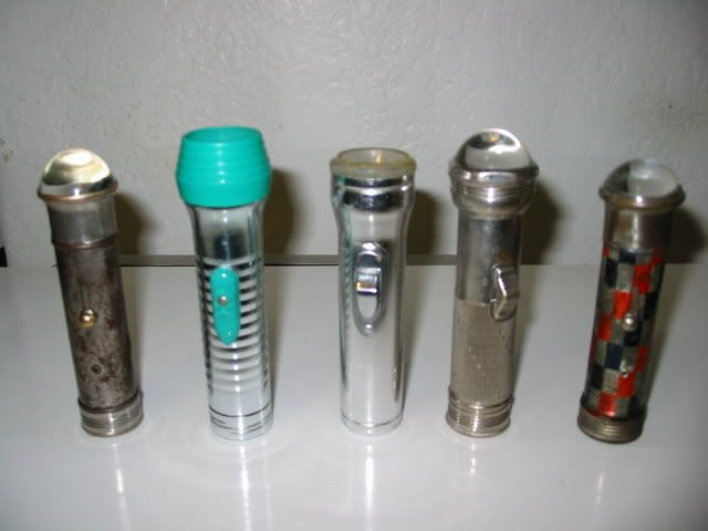

    Behold, the glory of the 2BF!
    Left-Right:
    My late father's old fisheye, circa late 1930s
    My childhood Hong Kong Eveready "Bijou" with PR globe (actually, one similar. Mine had a flared nylon bezel and a matching plastic tailcap. This is the later, "Bijou" model with metal tailcap.)
    One-piece Hong Kong "VK E110"
    Modern Fisheye (no-name Hong Kong brand)
    Franken-Fisheye, assembled from parts of four different donors!
    Here they all look dim and yellow, that's because they are competing with the camera flash. In real life, I had to take this photo with my eyes shut.

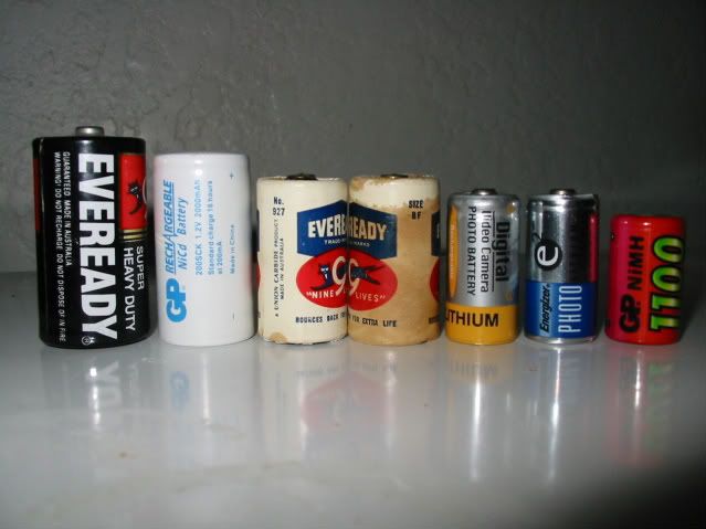

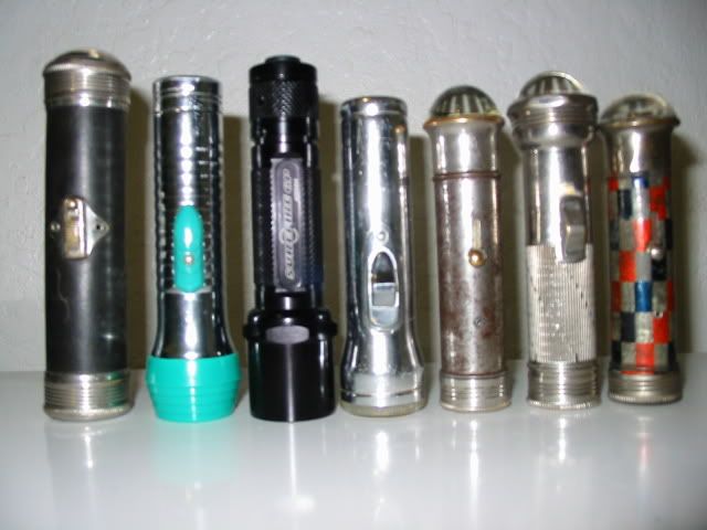

    Size Comparison:
    Showing a Surefire 6P for size reference. And on the far left is a cardboard Eveready 2xC fisheye torch, circa 1914.
    Now to describe the batteries, and put them in context:
    From left - right:
    C cell
    Sub-C cell (flat-top)
    pair of BF cells (Eveready 927)
    16340 (aka "RCR123", unprotected)
    CR123A
    2/3 A cell (flat-top)

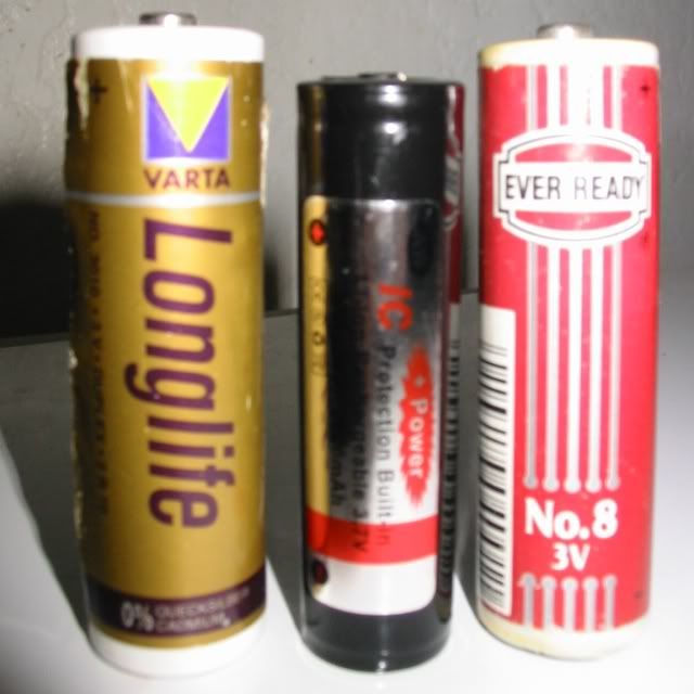

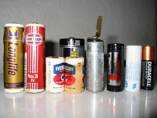

    And again:
    From left-right:
    Varta and English Eveready No.8 batteries (2xBF unit cell)
    B cell (taken from a dead Eveready 703)
    Protected 18500 lithium
    A cell (tabbed NiCad)
    AA cell
    A D cell is behind the B cell for height comparison.
