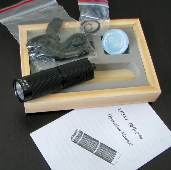

    The LiteFlux packaging is similar to older LF series, and comes with a nice wooden presentation box. Package contains a manual, wrist strap, spare o-rings, and lube. The wrist strap seems to be of fairly high quality, and is a nice addition.

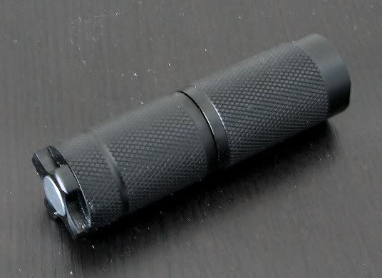

    The two-stage body design is fairly compact for a 1xCR123A/RCR light, and features a deep reflector and programmable clicky (scroll down for detailed pics).
    Weight: 56.7g
    Length x Width: 80.7mm x 23.0mm
    Fit and finish is excellent on my sample - lettering is very clear and sharp, and the black type-III hard anodizing is flawless. Labels are kept to a minimum (although I’ve personally not crazy about Liteflux’s stylized italics font).
    The knurling is improved over early LiteFlux lights, where it was more for decoration - although still not overly aggressive here, it does help with grip. I do find the four protruding corners of the base a little sharp, and could stand to be rounded further.

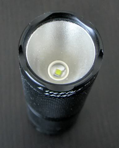

    The light uses the common Cree Q5 emitter, since R2s remain frustratingly hard to get in volume. All lights use premium cool white emitters, but LiteFlux dealer LED Cool may be able to select relatively warm/cool tints for those who are interested.
    Reflector is deeper than most 1xCR123A/RCR lights, and is very finely textured - to the point where it appears like a fine haze over the reflector surface. Fairly unique to LiteFlux, this appearance actually reminds me a bit of my DIY sputtering jobs (although far more consistently applied here, of course). Scroll down for beamshots.

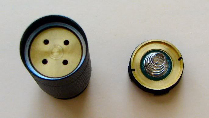

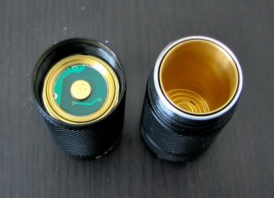

    Build of this light is different from most. Since it uses a MCU in the head, a separate current path needs to be provided for the modes to work reliably. Like the LF5XT, there is a brass sleeve that the battery sits inside, which connects the tailcap switch to the retaining ring in the head. A good comparable would be the Novatac lights, where this is done with a spring that runs around the battery.
    Although it may look similar to the NiteCore "Piston Drive", the LF3XT still uses an actual tailcap switch underneath the battery sleeve. But the switch is not your typical clicky - it is more like those found on modern electronic devices. A good way to describe it is like the on/off button on your LCD monitor, as compared to the traditional clicky switches found on old CRTs. The feel is actually more similar to the Novatac series lights, but with less tactile feedback on my LF3XT sample.
    The screw threads are anodized on the body tube, so lock-out is possible.
    Note that unlike the LF5XT, the battery sleeve doesn't appear to be user-removable - it doesn't seem to want to come out on mine at any rate, and I don't plan to force it.
    UPDATE JANUARY 13, 2009: Seems like the battery sleeve can come out - you need to unscrew the tail retaining plate (using a small screwdriver in the lanyard hole, and turning counter-clockwise from the body tube). The battery sleeve then falls out of the back-end of the body tube.
    The switch can also be disassembled from the tail retaining plate, using a pair of fine tweezers or snap-ring pliers. Here's what you'll find inside:

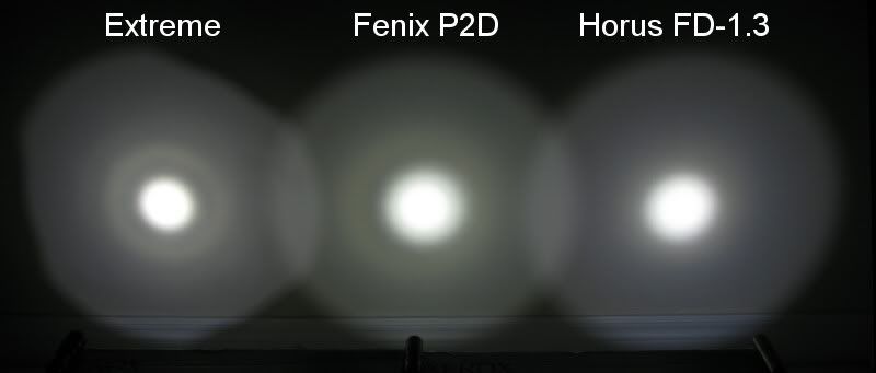

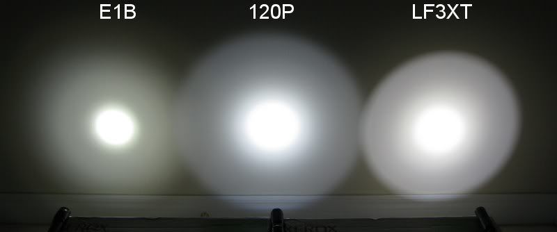

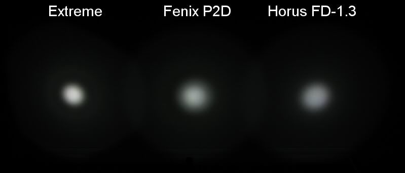

    Comparison Beamshots
    All lights are on 100% on AW RCR, except for the Surefire E1B which is on primary Duracell CR123A. Distance is about 0.5 meters from a white wall.
    1/25sec, f3.2
    1/100sec, f3.2
    1/800sec, f3.2

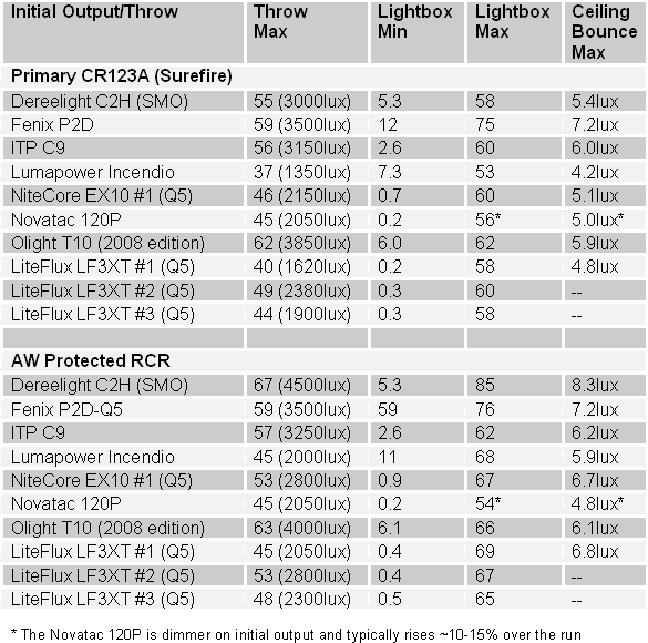

    As you can see, the beam profile is very distinctive on the LF3XT - you have a much narrower (but brighter) spillbeam than most lights, thanks to the deeper reflector. Cree rings are also greatly reduced, and the hotspot is a little broader than most lights. Frankly, I find this profile to be a lot more SSC-like than Cree-like. Tint on my sample is quite warm, which I personally like (I asked LED Cool to select a warm tint).
    Testing Method: All my output numbers are relative for my home-made light box setup, a la Quickbeam's flashlightreviews.com method. You can directly compare all my relative output values from different reviews - i.e. an output value of "10" in one graph is the same as "10" in another. All runtimes are done under a cooling fan, except for the extended run Lo/Min modes which are done without cooling.
    LF3XT’s peak throw is toward the lower end of my 1xCR123A/RCR lights, but that's not necessarily a bad thing for an EDC (it is pretty comparable to the Novatac or Incendio).
    Max overall output is fairly typical for a light this size, and consistent with the reported 700mA driving current (there are larger lights that are more heavily driven). Low output is particularly impressive - on primary CR123A, the LF3XT can actually go as low as my Novatac 120P. This is even lower than the LF5XT.
    UPDATE: With the receipt of the extra 2 samples, I've added their output/throw results to the table above. As you can see, there is no real difference in terms of overall output. However, throw varied a bit - one new sample had ~10% more throw than the original, and the other had ~20% more throw. I suspect this is due to slight differences in how well-focussed the samples were set in the factory.

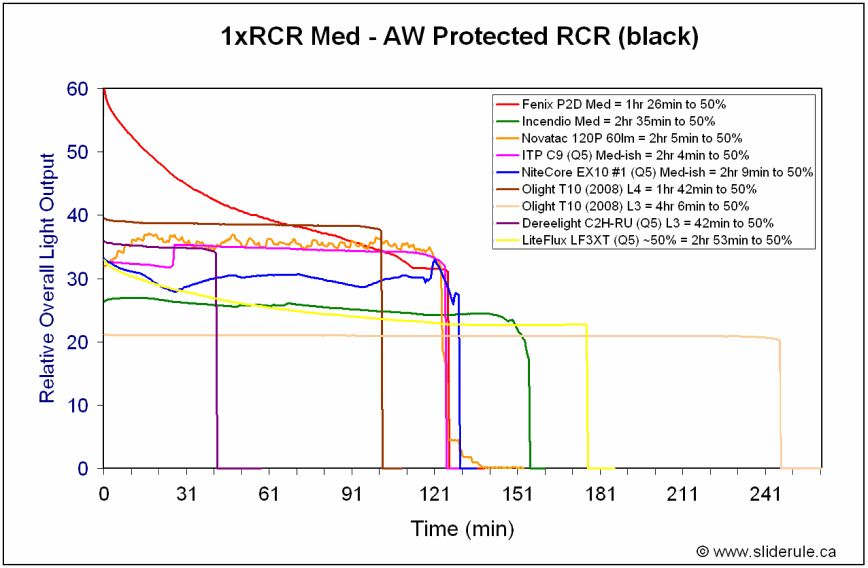

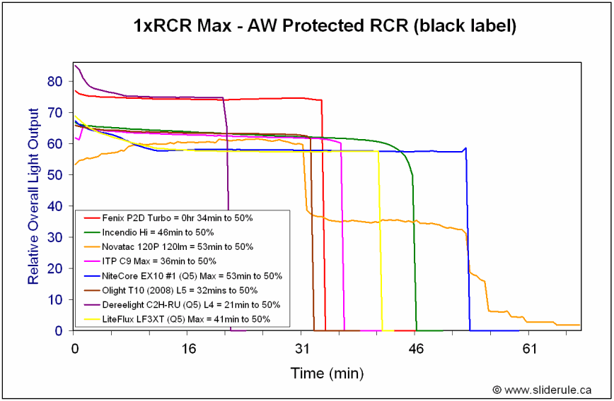

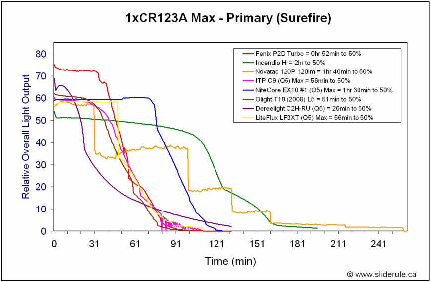

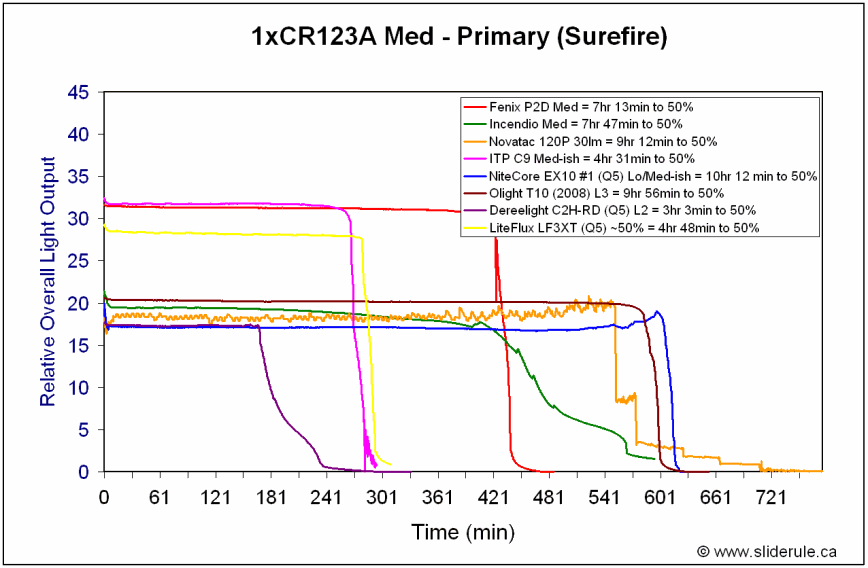

    Output/Runtime Comparison:
    Output/Runtime Comments:

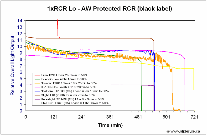

    Max output and runtime pattern are remarkably similar between the LF3XT and the Nitecore EX10 - although my EX10 sample has longer runtime on max. I suspect this is largely due to variation in Vf, so YMMV.
    On the lower outputs, the LF3XT tends to have a slight runtime advantage on RCR, but is less tightly regulated than some of the other lights shown here. I haven't done as many lower mode CR123A runs, but performance is definitely in keeping with the competition so far.
    In summary, no major surprises here - the LF3XT performs pretty much as I would expect for a continuously-variable light.
    UPDATE: To see the runtimes of the two new samples, see post #2. Frankly, I've very impressed at how little variability there was in output or runtime.

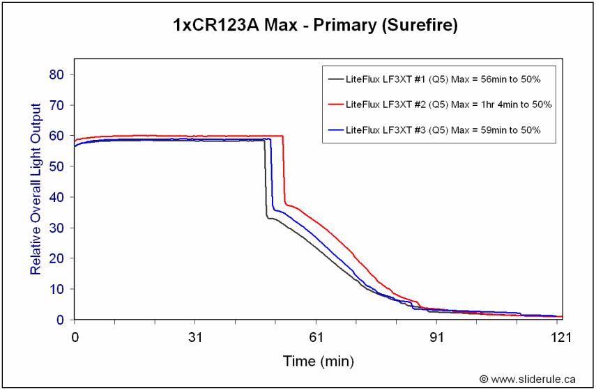

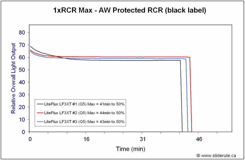

    UPDATE February 6, 2009: The 2 replacement samples have arrived, and summary results have been added the main review in post #1. I've done several runtime tests, and show the comparison results below:
    I cannot believe how little output/runtime variability I'm seeing here! Recall those are traces from 3 different lights.
    Of course, I've used the same RCR cell for all tests, and Surefire batteries from the same lot for the primary runs, to try to minimize my variables. But honestly, I typically get at least that much variability when I re-run the same light in my lightbox repeatedly.
    I'm very impressed that 3 samples of the LF3XT could produce such extremely good concordance on 4 different battery/output configs.

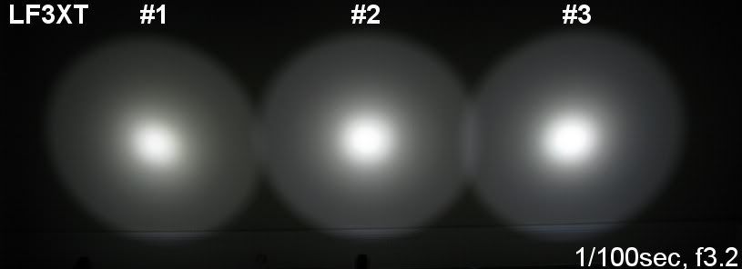

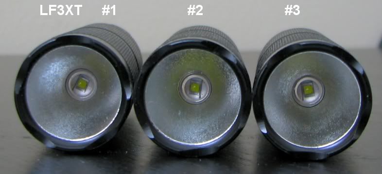

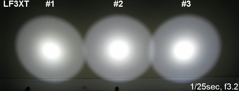

    One area where the 3 lights differ is in how well focussed the reflector is. Here are some detailed comparisons:
    As you can see, there is no great difference in the beam patterns. However, my lux meter shows that the replacement samples have ~10% and ~20% more throw than the original.
    Here is how the front ends look:
    Again, there is no great difference here. Upon examining the lights individually, it looks to me like the light with the greatest throw has the emitter slightly less recessed into the reflector than the others. Again, the difference is slight, and well within the variability I would expect for a manually-adjusted feature during assembly.

    Selfbuilt, thank you for the excellent review! It was long awaited and there is no disappointment in waiting for it.
    There a couple of things that I think need to be mentioned. First of all, the LF3XT has eliminated the turn on delay that was present in the LF5XT. It comes on instantly. There IS a 0.3 sec delay when the light is turned off or when changing levels, which is a necessity with a light of this type because it doesn't know if you are going to be issuing 1 click to turn off the light, or multiple clicks to do some other operation. It needs to wait to see what you are going to do.
    While perhaps it need not be mentioned, since it was a feature of the LF5XT, a very useful function on the LF3XT is its battery voltage reporting. I am not sure how many other makers have this feature on their lights, but I ams certainly pleased that LiteFlux thought to incorporate this valuable feature. I am never caught by surprise that my battery needs changing since the report is a test of the battery under actual load conditions.
    With regard to a reviewer spending his own hard cash for a light, I believe the review can be more biased as you said in favor of the light if the reviewer really likes the light. He may be rationalizing his wise purchase decision. However, if the light is disappointing and he feels his money is wasted, he can be more direct in his criticism than he might be had a maker or dealer sent him a free lights to review. Considering you had a sample failure, and your review is still ovrall very postitive, speaks lots about how you much you seem to like this light. I hope your replacement works as flawlessly as mine has.
    Finally,It is unfortunate that small manufacturers like LiteFlux come out with a great product and do not get the notice or sales they deserve. Until people with your stature and experience review the product, few believe a little maker can even stand in the shadow of the big name makers who get big sales numbers often on hype or expectations alone. I am thrilled with my LF3XT and have been quite vocal about it in order to spread the love around. While I believe people are beginning to take notice of LiteFlux it seems to have taken a while. Again thanks for your great review! It helps a lot.

    Both good points, thanks for the addition. One of the main reasons why I like to post my reviews here on CPF (instead of on my static website) is for the ongoing discussion that ensues. The developing thread really helps expands upon the review, and helps put it in context.
    A good point - I think that is a natural tendency (and one I try to guard against ). I try to be measured in my criticism of any light, since someone's livelihood is involved. At the same time, my main goal is to provide as unbiased an evaluation as possible, so members here can better decide for themselves how to to spend their own hard-earned cash.
    Given how LiteFlux & LED Cool handled previous issues with the LF5XT launch, I'm confident any problems that may crop up here will be delt with satisfactorily.
    Finally,It is unfortunate that small manufacturers like LiteFlux come out with a great product and do not get the notice or sales they deserve. Until people with your stature and experience review the product, few believe a little maker can even stand in the shadow of the big name makers ...
    I appreciate the compliment, but I doubt my reviews have that much impact. I've reviewed some interesting lights where there has been almost no interest or response in the thread. It seems to me having an active posting presence here by the manufacturer (or one of the respected high profile CPF dealers) is really a key factor in generating interest - assuming the light itself has merit.
    There's nothing I like better than seeing a manufacturer/dealer promptly deal with issues/problems raised by posters in these sorts of threads. It's the sort of thing that makes CPF such a great place to hang around.

    Default Re: LiteFlux LF3XT Review: RUNTIMES, BEAMSHOTS, COMPARISONS, and more!
    Thanks for the Review. I'm a little worried because it seems as more of these lights are getting into the hands of the customers we're hearing of more issues. I will say though the build looks first-class. While there are 4 raised sections on the tail there are 8 sharp corners.
    I think this was a good point. My only other LiteFlux is the LF5-XT and I must say the knurling on that really is just decoration.
