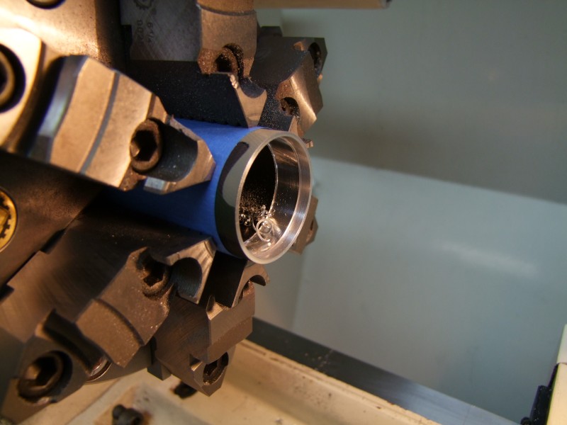

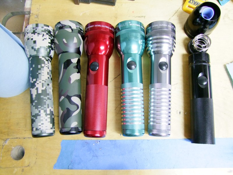

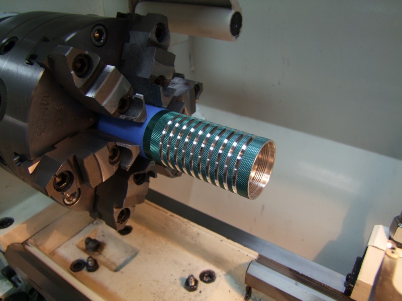

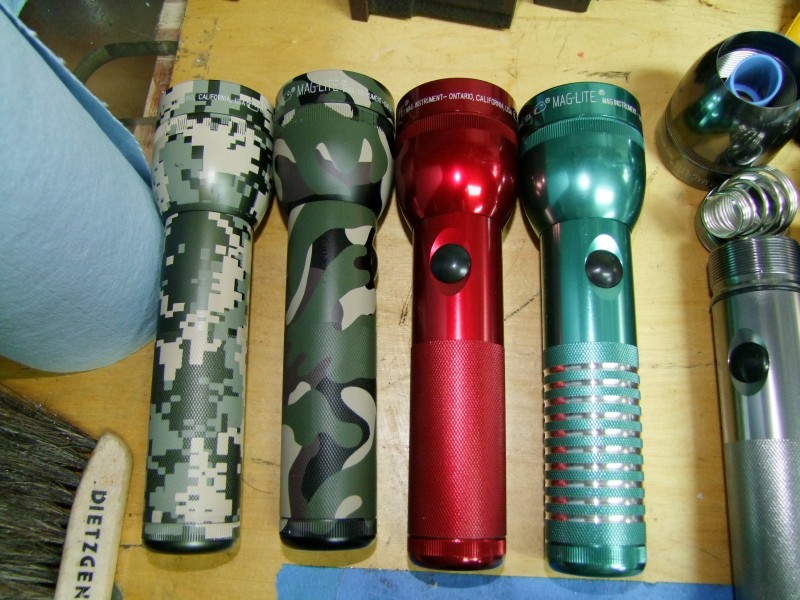

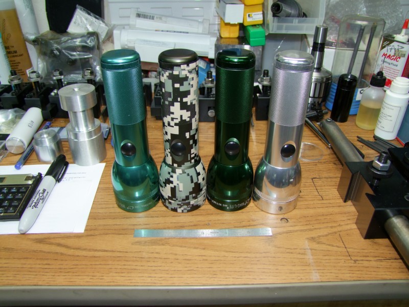

    3rdrock - The package is on its way to you ... Here are some additional pictures ...
    Checking the OL:
    Teal finished:
    Working on the Digital CAMO:
    All four bodies done:
    Working on the tailcaps:
    All done ready to ship:
    Will

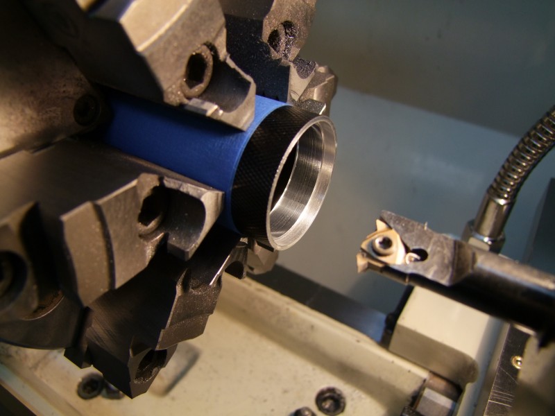

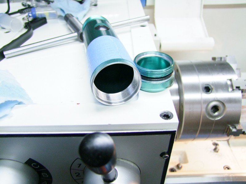

    Here is an update on your 6 hosts ...
    First the Digital CAMO:
    then the Regular CAMO:

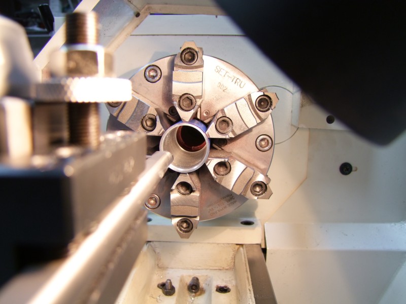

    the Red one (which is bored):
    threading the Red host after boring is done:
    Red is ready to go!
    So I have 3 out of your 6 completed. I am hoping by this weekend to finish the other 3
    Will

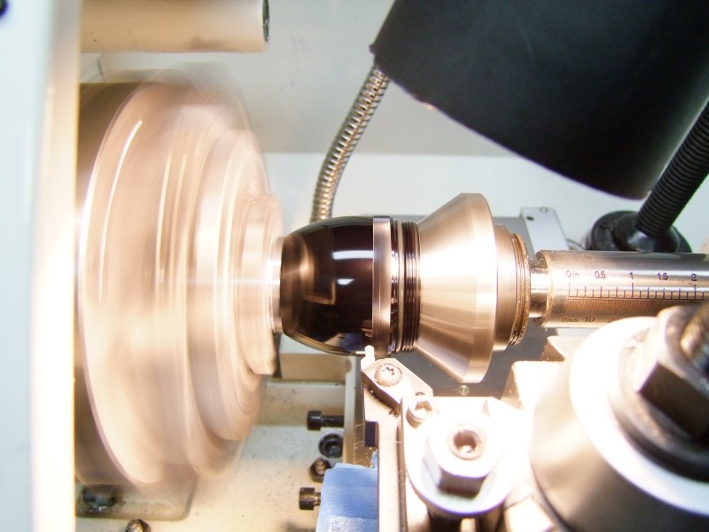

  10. #100

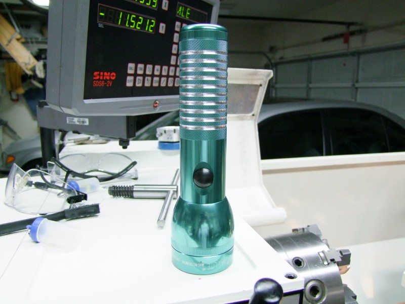

    nailbender, your Teal host, bored and with the handle grooved is ready:
    Two more hosts, and one 18650 adapter to go
    Will
  16. #106

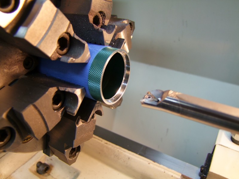

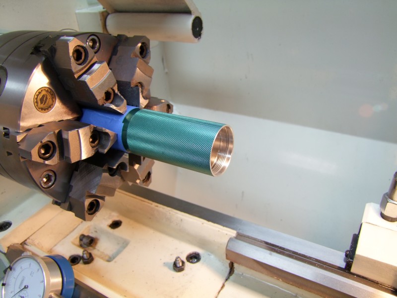

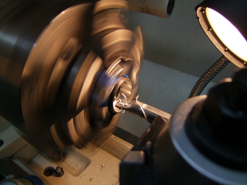

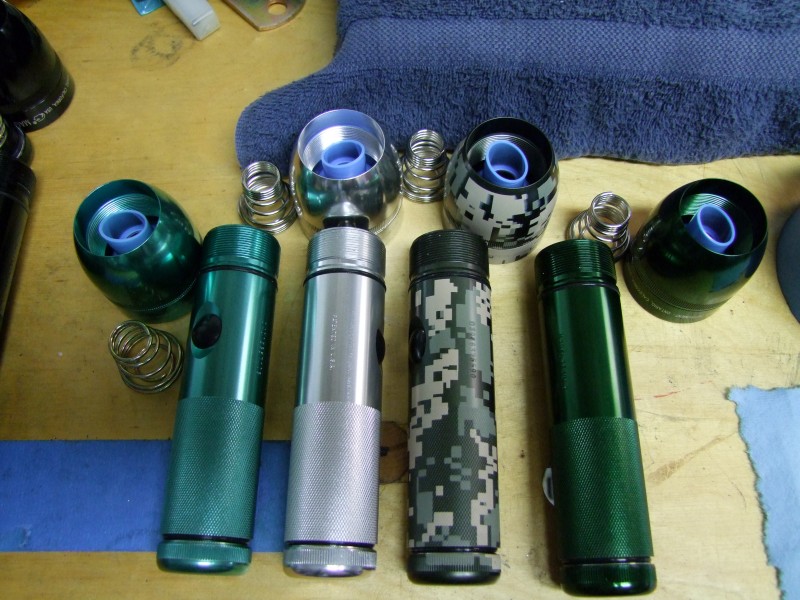

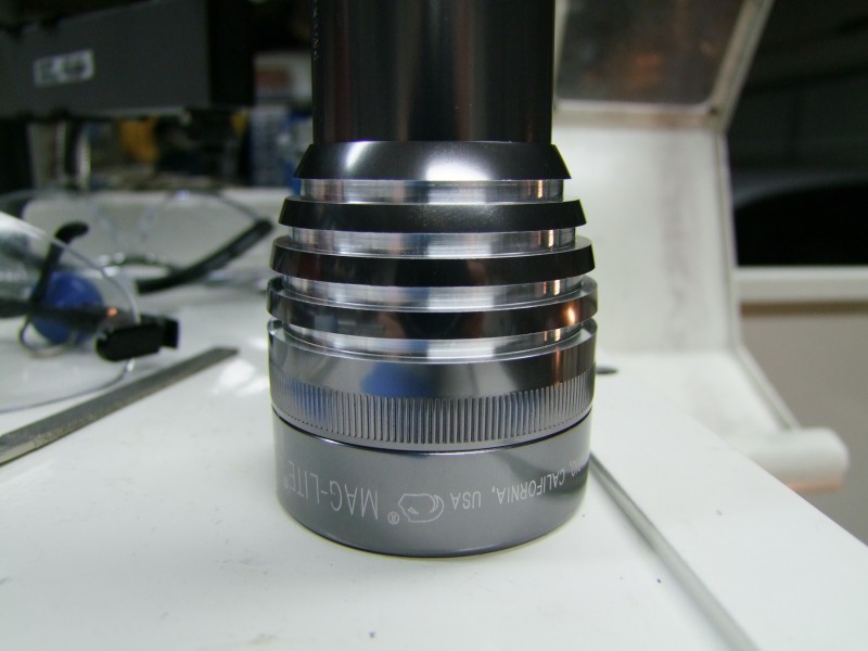

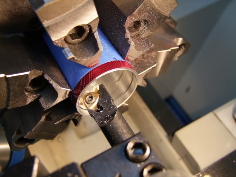

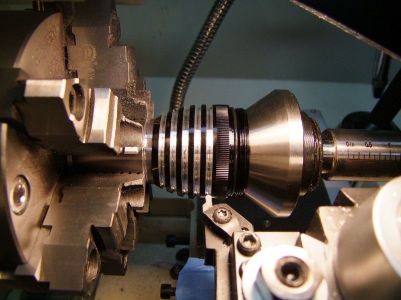

    nailbender, more progress tonight. Your Pewter (Dark Grey) is done!

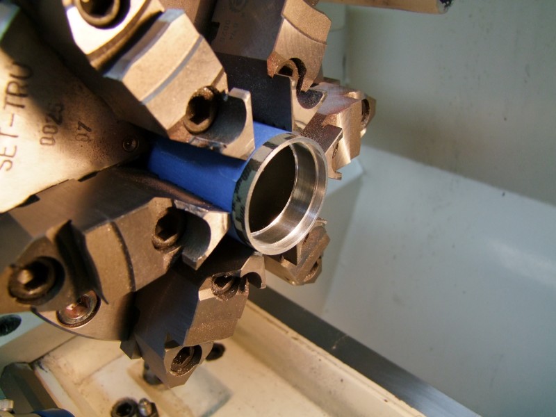

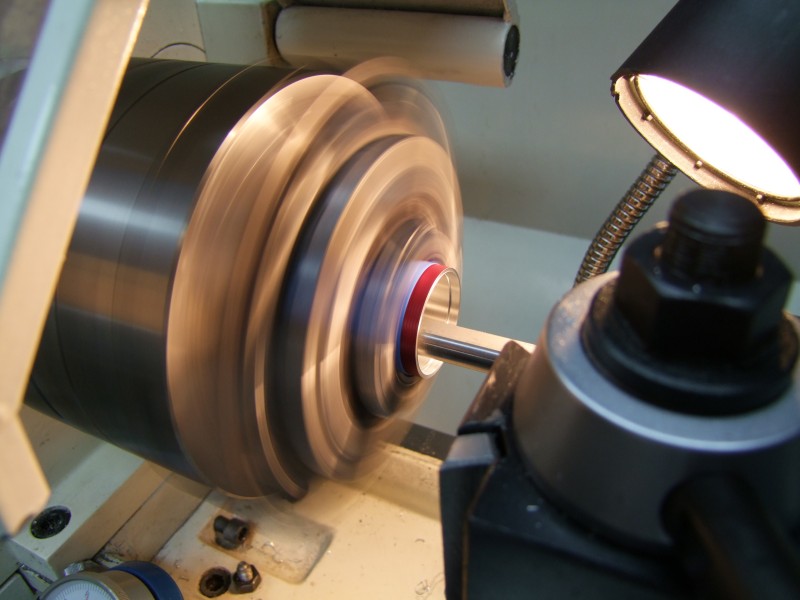

    Here I an boring the inside:
    By now, it is bored and threaded, and just finished with the body grooving:

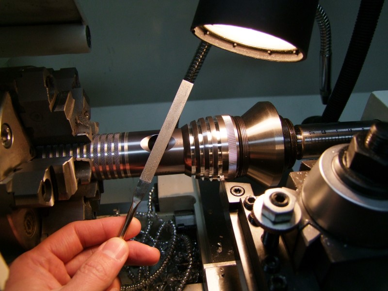

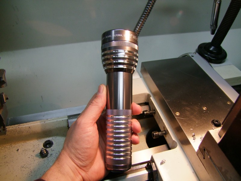

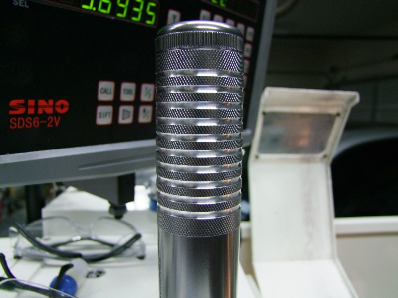

    Here I am finning the head with spacing fairly proportional to the grooves in the body, but these grooves are not rounded as you requested:
    and then I touched the edges with a file to softly round the sharp edges (the tool I used cuts at a sharp 90deg):
    Finished host:
    Work done so far for your order:
    One more host, and one 18650 adapter to go
    Will

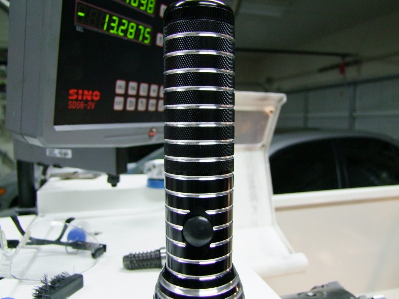

    I am also done with the black "special" host - photos tonight
    Will
  25. #115
    Enlightened ¿o_O?'s Avatar
    Nov 2008
    78
    Default Re: Custom Mag-1xD for sale - order placed!
    Thank you
    Will
    ~heart attack~ dies~
  26. #116
    Jan 2005
    Texas, USA, Earth
    8,180

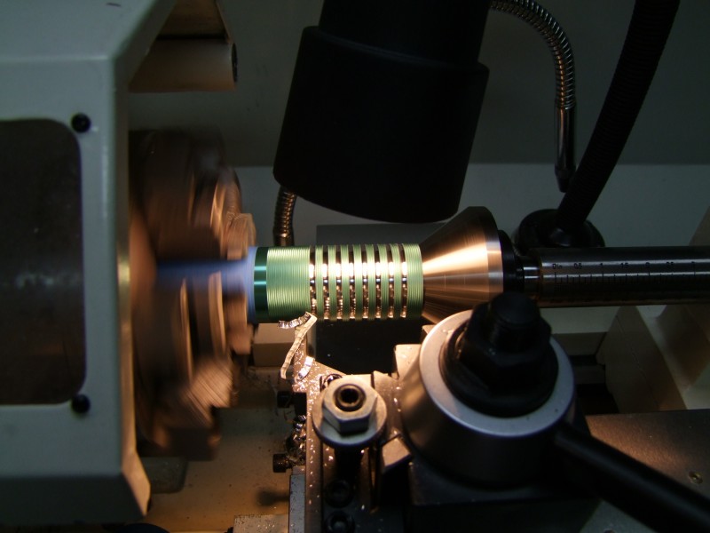

    Icon15 Re: Custom Mag-1xD for sale - order placed!

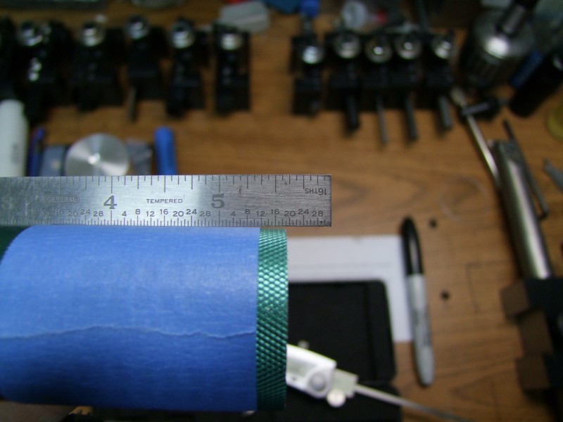

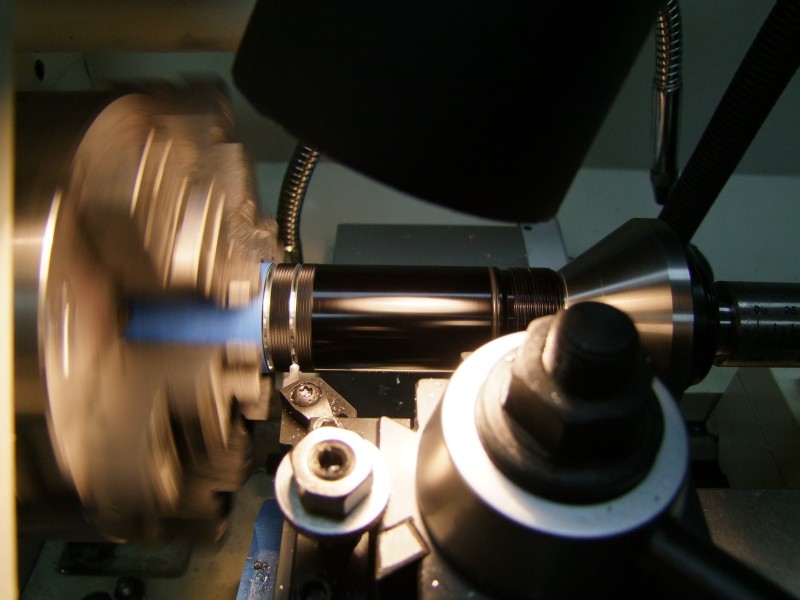

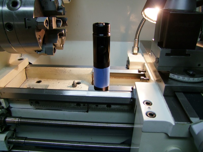

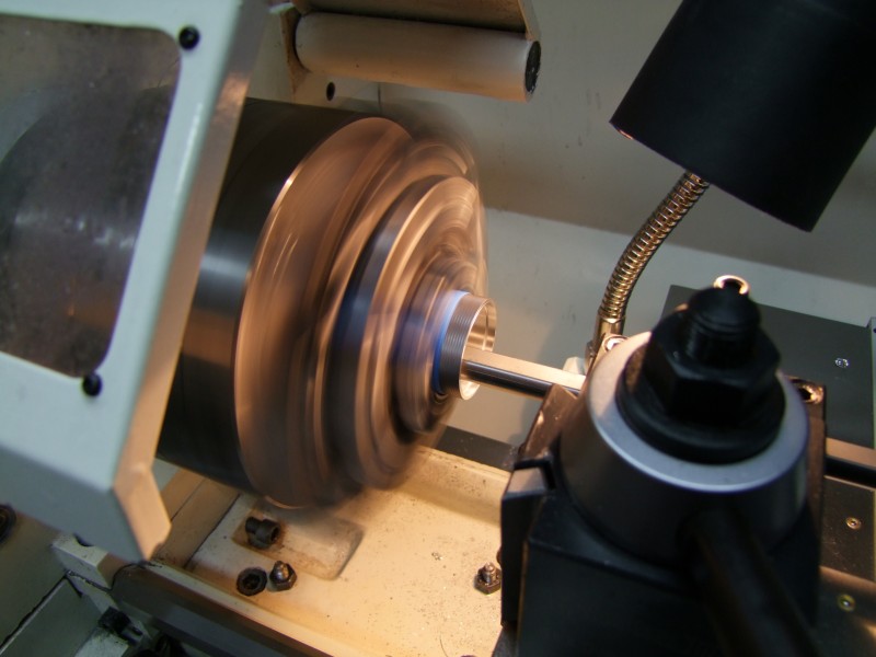

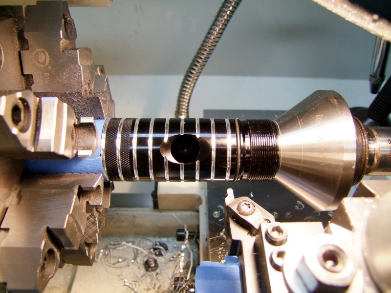

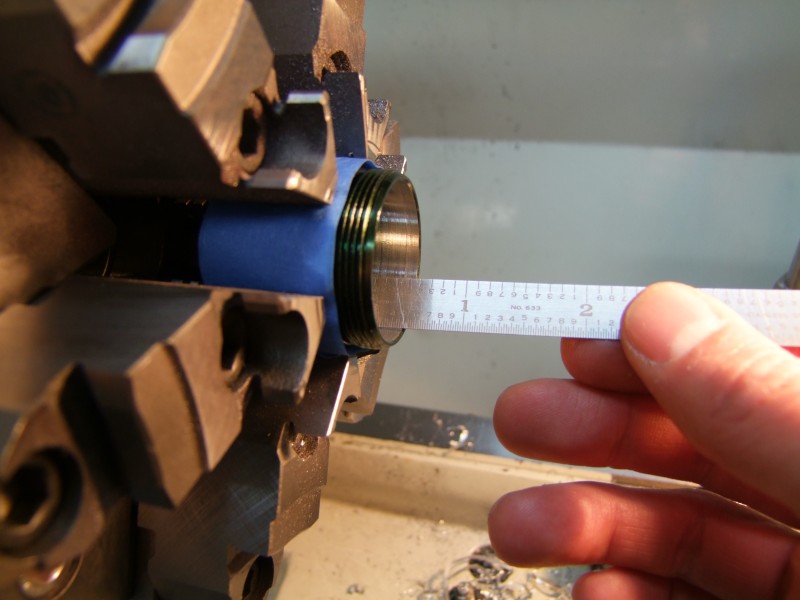

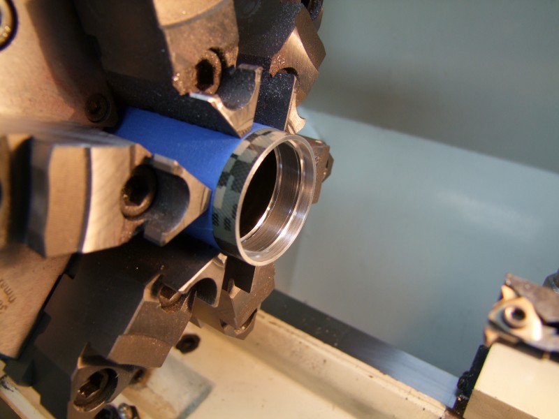

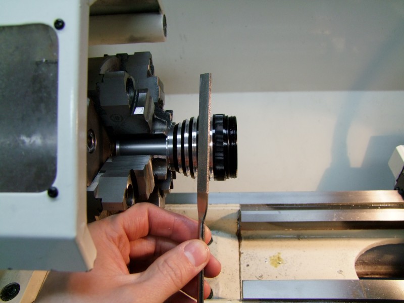

    Start by having a pic of the intended "target". And I say target since I have no idea of what tool(s) was used to create this one, so I am going to approximate as much as I can and use my own judgement as to what would look "right".

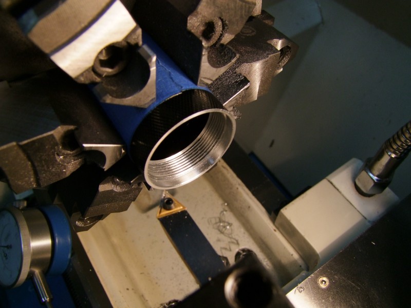

    OK, here it goes. Start with a cut black Mag "D" tube...
    Cut the area to be threaded:
    Thread (sound simple, right?):

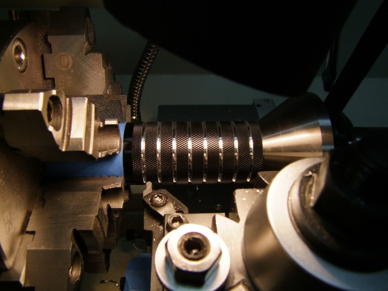

    I used a spare black tube to experiment with the cutting bit, the depth, spacing, etc., until I found something that looked good and similar to the picture/target:

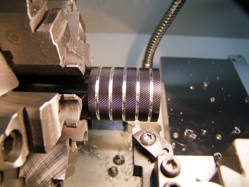

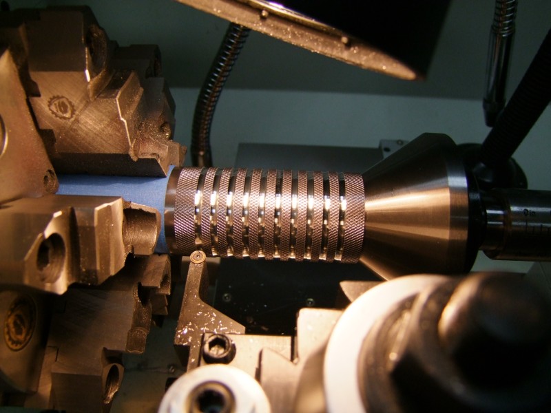

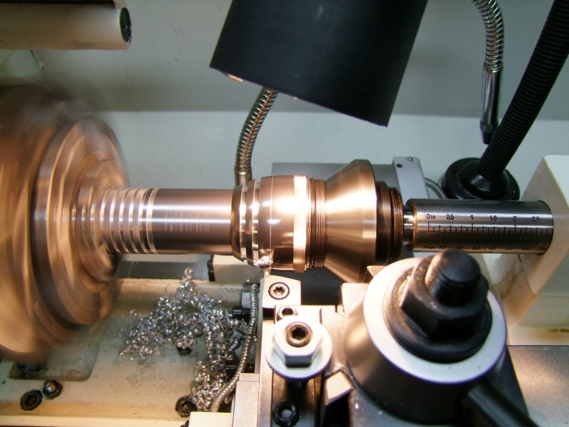

    Here I get ready to cut grooves on the actual 1xD:
    here I am done with the first part of the grooving:

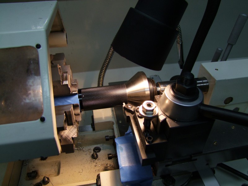

    I then have to turn the tube around, re-tape, re-align with a prior cut, and start cutting again:
    Here I am done with the whole body:

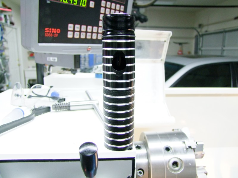

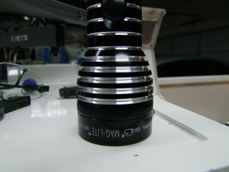

    Now getting ready to do the head:
    file the sharp edges:

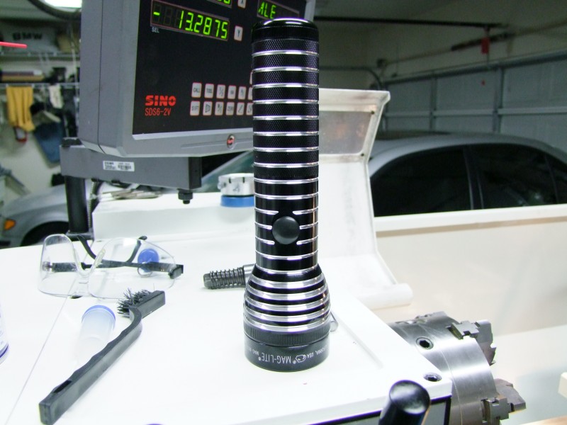

    and the complete "special" 1xD black host is ready:
    nailbender - I should be able to finish the 18650 holder tomorrow, which would then complete your order
    Will

    I like Brian's as well. I used a rounded-tip cutting tool, so each body end up with a slightly different look. In the end, you are the customer, so if you are happy, I am happy
