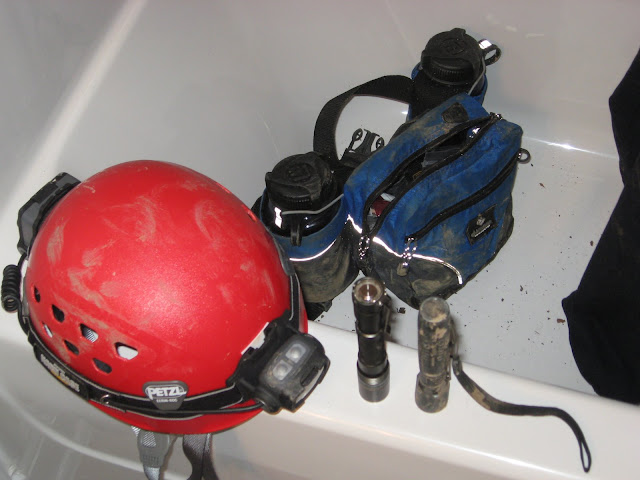

    It sounds like you have your light sources just about covered. Your three sources of light are helmet mounted capable, so that's good. Make sure to have enough batteries to last at least twice as long as the trip should last in every battery format you are carrying.
    I also recommend another small backup worn around your neck. A Photon Freedom or Fenix E01 type light works well. If you have cells that need changing, or something happens to your primary on your helmet, you'll need some quick source of light to fix it, or dig in your pack to get things sorted out.
    As long as the helmet has a working 4 point chin strap, it's just fine for horizontal caves. In horizontal caves, the helmet is just to protect you from bumping your head on the ceiling, which you will do quite often your first couple trips.
    If you ever get more serious into caving, you will learn what you want to upgrade to. Probably something lighter, and better breathing. I personally hate foam lined helmets in favor of suspension helmets, even though they are a tad bulkier.
    I have two skateboarding helmets for loaner helmets, mainly because I bought them cheap at a thrift store for 99 cents each. I personally use a Ecrin Roc.

    Marduke, is a pack like the one in your pic as big as one should take or will a small back pack be OK?
    Thanks, everyone, for the info. It's very helpful.
    *Flashaholic* Marduke's Avatar
    Jun 2007
    Huntsville, AL
    10,117
    Default Re: Caving light for first trip... and helmet advice?
    Quote Originally Posted by steveG View Post
    Pack size varies from person to person. People tend to pack way more than they need their first trip, especially flashaholics
    Most people will use regular backpacks, or purpose made caving packs. I've seen some use old surplus gasmask bags or something similar.
    I am currently using a $10 WalMart fanny pack that holds two .5L water bottles. It doesn't hold a lot, but I don't need it to for horizontal trips.
    What pack you use depends a lot on the caves you go through. If you are vertical, you need room for harnesses and ropes. If you do a lot of crawling, a pack that you can drag behind you is a good idea. Most prefer a bag with some level of waterproofness, I simply waterproof individual items inside my very un-waterproof bag.
    One thing is for certain. Don't use a backpack that has a lot of webbing, or other attachments on the back side that will easily snag when crawling or walking stooped over. The more clean looking the back side, the better. That's one reason I like a fanny pack for caving. I can simply turn it to the front when I have to crawl or walk stopped, so it doesn't get caught on the ceiling.

    I went on my first "serious" caving trip over a year ago, I hope to do it again someday, but am still recovering from a back injury and am always tight on time and money, someday I hope to go back to it and try it again.
    Here's some pointers I learned on my "new/old" experience:
    *Brightness is really more for fun and comfort. I found that a comforting reasonably bright incan really soothed me when negotiating tight crawls. The biggest danger in a cave for a "new" person to caving, is panic attack [read: claustrophobia]. I was able to keep myself in control by having the ability to "sooth" myself with a powerful incan that seems to "open" things up a bit.
    *For most activities, brightness is not important. The headlamp should have a low mode with a few lumens that you can leave on without any worry of running dry on batteries. I ran my Argo HP on low through most of the trip, with occasional flips to high mode, without any need to swap in a new battery. You will find that a few lumens are more than enough to do just about anything in a cave, more than that is convenience and comfort. High output is generally used in short bursts to get a feel for large areas or check out cool features of the cave. I actually brought 2 spare headlamps with me to start off the trip, and my good friend who organized and invited me on the trip wound up using one of those spares as his was dead from the get-go. That "spare" was a simple $20 LED job from walmart, and it worked just fine for him and works to this day.
    -As a flashaholic, I packed things along that impressed some very serious cavers that I went along with, they said they had not seen the cave in such detail before my flashlights came along with them. Powerful flashlights don't have to be big either. A nice wow light can be in the form of a 2xCR123 form factor, both incan and LED have options that are really bright in this size (500+ lumens). I would suggest bringing one just for fun and to show-off
    *I made the mistake of trying a "fanny" pack as my first cave trip primary "storage" solution. I was able to make it work, but there were many situations where I was removing it and dragging it through tight crawls. I think the ideal cave pack would be a PVC or other heavy duty plastic "dunnage" sack with a simple strap or 2, that you could alternate from being hooked on for dragging (like to your boots) or slung over the shoulder/neck when walking/climbing. Honestly, I bet almost every caver struggles with finding an ultimate solution to the storage solution, but holstering or hanging things from your person/clothing you will quickly find to be an annoyance as you will be rolling over on those things and getting tangled in them as you roll and position yourself in tight crawls/climbs.
    *I bought one of those Petzl Ecrin Roc helmets that Marduke has pictured above. They are very popular in the caving community for good reason. They are comfortable and convenient. However, you don't need to spend that kind of money if you don't want to. If I had to do it over again I don't think I would have bought one considering that I probably won't be spending a *lot* of time in a cave in my life. Anything with a chin strap that has some isolation between your skull and the outer later will work fine. Most hardware stores will have "hard-hat" construction helmets that will work reasonably well for under $10. The Petzl has some built in strap-hooks that make it possible to mount just about any standard headlamp to without problems. If you go with regular construction helmet or something like that, you may need to work out a solution for mounting the headlamp to it.
