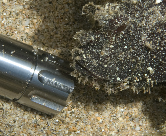

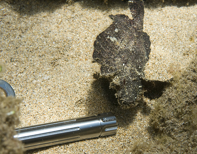

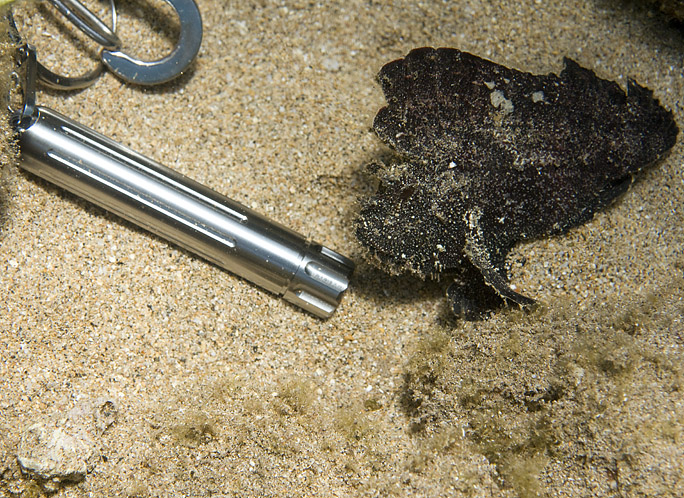

    Default Re: Help finding 1xAA or 1xAAA LED dive light
    9Speed,
    I discovered a pair of little Leaf Scorpion Fish yesterday when I was leaving the water. They are only 10-15' off the beach in a hole that may be 6' deep. This AM, I built the Sapphire I am going to send you for sea trials and I decided to get it wet myself first as well as see if I could get some better shots of the Leafs. The light also adds a sense of scale (size that is) to the fish.
    These guys are like miniature Frog Fish in a way.
    The fish was mildly curious about the light but its primary interest was in keeping an eye on me and hardly upset when I finally left it and its partner alone.
    I took the light down to about 15' and no issues with it at all. With good ambient light, this light is underwhelming but I could see its beam and in turn some color under some ledges which were black to the naked eye. Had to get close though! It might work OK for a modeling light for your camera in the nooks and crannies.
