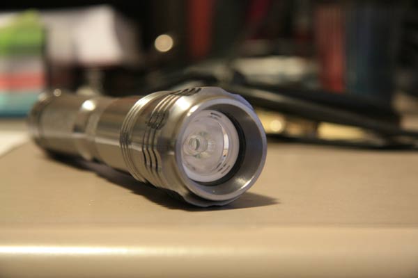

    The output from the original Intova was a little lacking at 70 odd lumens. Apart from that it is a solidly constructed dive light, and was used as my cray torch for use during the day.
    As the weather has not been the best, and I had a weekend without any water based activities planned, it is only natural to pull things to pieces, and see if they can be improved (seems to be a part of the NZ culture ).
    The result was a XRE R2 on a star being used to replace the original LED. The original driver was kept, as it was putting out 3.7 V @ 700ma.
    The whole modification involved grinding a little off the edge of the 19mm star to fit, and drilling the holes a little bigger to allow the wires to connect to the solder pads.
    I reused one of the original screws to hold down the star, and attach the green wire. FYI...no light comes out if the green wire is not connected
    The star also got glued in with thermal glue.
    I pulled out the original lens by grabbing it with a pair of long nosed pliers, and replaced it with a DX sourced lens.
    The final result exceeded all expectations
    The final result
    New lens glued in place. (you can see the required green wire here)

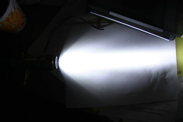

    A little spill, but mostly a tight 8 degree beam.
