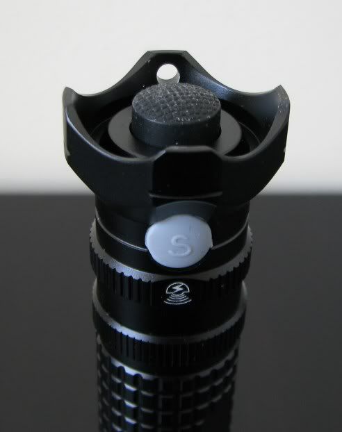

    • Side switch on tail cap for direct access to strobe from power-off and changing modes from power-on
    • Front & Rear removable strike bezel

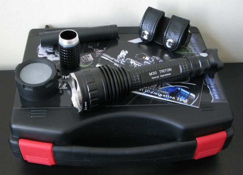

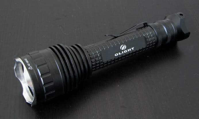

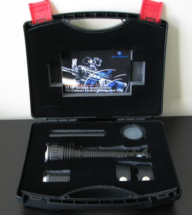

    Unlike most of the competition, the M30 Triton comes in a presentation-style case with a lot of extras. Inside the plastic carrying case, you will find cut-out foam that securely holds the light, battery extender tube, 3xCR123A battery holder, leather belt holster, and instruction manual. No extra o-rings or wrist-strap was included on my sample.
    With battery extender in place:

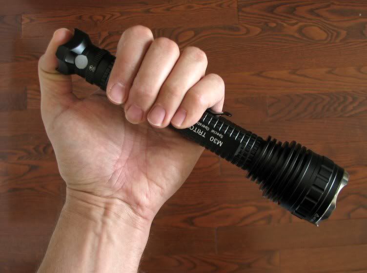

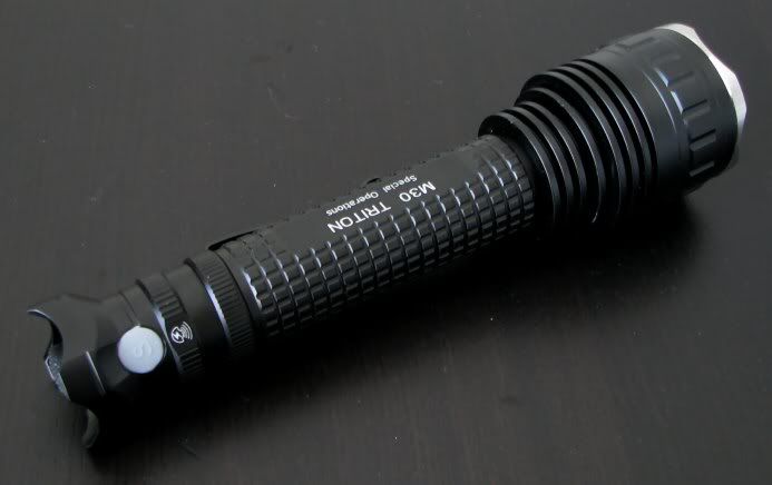

    The overall shape and design is similar to other Olight military-series lights. Rather than traditional knurling, the M30 has a raised checkered pattern to help with grip (not as raised as the Tiablo ACE-G). The M30 comes with black finish type-III hard anodizing. I typically find Olight lettering is bright and clear, and the M30 is no exception. Both the bezel opening and tailcap have raised scalloped edges – but unlike the earlier M20, this new M30 can also tailstand.
    Note the attached clip can be removed by unscrewing the retaining ring above it and pulling the clip off.
    Dimensions (no batteries installed):
    Height: 178mm (212mm with battery extender)
    Width: 33.0mm (tailcap), 25.1mm (body tube), 42.9mm (bezel)
    Weight: 164.0g (no extender), 180.8g (with battery extender)
    User interface of the M30 is different from other Olights (see below for a discussion). Main activation is controlled by a forward clicky tailcap switch that has a good feel. Even with the raised and flared tailcap edges, I find it easy to access. The innovation of the M30 is the secondary switch on the side of the tailcap (again, see below).
    Screw thread action is smooth on all sections, with each component fitting well (note the double o-rings everywhere). My sample seems to have little or no lube, so you may want to add some to increase water resistance. The tailcap switch contact spring has a brass cover over it, but it still retains its spring action.
    Unfortunately, the screw threads are not anodized, so there is no tailcap lockout possible.

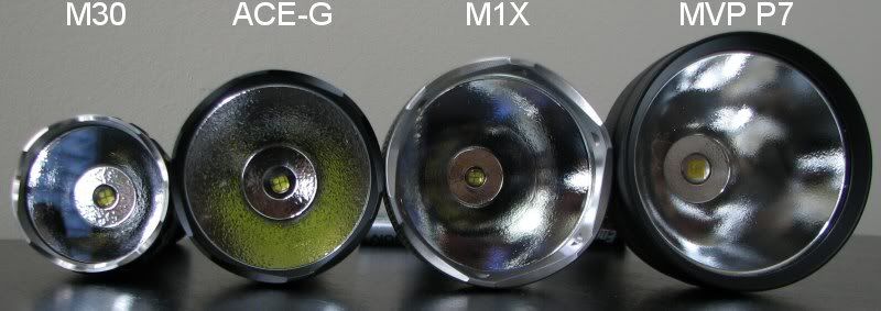

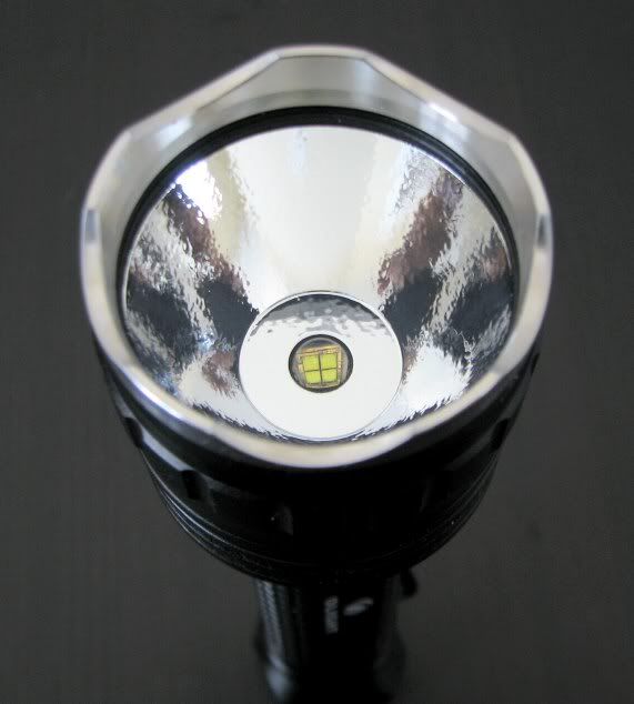

    The M30 has a surprisingly small head for a MC-E light, with a shallow reflector with heavy orange peel finish. The M30 is clearly designed to be more of flood-style light than a dedicated thrower, but that is common for MC-E/P7-based lights.
    So far, this is probably the most compact and lightest MC-E light I’ve come across. In the basic 3xCR123A configuration, this light isn’t that much larger than a number of dual-cell lights. But it still feels well made and substantial enough in the hand – I can see it being popular with those looking for a light cannon that doesn’t resemble an actual cannon.
    Here's how it compares to the competition (with and without battery extenders in place):
    (from left to right, AW 18650 protected battery, Olight M30 Triton, JetBeam M1X, Tiablo ACE-G, Lumapower MVP TurboForce P7).
    UPDATE: Here's a bezel shot to better allow you to compare the heads:
    User Interface:
    As mentioned above, the M30 features a revised user interface controlled by the primary and secondary tailcap buttons. Press the main tailcap switch for momentary mode, click for lock-on. To change the output mode, press and release the secondary switch (sequence is Lo – Med – Hi – 13Hz Tactical Strobe, in repeating sequence). Interestingly, the light can go directly to strobe from off by pressing and holding the secondary switch. Light has a memory mode to retain the last setting when switching off by the main tailcap switch.
    Although not immediately intuitive, this arrangement works well enough when you get used to it. But note that the secondary switch doesn’t have much tactile feedback, and doesn’t protrude very much from the curve of the tailcap, to prevent accidental activation (I found myself groping around for it on occasion). This will likely make it hard to use if wearing gloves, but at least you aren’t likely to accidentally strobe your loved ones in the middle of the night.

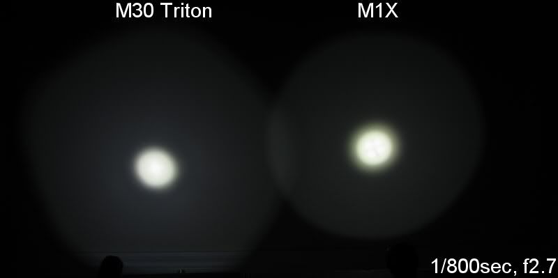

    Comparison Beamshots

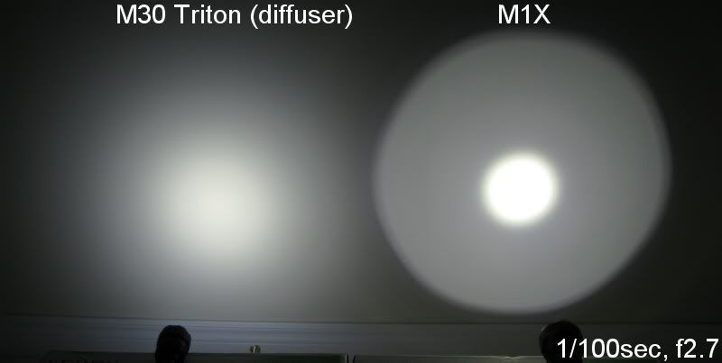

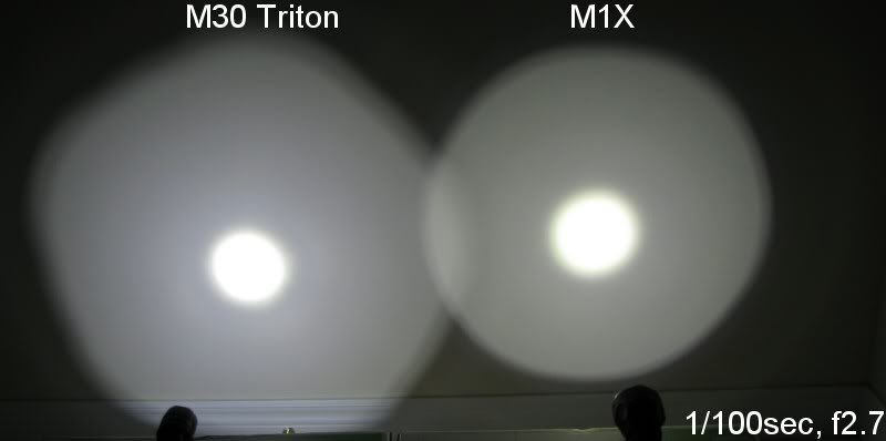

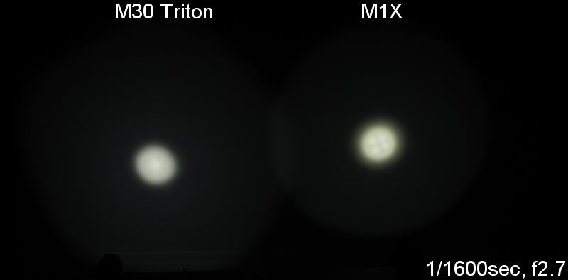

    All lights are on Max on 2x18650 AW protected Li-ion. Distance is about 0.5 meters from a white wall.

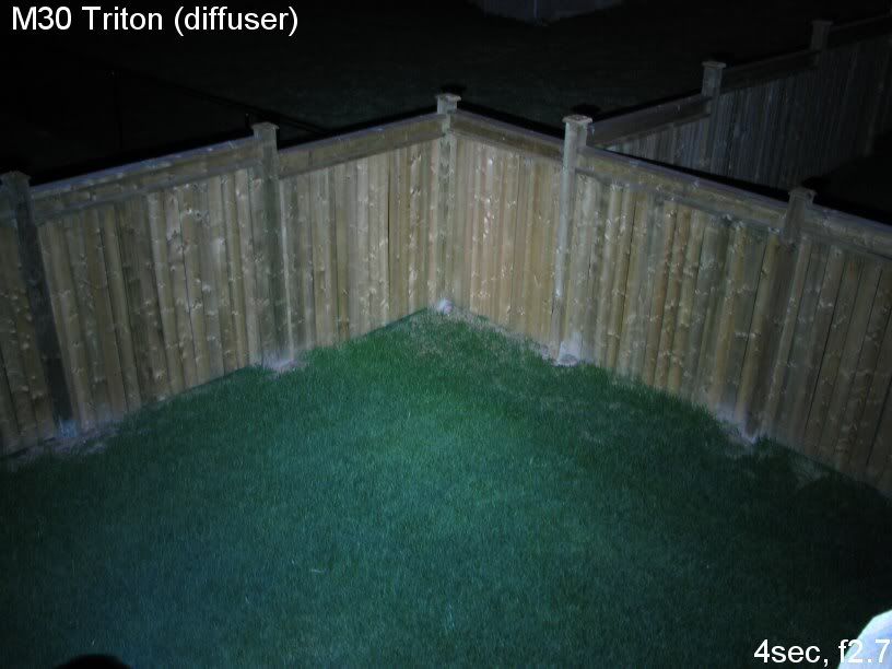

    Here’s how it looks with the diffuser on:

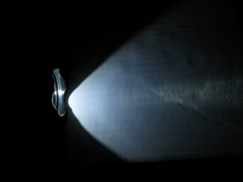

    And a few side shots with and without diffuser:
    As you can see, the M30 has a fairly typical wide MC-E spillbeam profile (although triangulated somewhat by the removable scalloped bezel ring). Throw is respectable for this class (in comparison, the M1X is a dedicated thrower). Like most MC-E lights, the M30 does have a detectable “donut” hole in the centre beam at greater distances and the “crosshair” pattern up close, but it is not as bad as some. So far, only the Tiablo ACE-G seems to have virtually eliminated this pattern, but the M30 is not overly obtrusive.

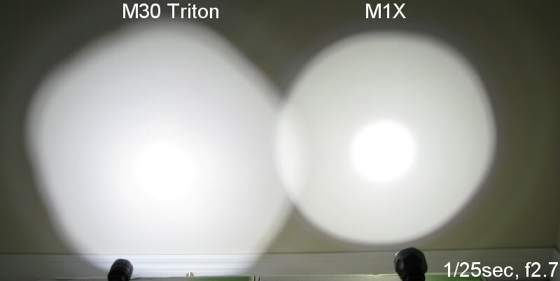

    Here are some outdoor shots focused on a point ~30 feet from the lights.
    I'm particularly impressed by how well the diffuser spreads out the beam to true flood.
    And here are some lower exposures to better show you the hotspots:
    Overall output of the M30 is similar to the JetBeam M1X and revised Tiablo ACE-G (which are in turn brighter than the earlier Lumapower MVP offerings). Beam profile most closely matches the ACE-G, but without as much of a reduction in standard MC-E donut hole effect. The M30 also has the least throw of four lights shown above, but is still quite respectable.

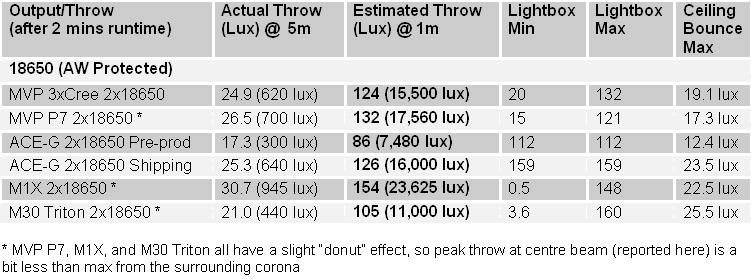

    Testing Method: All my output numbers are relative for my home-made light box setup, a la Quickbeam's flashlightreviews.com method. You can directly compare all my relative output values from different reviews - i.e. an output value of "10" in one graph is the same as "10" in another. All runtimes are done under a cooling fan.
    Throw values are the square-root of lux measurements taken at 5 meters from the lens, using a light meter, and then extrapolated back to estimate values for 1 meter. This will be my standard way to present throw on these types of lights from now on. The beams don't really have a chance to fully converge until typically several meters out
    Some of the MC-E-based lights take a couple of minutes to settle into their regulated output state (i.e. their initial output is higher, but not for long). As such, all my output and throw numbers are taken after 2 mins of continuous runtime (on 2x18650 AW Protected cells).
    Note that Tiablo has issued a revised ACE-G circuit/pill with much greater output than the pre-production sample I originally reviewed. This shipping version brings the ACE-G in line with the M1X and M30 for overall output. Please see my updated ACE-G/A10-G review for more info.
    The ceiling bounce and lightbox tests confirm what the beamshots showed – that the Olight M30, JetBeam M1X, and recently revised Tiablo ACE-G all have roughly equivalent max output (although the M30 has technically a slight edge on my ceiling bounce). Consistent with the smaller and shallower reflector, throw on the M30 is lowest of the class – but still quite respectable.

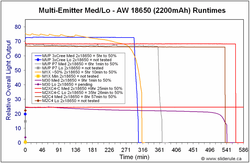

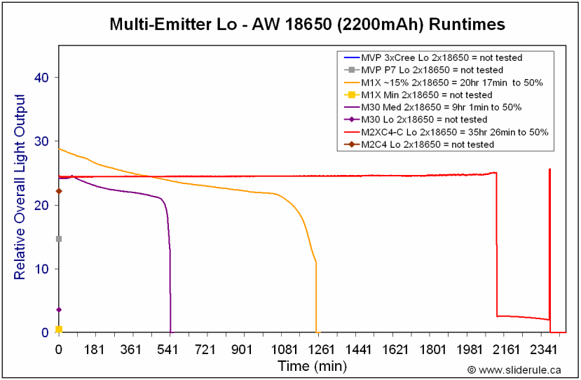

    Output/Runtime Comparison
    I’ve identified the output levels for the Med/Lo on the runtime chart below. They are both a bit lower than typical for this class of light (although may suit your personal preference).
    I don’t generally do 4xCR123A tests, but results on the other battery sources match my expectations. Note my 3xRCR runtimes are likely on the low side – I suspect all the recent high drain runs on these cells have reduced their charge-storing capacity.
    UPDATE 06/08/09: I've just updated the graphs with 4xCR123A runtimes for all lights that support this configuration. Also included are some recent additions to the multi-emitter class that I have recently reviewed.
    The M30 puts out an impressive amount of light on Max – equivalent to the single-stage Tiablo ACE-G (with revised shipping circuit).
    On Med, the 2x18650 battery tests are consistent with Olight's published specs, although it is less than I would have expected for the output level (i.e. runtime is much less than some of the competition at this level).
    No real surprises here: on 3-cell configurations, Max performance is close to the M1X.
    The efficiency of the Med performance of the M30 (which is equivalent to the Lo of Lumapower lights) is definitely lower than the competition. As you can see above, the M30 runtime is much less than the M1X when matched for output, which is a bit disappointing given the defined output levels of the M30 (the M1X is continuously variable). I haven't done Lo mode runtimes on the MVP P7, but you can easily see here the benefit that current-control circuitry brings to runtime efficiency by looking at the MVP 3xCree. And note the Lumapower is only on 2xRCR compared the 3xRCR for the M1X and M30.

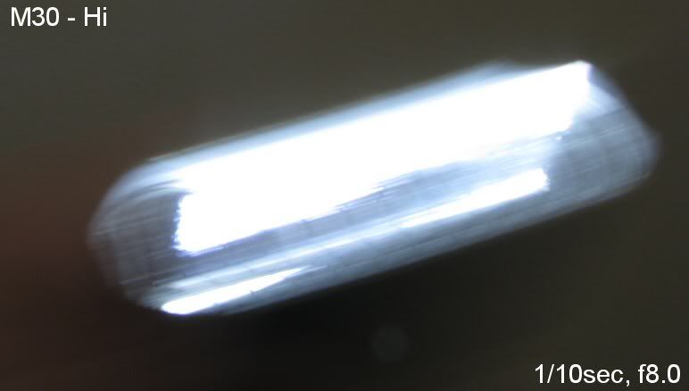

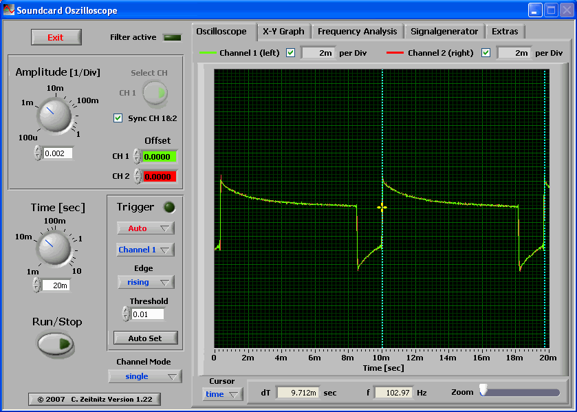

    To follow up on a point I made in the review above, the implementation of PWM is little unusual in the M30.
    To give you an idea visually of what the PWM looks like, here are some freeze-frame photos of the M30 in motion, taken at 1/10sec shutter time. Given the 99-104Hz PWM, you should thus be able to see 10-11 distinct after-images of the main beam:
    Normally in PWM-based lights, max output is run at constant-current (i.e. PWM is only used to reduce output in Lo/Med modes). But for some reason, the M30 still has detectable PWM on Hi – although it is not generally noticeable. Let me show you how it looks, again at 1/10sec exposure:
    At first, it appears that there is no PWM – you see a nice smooth “smear” of the main beam. But if you look closely, you can see the after-image of the outside edge of the light repeated at least ~10 times across the image (if may look like more to you, but that’s because of the overlapping effect of two sides of the bezel). According to my soundcard oscilloscope, PWM on Hi is 99Hz.
    Here are the oscilloscope traces to show you the PWM pattern. Each snapshot is taken at a time scale to show you ~2 pulses. The dashed blue cursor lines are positioned to show you the duration of a single pulse. Note that a negative deflection is an indication when the light is on, a positive deflection is when the light is off.
    Lo mode:
    Med mode:
    Hi mode:
    So why isn’t the PWM noticeable on Hi the way it is on Lo/Med?
    Simply put, it seems to be a perceptual issue with persistence of vision. Measuring the ON/OFF time of each cycle in the above tests, the Lo mode is only in the ON state ~1.5% of each pulse, and the Med modes is ON ~16.5% of the time. In contrast, the Hi mode is ON ~92% of the time. So despite the low PWM frequency, it seems the very high ON time makes it appear to be roughly constant output on Hi. In practical terms, it is thus very hard to notice the PWM on Hi – but it is detectably there.
    FYI, this is why all the videos you will see of the M30 in action have a noticeable “flickering” effect, even on Hi. You do not see this in real life, but the low frame-per-sec capture of video is very susceptible to such low frequency PWM. As I say, this is not an issue for actual use - it is really only a problem for shutterbugs (or reviewers )
    However, the PWM on Lo/Med is much more problematic, as it is very noticeable. Note as well that it means that still photos of the beam (especially on Lo) cannot be fully trusted to show overall output. Depending on camera settings (especially shutter speed), you may not be ale to completely integrate all the light.
    UPDATE: Scroll down to my post in #14 to see an update on the source of this issue.

    Why on earth was it contrived to have "92% ON" PWM on high, instead of
    just reducing the current to the led by 8% and having no PWM at all on high?

    I suspect it's because of the vast swing between min and max outputs. Constant current regulators are not capable of such wide input voltage and current output variance.

    Matt, I'm only referring to the PWM on the high setting. Seems strange to have PWM with a 92% ON cycle here.
    This implies that the full current supplied to the led has been dampened down by 8% using PWM on this level.
    Why not just supply 8% less current on high instead and have no PWM for this level?
    There could still be the PWM on low and medium modes.
    selfbuilt remarked that in lights using PWM, it was very unusual to see it on the highest level.

    There is a very good reason for the PWM being present in all output modes. OLight has the output regulations circuit* in the tail of the light (That was necessary to make the two buttons work), this circuit need some power to work, this power is supplied to the circuit when the PWM is in its off phase.
    This type of design was last seen in the Tiablo A10 light, with the mulitlevel tailcap.
    *This is not the same as the current regulation circuit, that is at the regular place in the head.

    After reading the reports of the PWM issue, I played with my M30 a bit at home. For the life of me, I couldn't notice any flickering at all. I tried everything I could think of, except using a fan as I don't have one. I also couldn't detect any buzzing on any of the levels like I can on my Fenix LD01.
    Are some people just less sensitive to PWM?
    6,936
    Default Re: Olight M30 Triton Review: RUNTIMES, BEAMSHOTS and more!
    Thanks HKJ - as always, you are fount of knowledge when it comes to these circuits!
    Yes, the A10-G was the only other light where I noticed PWM on Max (on the continuously-variable switch). In that case, max output was significantly reduced compared to the single-stage switch. I have gone back to compare, and have measured the ON-cycle as only 78% on the A10-G (explaining it's lower output). PWM is ~123Hz on the A10-G.
    I wasn't sure if the output regulator was in the tailcap of the M30, but what you say makes perfect sense. FYI, like the A10-G's tailcap, you will see a brief flash of light when you first make tailcap contact (immediately in the case of the M30, or after fully tightening past the lock-out on the A10-G). That should have been my tip-off that the regulator is in the tailcap.
    In any case, I don't see the lower output modes having much value for me personally at a PWM of ~100Hz. I really hope they can improve that.
    Quote Originally Posted by SCEMan View Post
    I came close to buying the M30 but the raised crenallated tailcap, and inclusion of the strobe in the tailswitch mode sequence were dealbreakers for me. And now the PWM makes me glad I waited...
    I have to admit I thought the flared tailcap looked a little wonky myself, but I haven't found it a problem in actual use. Part of the issue is the visual proportion compared to the rest of the light - in terms of its actual external dimensions and shape, it is is remarkably similar to the ACE-G tailcap.
    As for UI, my preference would also be to not have strobe as part of the sequence, but I guess that was too difficult to arrange with the tailcap circuit design.
    Quote Originally Posted by 1dash1 View Post
    Great review! I especially appreciate the runtime graphs. Thank you!
    Will you also be doing a review of the Eagletac M2/M2X lights?
    More runtimes to come, currently doing Med mode RCR.
    And yes, Eagletac will be sending me the M2/M2X lights to review. No ETA as yet.
    Quote Originally Posted by fugleebeast View Post
    After reading the reports of the PWM issue, I played with my M30 a bit at home. For the life of me, I couldn't notice any flickering at all. I tried everything I could think of, except using a fan as I don't have one. I also couldn't detect any buzzing on any of the levels like I can on my Fenix LD01. Are some people just less sensitive to PWM?
    Buzzing is typically inductor whine, and can affect all lights (not just PWM). I'm surprised you don't see the PWM effect, as I notice it immediately upon activation. Try waving your hand in front of the beam, with your fingers open.
    When shinning at a fixed point, you aren't likely to notice it much - unless what you are looking at is moving (i.e. an animal, the wind on grass and trees, etc), or you yourself are swinging the beam. I'm curious as to how you find it if you take it for a walk outdoors at night. My cat walked into the beam while testing, and I have to say his white whiskers against black fur looked pretty funny! Think digitized in the Matrix ...
    I had a few non-flashaholics over on the weekend, and they all immediately noticed it when I turned the light on low (one commented on the strobing effect before I could even say anything).

    Do not count on any big change, this kind of design needs a low PWM frequency, the current regulator need time to start.
    BUT by increasing the output in low mode, it might be possible to increase the PWM to a higher frequency, but this might also reduce the high output, because they might have to reduce the 92.3% high.
    It would probably be possible to double the low and the PWM frequency, without decreasing the high (This is just a guess, I have not measured/analyzed with that in mind).
    Both buttons is probably just sending a signal to the microprocessor in the tailcap, i.e. any kind of UI could be programmed in that processor.
    Hi, selfbuild.
    Sorry, but can you post the reflectors comparison between 4 of them.
    since I cannot compare them directly by measurement.
    Thanks again.

    The PWM is from the switch, i.e. moving it to the M20 will move the PWM to the M20. But the electronic on the M20 might have some problems handling the PWM. I do not believe that the M30 will have any problems with the M20 switch.

    The circuit in M20 is not made to be turned and off 100 times each second, how does regulator and the microprocessor handle that?
    The regulator might not have time enough to stabilize the current, i.e. it might be running in a startup condition all the time, that the circuit was only designed to handle for a short time.
    The microprocessor might store some settings in a eeprom each time the power is turned off and a eeprom lifetime of 1 million writes can be used up rather fast with 100 writes each second.
    Usual equipment need some time off, before it is turned on again, to secure a clean startup, this time can some seconds (like on a PC), but can also be much shorter, but is the M20 designed for a off time of 0.001 second?
    I do not say it has these problems, only it might.
