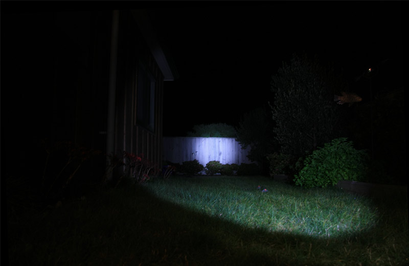

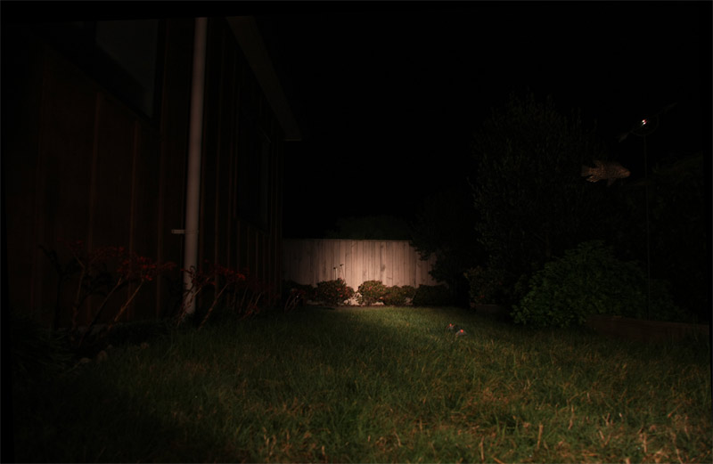

    Here's a couple of above water beamshots. Range to fence is 10 meters.
    Camera set at ISO400, F5, 6 second exposure.
    First, heres my fully charged UK 1200. 12 watt halogen bulb.

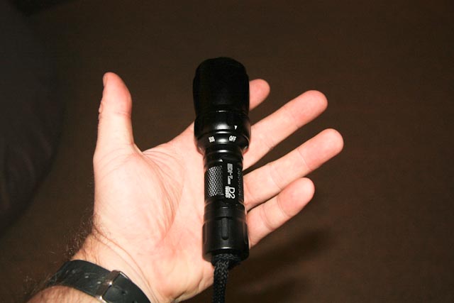

    The EDI-T D2

    Default Re: EDI-T dive light
    Quote Originally Posted by spearsniper View Post
    Thanks for that. Seems like a nice tight beam.
    Is it really that blue, or is it just the picture?
    Do you think using the selector ring with thick gloves (3mm) would be a problem?
    Enlightened spearsniper's Avatar
    May 2008
    Wellington, New Zealand
    49
    The beam is not actually that blue. The white balance on the camera was set for incan lights. Hence why the uk1200 did not have a really yellow beam.
    I just put on a pair of 7mm dive gloves I used to use with my drysuit, and could activate the selector ring with no issues. In fact it is easier than turing on the switch of the UK1200.
