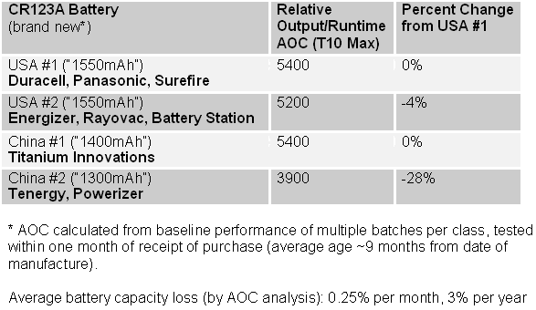

    Based on my tests of various lots over the years, I have come to the general conclusion that the USA cells shown above fall into two general categories based on performance:
    USA #1: Duracell, Surefire, Panasonic
    USA #2: Energizer, Rayovac, Battery Station
    The difference between these groups is fairly small (i.e. <4% in my testing!), but seems to be consistent. Note that I make no claim as to who actually manufactures which cells - simply that based on max output performance in single-cell lights, this is how my data shakes down after controlling for age effects.
    From the above graphs, I have measured area-under-curve (AOC, I can't spell ) to estimate overall capacity. Note that this is a completely arbitrary and relative measure - I have no way to actually measure mAh. But it gives you some numbers to compare.
    UPDATE June 17, 2009: I have revised the table above with the average of the 3 recent lots of Titanium Innovation batteries. Performance ranged from ~5250-5600 AOC in my testing.

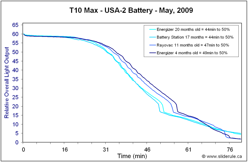

    Effects of Age
    Having bought most of my cells in small batches (to insure I always had fresh cells for testing), I have had to opportunity to compare capacity changes over time. Although I haven't kept samples of too many older lots, I do have enough on hand to give you a quick comparison of age effects in my current T10 test bed.
    As you can see, there is a clear pattern of loss of performance/capacity over time (all batteries tested within a week of each other in the above graphs). This is why I cautioned earlier about not reading too much into that first graph showing a lot of variation between USA cells - what you were really looking at was variability in the date of manufacture.
    I have more data than shown above, but frankly I don't think I have sufficient data to accurately quantify the average rate of loss of capacity over time. Based on a rough approximation over the first 18 months or so, it appears to average out to ~0.25% per month, or 3% per year. But again, that is just a very rough estimate - I would need a larger data set to state with any degree of confidence.
    UPDATE June 30, 2009: As MorePower has pointed out, there is potential confound here. Because these runs are done with batteries from different lots manufactured at different times, it is possible that some of the "age effects" I'm seeing are in fact due to process improvements in manufacturing over time, leading to greater capacity on newer cells. To determine that, one would need to test the same lot at varying times after manufacture in a fully calibrated setup. Unfortunately, neither a typical flashlight (where the emitter can suffer age effects) nor my home-made lightbox (which is not calibrated) would allow me to do that.

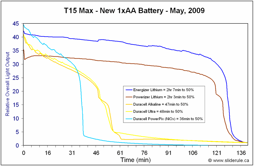

    1AA Shoot Out
    As expected, Energizer e2 Lithium (L91) is a MUCH better choice than alkaline for running the T15 on Max. Note that the Powerizer brand version of the L91 had lower total capacity and reduced max output. Again, I recommend you stick with the Energizer cells.
    For alkaline, note that there was absolutely no difference between plain Duracell alkalines and Duracell Ultra alkalines. I'd stick with the lower cost ones.
    Of interest to me was the poor performance of the Duracell nickle oxyhydroxide NiOx cells (branded under the "PowerPIX" label). Duracell markets these as a competitor for Energizer lithiums in digital cameras, claiming "up to 2X more digital pictures" over standard alkalines. Yet in terms of total capacity, my T15 test shows they actually have lower AOC performance.
    So what gives? I suspect Duracell is referring to the fact that alkalines can quickly get exhausted under a high load (e.g. rapidly taking a number of digital pics, especially with a flash). The NiOx cells do actually give greater initial output on the T15, so I'm guessing they are better able to keep snapping pics when placed under this sort of rapid high-drain load. But I think we have something a "tortoise and a hare" issue here - the NiOX may be faster out of the gate, but plain old alkaline seems to win at the endurance race (at least based on the simple T15 max output test here).
    FYI, this is consistent with the Duracell FAQ on NiOx, which points out that the NiOx chemistry is designed to release more power in high drain applications such as digital cameras, but that there is no performance advantage versus regular or premium alkaline in other devices. For flashlights, they specifically mention that "Flashlights may burn brighter, and motors may run faster but for shorter durations than with alkaline because of the higher operating voltage of PowerPix." In other words, skip 'em.
    Preliminary AA Conclusion:
    For max output on flashlights, I think the choice is clear - stick with Energizer lithiums. But standard alkalines are still fine for lower output modes. I'm just not too sure if there is any real advantage of "premium" alkalines over the plain jane ones.
