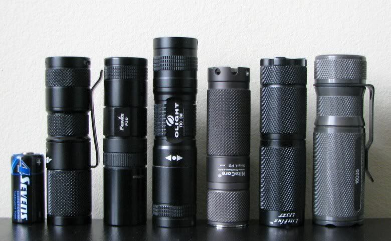

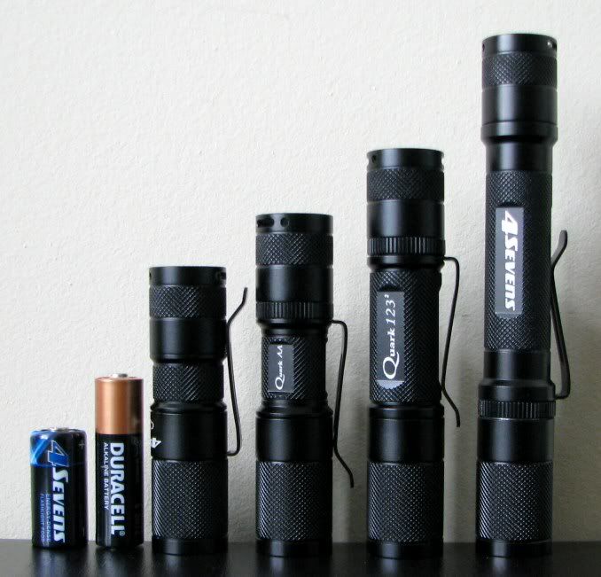

    (from left to right: 4Sevens CR123A, Duracell AA, Q123, QAA, Q123-3, QAA-2)

    Note that the heads, tailcaps and body tubes are physically interchangeable among the four models. The Q123-2 uses a different circuit from the rest, but the Q123/QAA/QAA-2 versions use the same circuit (i.e. you could switch tubes between those models for different battery performance).

    Quark 123 Comparison
    From left to right, 4Sevens CR123A, Quark 123, Fenix P2D, Olight T10, Nitecore EX10, LiteFlux LF3XT, Novatac 120P
    Beamshot Comparison
    All lights ~0.5 m from a white wall, on 1xRCR AW Protected.
    Exp 1/25 sec, f2.7
    Exp 1/100 sec, f2.7
    Exp 1/800 sec, f2.7

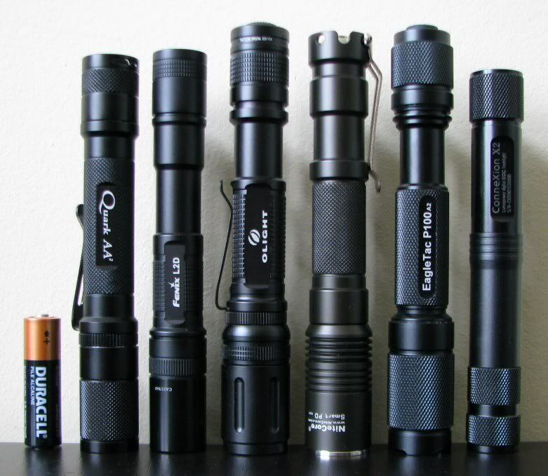

    Quark AA-2 Comparison
    From left to right, Duracell AA, Quark AA-2, Fenix L2D, Olight I25, NiteCore D20, EagleTac P100A2, Lumapower X2 2AA.
    Beamshot Comparison
    All lights ~0.5 m from a white wall, on 2xEneloop.
    Exp 1/25 sec, f2.7
    Exp 1/100 sec, f2.7
    Exp 1/800 sec, f2.7
    Output/Runtime Comparison:
