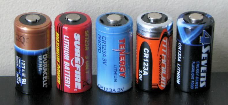

    Batteries:
    All batteries were purchased new within the last three months from major distributors. Duracells and Surefires used in this study both have a manufacture date of August 2008, and were purchased from cfrlights and Tetragon (local Surefire distributor), respectively.
    Made-in-China batteries do not have a manufacture date, but all were purchased within the last one month. 4Sevens batteries were from 4sevens.com, Titanium Innovations batteries were from batteryjunction.com, and Tenergy batteries were from 4sevens.ca.

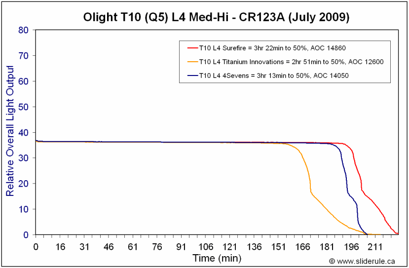

    I have chosen four single-cell CR123A lights for comparisons. Each light has a different type of regulation circuitry. All light were run on Max/Turbo settings.
    • 4Sevens Quark Q123 (R2)
    • LiteFlux LF3XT (R2)
    • Olight T10 (Q5)
    • NiteCore EX10 (Q5)
    All my output numbers are relative for my home-made light box setup, a la Quickbeam's flashlightreviews.com method. You can directly compare all my relative output values from different lights - i.e. an output value of "10" in one graph is the same as "10" in another. All runtimes are done under a cooling fan.
    In addition to time to 50% output (the standard runtime measure), I have also done an area-under-the curve measure (labelled as AOC – I can’t spell ). This gives you a relative measure of the total capacity for each cell in each light. It is in completely arbitrary units (as it integrates my relative output values over time), but it will allow you roughly compare overall capacity within each flashlight model.
    Runtimes:

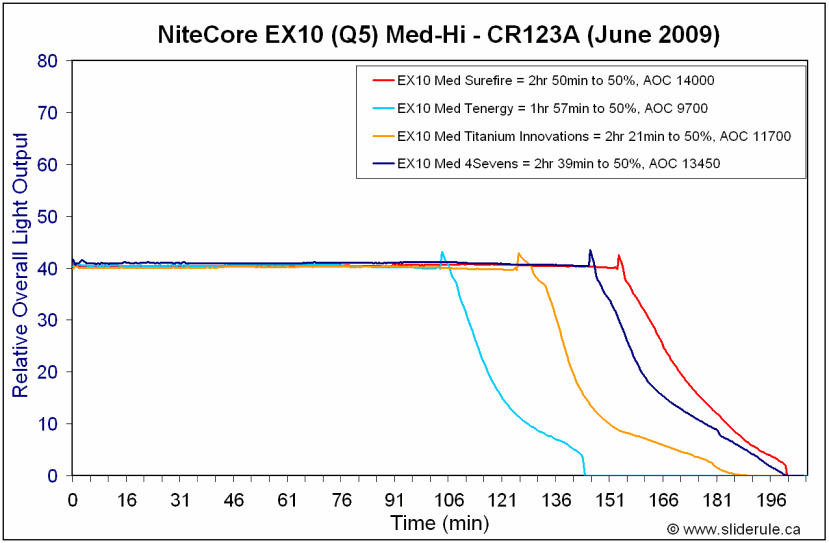

    UPDATE JUNE 28, 2009: Added a "Med-Hi" runtime on the NiteCore EX10 (Q5), to see how the batteries fare until a lower current load.
    UPDATE JULY 10, 2009: Added a "Med-Hi" runtime (L4) on the Olight T10 (Q5)

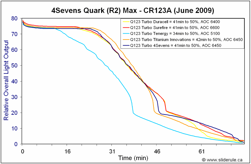

    USA Cells (Surefire/Duracell)
    As mentioned in my original CR123A/AA Battery Shoot-out, Duracell and Surefire cells typically have equivalent performance that is among the best I’ve seen for made-in-the-USA cells. These are the standard by which I compare other batteries. Please see my earlier review for how other USA brands compare.
    Titanium Innovations cells:
    On Max, the Titanium cells consistently provided equivalent runtime and overall capacity to the top-tier USA cells. In fact, they were the only China-made cells to do so. But they do have a slightly different runtime pattern – as the cells near depletion, they drop in output more rapidly than the USA cells (which tend to enter a longer “moon mode” of gradually reducing output). So while time to 50% and overall capacity are similar, expect to have a more rapid drop-off as the Titaniums near depletion. Note that I have tested 3 different lots of Titanium cells so far, and the “average” batch (in terms of capacity) is shown above. Performance was generally similar on all three batches when run on Max.
    On the Med output EX10 and T10 runs, the Titanium Innovations cells showed lower capacity and runtime than the Surefire or 4Sevens cells. Although difficult to generalize from the limited testing above, it seems that the Titanium cells are best suited to high drain situations (although are still quite reasonable at these lower drive currents).
    4Sevens cells:

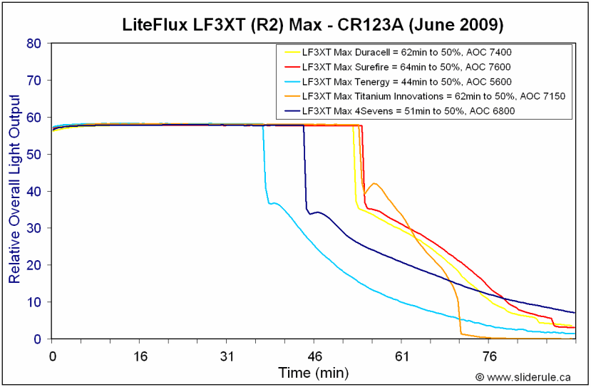

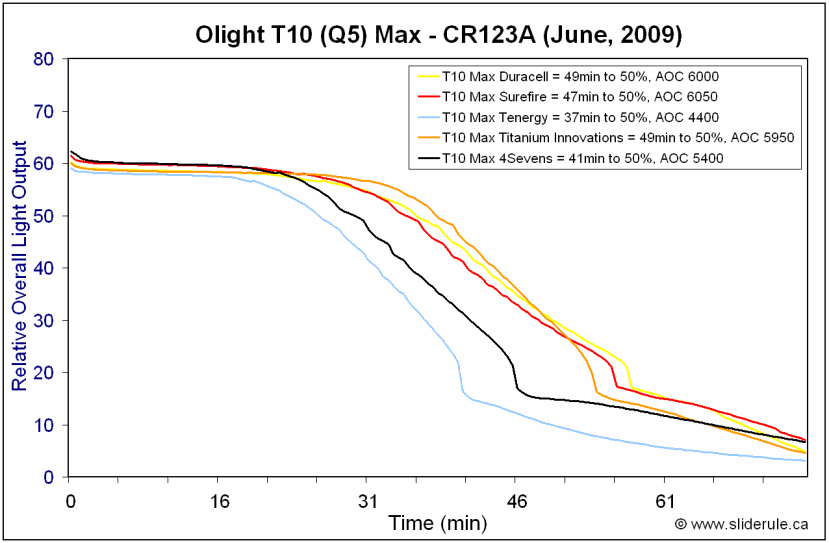

    The new 4Sevens cells do remarkably well in the 4Sevens Quark lights. In fact, they are basically indistinguishable from the top-tier USA cells in terms of time to 50%, overall capacity, and runtime pattern.
    However, when tested on Max in the Olight T10 and LiteFlux LF3XT, their total capacity appears to be ~10% lower than the top-tier USA brands or Titanium cells. I am not sure of the reason for this discrepancy. I have tested several batteries from the same lot, and get identical runtime traces each time in the lights above.
    Interestingly, in the Med output EX10 and T10 runs, the 4Sevens cells performed better - fairly close to to the top-tier USA, in fact. This suggests that the 4Sevens cells perform best at less-than-maximal drive currents, except in some lights (like the Quarks), where their performance is consistently top-level at all outputs. Note that the runtime pattern of the 4Sevens cells remains similar to the USA brands in all lights (i.e. good long moon mode).
    Tenergy cells:
    Tenergy cells consistently under-performed in all 4 lights. Total capacity of the Tenergy cells appears to be consistently ~25-30% less than the top-tier USA cells. They also tend to drain much faster than the other batteries once the circuits drop out of regulation.
    Bottom line: I think you could do well with either the Titanium Innovations or 4Sevens cells. The 4Sevens cells have a pattern very reminiscent of the USA brands, but with slightly lower overall capacity on Max in some lights. The Titanium cells were consistently in line with the top USA brands in all lights on Max, but performed a little below on the lower outputs.

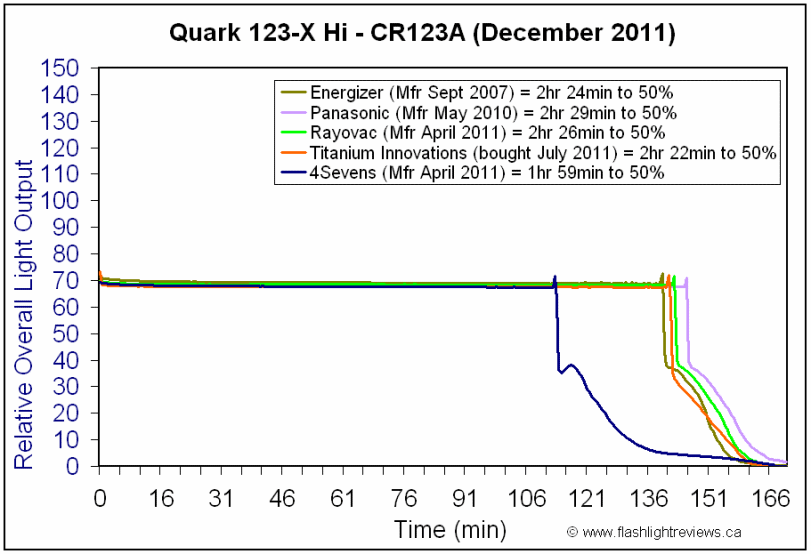

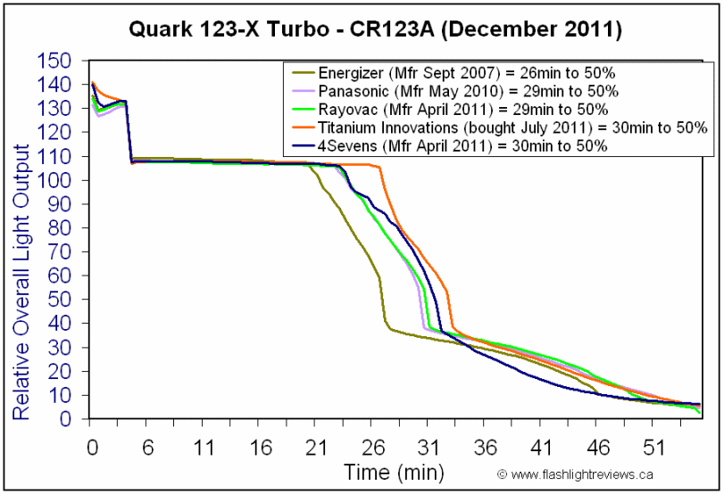

    Back in December 2011, I did some additional comparison tests of these cells in a few newer lights. Sorry I never got around to posting the results here, but here they are:
    As you'll see, modern made-in-the-USA cells continue to consistently match each other's performance. The older Energizer cells fall behind in the max current draw example above (which may be due to age effects, or more likely improvements in the more recently manufactured cells).
    The Titanium Innovation cells continue to do at least as well as the name-brands on Hi current draws. The issue I noted in my original review was slightly lower performance on the mid-level current draws. At least in the case of the Foursevens Quark 123-X above, you'll see the more recent Titanium Innovation cells are doing quite well now.

    4Sevens cells:
    However, when tested in the T10 and LF3XT, their total capacity appears to be ~10% lower than the top-tier USA brands or Titanium cells. I am not sure of the reason for this discrepancy. I have tested several batteries from the same lot, and get identical runtime traces each time in the lights above.
    Just my initial thoughts but maybe the 4Sevens cells are better suited for high current applications but are lower capacity when the current is lower? I remember from HKJ's review that the current draw at the beginning of the Q123 runtime is 2A - quite demanding for such a small battery. This could be some explanation for the difference between Q123 and LF3XT, I don't know why it happens for Olight, though.

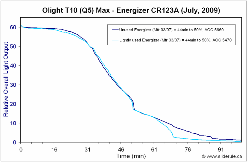

    Quote Originally Posted by gswitter View Post
    Wish you could do the same tests after letting the cells sit for two or three years.
    I've done that for several of the USA brands (especially Duracell and Energizer), as shown in my earlier battery round-up review.
    Because a light's performance could change over time, I kept samples of certain older lots of cells where a manufacture date is given (hence why only USA cells tested). These were all re-tested in my Olight T10 within a few weeks of each other (range was from 9-30 months old at time of testing). As you will see, there is a fairly consistent loss over time, ~3% per year, based on my very limited sample size.
    Yes, it occurs to me that may be an issue. Testing at lower outputs (and hence lower currents) should help reveal a bit more. Unfortunately, I'm running out of a number of the brands, so I will have to give this some "strategic" thought when the lightbox is free again (busy testing new lights right now).

    6,936
    Default Re: CR123A Comparison Review: 4Sevens, Titanium Innovations, Tenergy, Surefire, Durac
    Quote Originally Posted by nanotech17 View Post
    the titanium seems to be more consistent through out all the testing.
    That was certainly true on all the Max output runtimes. But to further round-out the review, I've added results from the NiteCore EX10 on a Med-Hi setting:
    As you can see, the Titanium cell didn't last as long as the Surefire this time.
    Good to see the 4Sevens still holding its own ... it looks like it's not initial current draw that is the issue for the lower capacity in T10 or LF3XT.

    Quote Originally Posted by brightnorm View Post
    In the early days of CPF some members believed that cr123 auto-discharge accelerated significantly after even the briefest use. You could use your light for a minute and store it in the glove compartment, and after a week the battery was dead or near death. The idea was that a new cell had some kind of physical protection against rapid self-depletion but as soon as the cell was used that protection (some called it a kind of "membrane"), was in effect breached.
    Have you ever heard of this phenomenon, and if so is there any truth to it?
    Interesting question, I hadn't heard of that before. I think I can dispel it, at least for Energizer CR123A cells (may be different for cheapo foreign cells).
    Below is a comparison of two cells from the same batch (manufactured March 2007). One was left untouched in original packaging for two years ("Unused"), and one has been one of my "tester" cells for the last one year or so ("Lightly Used"). As a tester, I have been using it to quickly test the max output/throw on new lights as they arrive (i.e. click on Max, take a reading, turn off). I would estimate that I have used up the equivalent of ~1.5mins of continuous runtime, scattered over a one year period.
    As you can see, there is no difference in time to 50%, and only a slight reduction in total capacity as measured by area under the curve.
    Looks pretty convincing to me that Energizers don't suffer any ill effects from "breaking the seal".
