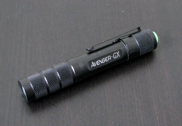

    The Avenger GX is the latest 1xAAA light in the Lumapower “EDC” family of easy-to-use, easy-to-carry lights.
    Like the Incendio (1xCR123A/RCR), Connexion (1xAA, 2xAA), and Encore lights (1x18650) I have reviewed previously, this light uses a simple three-stage current-controlled output circuit (i.e. no strobe or SOS modes). While typically not the brightest members of their class, the EDC line of lights usually show excellent output/runtime efficiency in a remarkably small form factor. Let’s see how the Avenger GX does ...
    The Avenger GX packaging is similar to the other EDC models. The light comes with a forward-clicky GITD tailcap installed, and the package contains a replacement twisty tailcap, manual, warranty card, keychain clip, wrist strap, two pocket clips (one black, one stainless steel), spare o-rings and black clicky tailcap cover. Not shown are the two 900mAh NiMH batteries Lumapower bundled with mine for testing purposes.

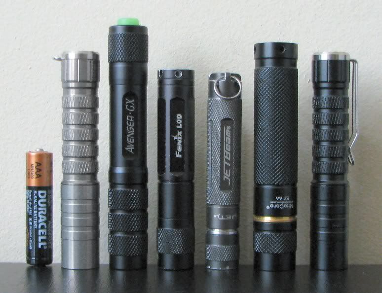

    (from left to right: 1xAAA Duracell, LF2XT Natural, Lumapower Avenger GX, Fenix L0D, JetBeam Jet-µ, Nitecore EZAA, LF2XT Black)

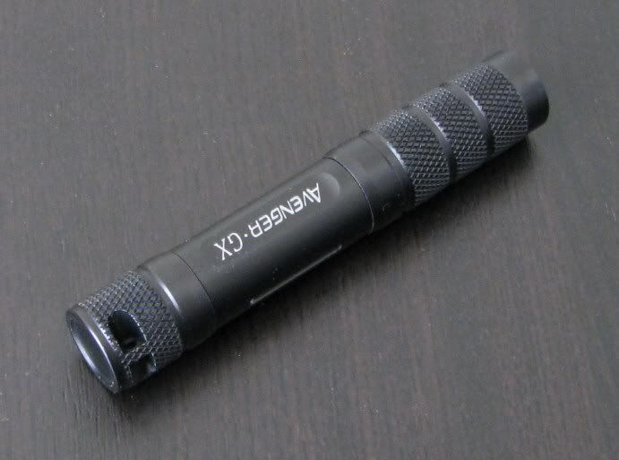

    Although a bit long for a 1xAAA light with the protruding forward clicky switch tailcap installed, the twisty tailcap lowers the height considerably. Overall weight and size feel fine to me, in either format.
    Weight: 22.9g (with Clicky switch), 22.0g (with twisty switch)
    Length x Width: 93.8mm (with clicky switch) or 86.7mm (with twisty switch) x 15.2mm (bezel widest portion)

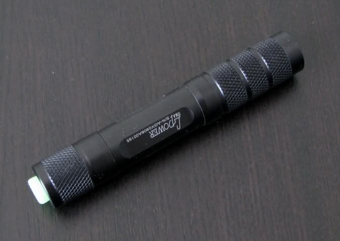

    Clicky feel is fairly stiff, so accidental momentary activation is less likely to occur (and you need a fair amount of force to lock-on). Note that there is no hole in the clicky tailcap for keychain carry (only on the twisty tailcap), so you need to wrap the keychain clip holder around the pocket clip on the clicky-version if you want to carry it on a keychain.
    Fit and finish on all portions is very good on my sample. The labels are clear and the type-III hard anodizing had no chips or flaws. Note that the head screw threads are anodized, so head lock-out is possible (no anodizing on tailcap threads).
    Knurling is fairly generous on the head – combined with the concentric raised portions, grip is quite good. The optional pocket clips would provide an anti-roll feature – they fit fairly snuggly, so there is little risk of them popping off accidentally.
    And of course, the light can tailstand in the twisty version.

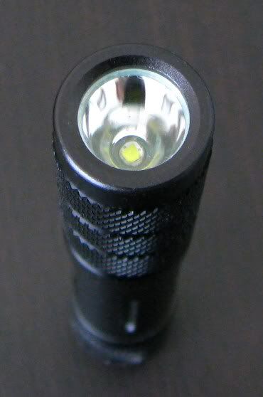

    The light uses the new smaller Cree XP-E emitter, currently with a cool white R2 output bin. I would estimate my sample is a WG-WH tint (i.e. on the warmer yellow-green end of the cool white tints), but of course yours could be different. For more information on tints and color perception, please see my Colour tint comparison and the summary LED tint charts found here.
    Typically, most XP-E emitters I’ve seen have come with textured reflectors, thus virtually eliminating any potential Cree “rings” in the beam. I don’t know why, but the Avenger GX comes with a smooth reflector. This produces a more sharply defined hotspot, but also introduces a few rings into the beam.

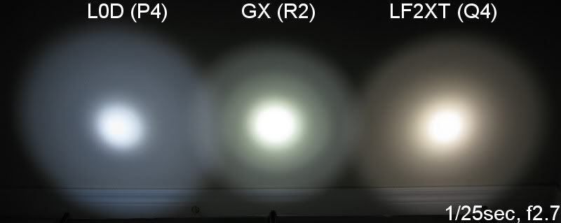

    Comparison Beamshots
    All lights are on 100% on Sanyo Eneloop (NiMH), about 0.5 meters from a white wall.
    The camera is accentuating the tint difference a bit, but the Fenix L0D (older Cree P4 model) does indeed have a slight bluish Cool White tint. The Lumapower Avenger GX is not quite as warm as it seems, although still on warm end of Cool White (maybe a WG-WH tint). The LF2XT is not as orange as the pic above suggests – a lot more yellow (4C neutral tint).

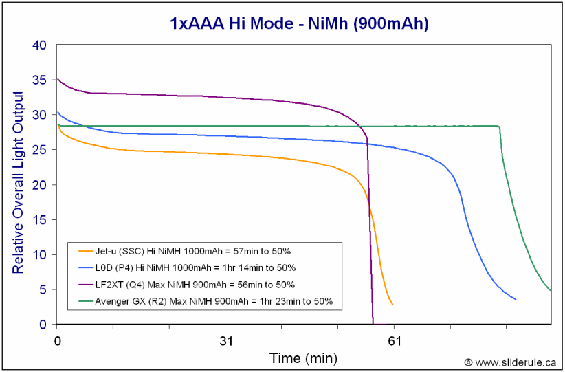

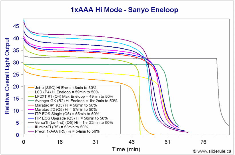

    Like the other members of the Lumapower EDC line, max output is kept at regulated level just below the max possible output for a given emitter emitter/battery combo. Please see the runtimes below for a more accurate picture of the performance of the Avenger GX.
    Output/Runtime Comparison:
    Output/Runtime Comments:
    Please note that I do not have many modern 1xAAA lights to compare to, so take the representative runtimes shown here with a big grain of salt.

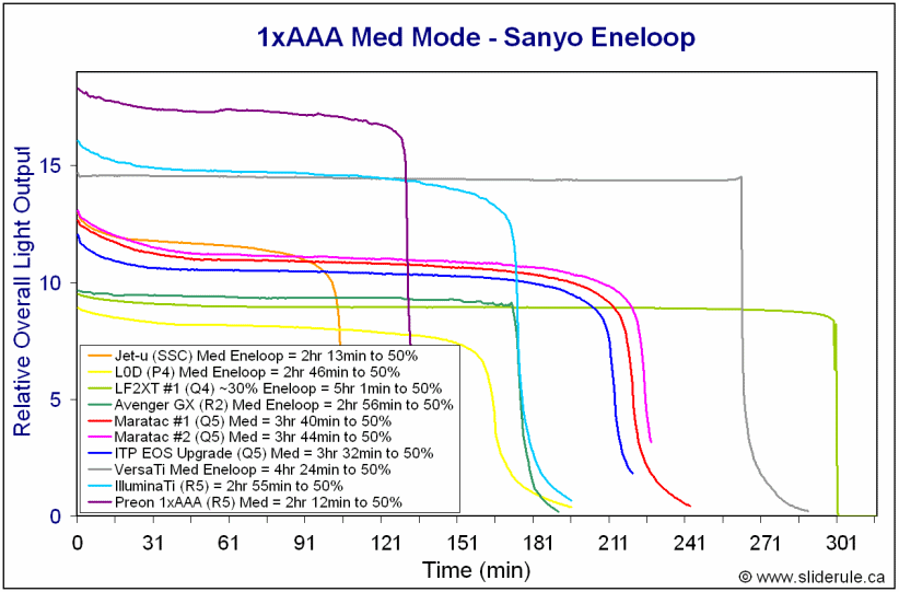

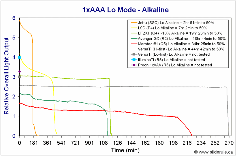

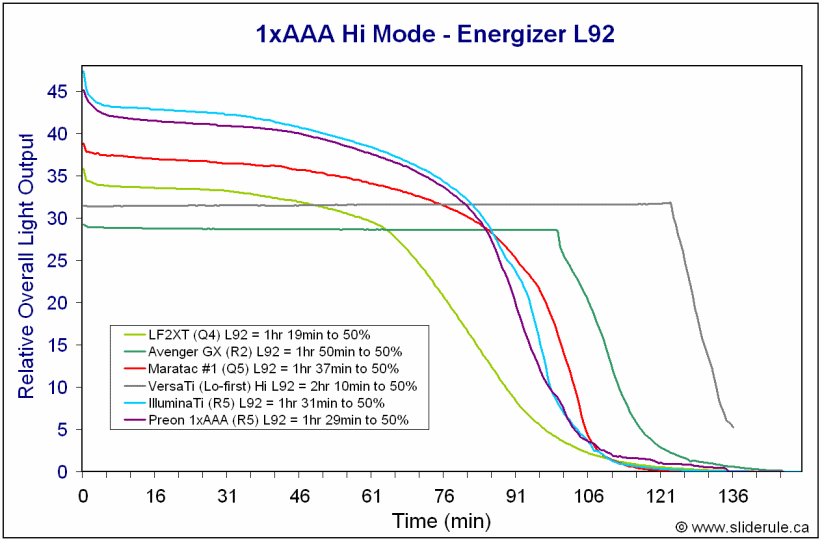

    The members of the Lumapower EDC line-up consistently have slightly lower Max output compared to other lights of their class – but feature incredibly flat runtime regulation. The same can be seen here for the Avenger GX – especially on NiMH/Eneloop (which the Avenger GX seems to be optimized for).

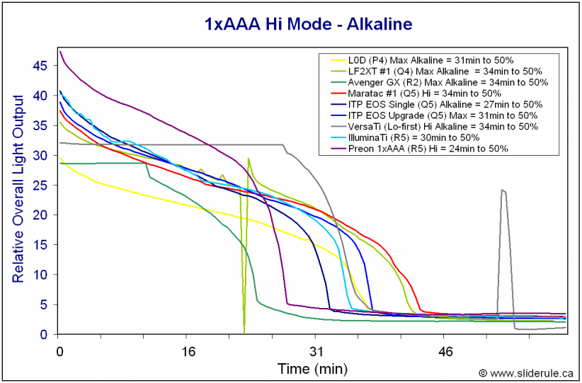

    What isn’t as impressive is the alkaline performance. Of course, I don’t recommend running modern lights on alkalines (given the propensity of alkalines to leak and potentially damage the light they are in). The exception is L92 lithiums - like NiMH, the Avenger GX does well here (only Hi tested).
    On Lo/Med modes, Avenger GX runtime performance is certainly acceptable. But based on this limited runtime data, the Avenger GX appears to be closer to what you might expect from a Fenix L0D with a Q2 emitter, as opposed to a R2 emitter. However, I suspect this is largely due to Vf variation among my samples. Since none of the manufacturers seem to buy emitters with defined Vf bins, you don’t know what you are going to get.
    I have reason to believe my L0D (Cree P4) has a particularly low Vf (which would translate into longer runtime on lower output modes). My LF2XT #1 sample also seems to be an exceptionally strong performer, and may not be indicative of typical for that model. It is possible my Avenger GX just happens to have a LED with a relatively high Vf, leading to lower runtimes on Lo/Med.
    As always, don’t read too much into low mode runtime data from a single review sample.

    The smooth reflector enhances throw, but leads to greater rings in the beam compared to other Cree XP-E lights with textured reflectors. Still not as bad as a typical XR-E emitter with a smooth reflector, though.
