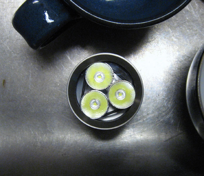

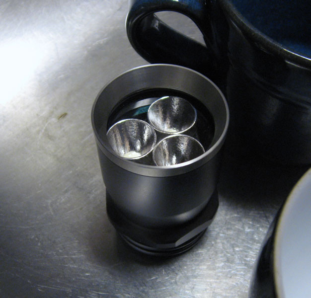

    M3 Ti Skeletonized
    Working on a minimalist M3 head with Ti bezel ring and a deliberately sparse, skeletonized look inside the head. It's not finished yet but here are a couple photos that give the general idea. I didn't bother to clean the exterior as this is still a work in progress.
    The head is on a Seraph M2C adapter and ultimately will ride on a C2 body bored for a single 18650 cell. The light will feature multi-brightness, multi-UI, miser capability, and reverse polarity protection.
    --Scott

    What emitters???

    They're CreeXRE-R2WD. The tint is beautiful... just the slightest touch to the warm side of a pure white... and output is excellent. The narrow exit angle of the XR-E reflectors works to the benefit of the geometry of the M3 with relatively tall bezel ring.
    --Scott
