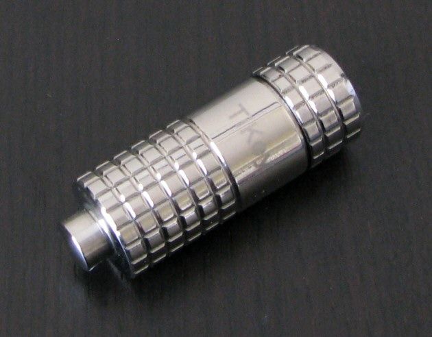

    Weight 22.8g, Length 46.3mm x Width 16.7 (bezel)
    As you can see, the TiKey is of a fairly small construction. The light uses three AG13 (aka LR44) alkaline button cells, and is about the size I would have expected for a light using this battery source. The overall width of the light is similar to my NiteCore EZCR2, but the TiKey is of course shorter. Overall weight is heavier than what an aluminum light of similar size would be.
    I will discuss the choice of batteries later my review.
    The standout feature of this light is its titanium construction. It is a simple twisty model with the head and body forming two separate units. As you can see, it has a polished finish with no obvious chips or damage on my sample. The identification labels are a soft gray on the polished background – very class looking, IMO.
    Titanium screw threads are known to produce a fair amount of galling, which leads to a sticky feeling when screwing the parts together. Despite only a minor amount of lubrication in its stock form upon arrival, I've found thread action to be quite smooth. I don't know if ThruNite has improved the action from the earlier samples, or if this is just a particularly good example. Certainly no worries here.
    Not shown above is the gold spring in the base of the body (removable). My light came with button cells installed – which was good, since there are no marking or manual to show you the correct orientation. As it turns out, the positive button cell terminals (i.e. flat end of the cells) point toward the spring in the bottom of the light.
    By nature of the twisty action, the light is locked out when not in use. Due to the protruding split ring attachment, the light cannot tailstand.

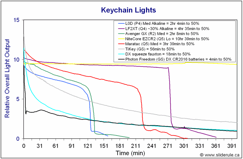

    Testing Method: All my output numbers are relative for my home-made light box setup, a la Quickbeam's flashlightreviews.com method. You can directly compare all my relative output values from different reviews - i.e. an output value of "10" in one graph is the same as "10" in another. All runtimes are done under a cooling fan, except for the extended run Lo/Min modes (i.e. >12 hours) which are done without cooling.
    I've decided not to bother with a throw/output summary chart for this light, for the simple reason that the output and throw are fairly minimal and decay quickly with time (making accurate comparisons difficult). Please see the runtime graphs below for a comparison to other lights.
    Output/Runtime Comparison:
    First thing to note is that the output of the TiKey is consistent with the medium to low output levels of other lights in this keychain class. Of course, due to the use of three alkaline A13 batteries, runtime will be less than lights using standard AAA alkaline or CR2 lithium cells.
    The next thing to note is the fairly straightforward direct-drive decay pattern of the TiKey. This is similar to the simple 5mm LED squeeze lights available at a number of vendors (using 2xCR2016 lithium batteries) – although TiKey appears to be somewhat brighter than the standard cheapie squeeze light (i.e. DX "fauxton"). This could be good news for you if you like to use your light regularly for extended periods.
    I would note that the storage capacity of an AG13 cell is typically rated at around 140-145 mAh (1.5V), compared to only 75-80 mAh (3V) for a CR2016 cell. Given the 3xAG13 configuration of the TiKey, I would expect potentially longer runtime than a standard cheapy 2xCR2016 squeeze light - at least on fresh cells.
    But that raises the interesting question of relative performance of alkaline AG13 batteries over time. Unlike lithium power sources which have a shelf-life of 10 years, the shelf-life of alkaline cells is typically only three years.
    Shown above are runtime graphs for the TiKey on several sources of AG13 batteries. As you can see, inexpensive dollar store AG13 batteries (10 for a buck in this case) provide equivalent runtime performance to the stock AG13 cells included in the package. This shows you that you likely don't need to be spending a lot of money on expensive brand-name button cells. But when compared to a pack of AG13 batteries purchased almost 3 years ago at DealExtreme (50 cells for a couple of bucks), you can see the effect of age on alkaline cells.
    This suggests that you are best off using your TiKey on a regular basis and replacing the cells as needed. This would not be a light to leave for long-term storage. Of course, I never recommend that with alkaline cells anyway, given their potential to leak
