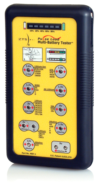

    Currently available "load testers" that I've become aware of due to reading CPF are the Ansmann Energy Check LCD and the ZTS Pulse Load tester.
    http://www.ansmann.de/cms/en/consumr...check-lcd.html
    http://www.ztsinc.com/index.html
    Fenix TA21 | Olight M20 Warrior | Eagletac P20A2 | Solarforce L2 | ITP A3 EOS Ti | Lumapower Vantage | LED Lenser Police Focus |
