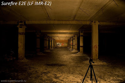

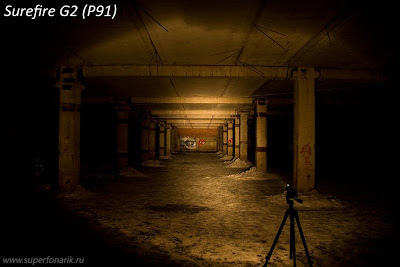

    Quote Originally Posted by knightrider View Post
    I will have to try it sometime, have heard it's frighteningly bright! Now that would be a great defensive light - they'd see spots for awhile!
    Certainly its bright! We had discuted it in the Suggestion for incan pocket rocket thread.
    There are some beamshots of this setup compared to P91.
    E2e + IMR-E2 + 2xIMR16340 = Pocket Wall of light!
    Cheers,
    Dioni
  12. #42

    Those beamshots are amazing! Really show what a small light can do. Come summer I think I'll pick up some IMRs and the lamp and give it a try.
    That has to be the most insane pocket rocket ever though. Must have...

    Thanks for posting that, those were the beamshots I was referring to in my earlier post. To me it looks like the IMR-E2 puts out more or similar overall light, while the P91 beam is a little tighter.
    Quote Originally Posted by Dioni View Post
    I'm guessing that the IMR-E2 on a pair of IMR16340's would get smoked vs. a P91 on a pair of IMR18500's though.
    ampdude
  16. #46
    Flashaholic* Dioni's Avatar
    Jan 2007
    Law Enforcement Front, Brazil
    1,363
    Default Re: Surefire E2E
    Quote Originally Posted by ampdude View Post
    I also think that the IMR-E2 puts out a similar overall. Obviously, the bigger reflector of the D26 drop ins can provides a better use of all light produced by bulb.
    We need some more comparisons of these bulbs...
