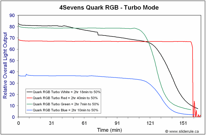

    So how do the individual colors compare for runtime? Below is the AW 17670 run:
    Despite the varying output levels detected by the lightbox, you'll note the very similar overall runtime for each of the four individual emitters on Turbo (i.e. they do indeed seem to be driven to comparable levels).
    Interestingly, the red LED runtime pattern on 3.7V Li-ion is a little different - very tight regulation followed by a quick drop off into a slow strobing mode (instead of into a low moon mode). I note in the Cree spec sheet that the forward voltage is much lower for the red LED compared to the other three, but I don't know if this has anything to do with it. I was able to manually switch the light into the Moonlight and Lo constant output modes in red at this point, so you are not stuck strobing when the battery is almost dead.
    Runtime patterns and output levels for the White LED look as I would have expected, on all battery types.

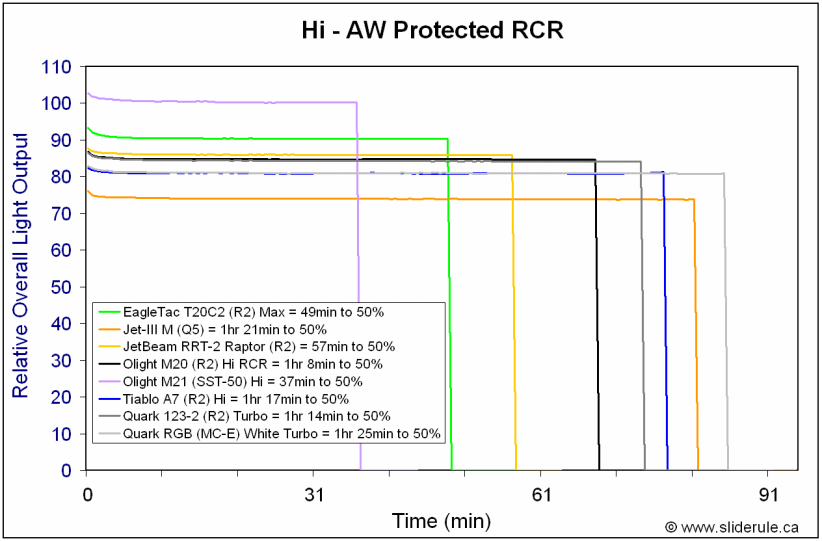

    Here's how it compares to the single-die competition:
    Again, no surprises here – for all intents and purposes, the RGB’s white emitter performs the same as the standard R2 emitter in the Quark Q123-2.
