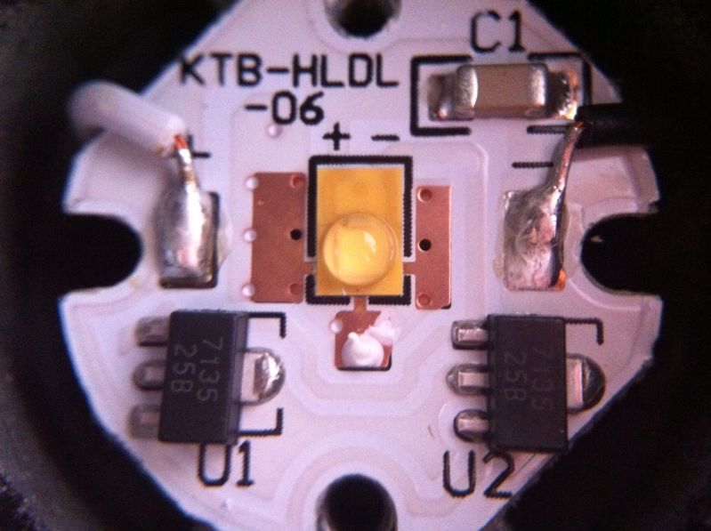

    I just bought two of those lamps for $9.99 each. It looks like they've changed the emitter to a warm white Luxeon Rebel LED and it's driven at 700mA. There's a clear plastic lens retaining ring that clips on holding a small lens. The white plastic "reflector" holds it all together. Under the reflectors is a pair of AMC7135 chips and what appears to be a SMD resistor.
    I originally planned on swapping the LED or even making a new head for it altogether, but, I might just leave it alone or swap out the reflector/lens for an optic. The Carclo 10003 20mm optic looks like it'll fit with a minimum of mods to this light and will give me a better beam. I could always swap the emitter for a cooler white emitter from one of my Rebel Mag LEDs for more output, too.
    Flashaholic* srfreddy's Avatar
    Sep 2010
    New England
    918
    Default Re: Quality LED desk lights?
    Quote Originally Posted by PCC View Post
    You could piggyback two more 7135's on top for 1.4 a to the rebel, not sure about heatsinking though. Maybe just one 7135.

    It gets warm with the 700mA that it's getting now. It's dark now so I'm going to see how it works. I've installed one right onto my lathe to light up what I'm working on and the other is on my nightstand. The optic was installed onto the one on the lathe and I had to put a bit of diffusing film on it to both spread and smooth out the beam.
