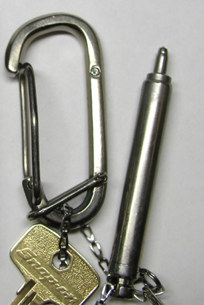

    I started a post that was somewhat critical of this Maratac clip when this thread first started but upon evaluating the expected intended usage of the clip, I found I was being unreasonable and any comments from me would be likely suspect anyway.
    The Wichard is the original and all of Wichard's hardware is about working hardware where the design and construction is focused on performance and strength. Wichard forges their clips which puts them in a different category completely from any of the cast copies. To evaluate this Maratac clip based on Wichard's design criteria or that of a piece of hardware designed as a load bearing part would find it seriously lacking for some fairly obvious reasons but in terms of a key clip or other low load device clip it seems to be well thought out and it certainly has a mirror finish!
    Any of these gate clips can provide great utility provided one evaluates the application. Since the gate does not lock, one needs to confirm that the application is not one where an unintended gate capsize and release of the clip could occur.
    I have used the Wichard's for years and when I was finally in a position to suggest the consideration for a smaller version more as a gear clip, I did so. I was employed by Suncor at the time and pushed for a mini clip to be made which it was. After leaving Suncor, I felt there was even call for a range of smaller clips and through a company I had come to know in the industry, I was able to get a series of these done.
    The tortion gate is simply a marvel in simplicity and function. Who ever invented it originally is my hero!
    There are all kinds of clips and devices now that use this tortion gate and some with great success and based on a good design and some that fail miserably.
    The very crude and odd looking titanium key chain clip pictured below is one I made probably 15 years ago and it is still in constant service today. It may still be the only titanium clip on the planet with a pair of diamonds set in it.
    As a standard, it makes almost all of the clips now available look good but in terms of actual function, it holds its own.
    A properly functioning gate is not trivial and and I have encountered a number of clips and designs over the years that fall short in this aspect. The only way to know if a gate works well is to try one. You can't tell from a picture unfortunately.
    If this Maratac clip has a good gate action then it is a nice clip for its apparent, intended applications.
